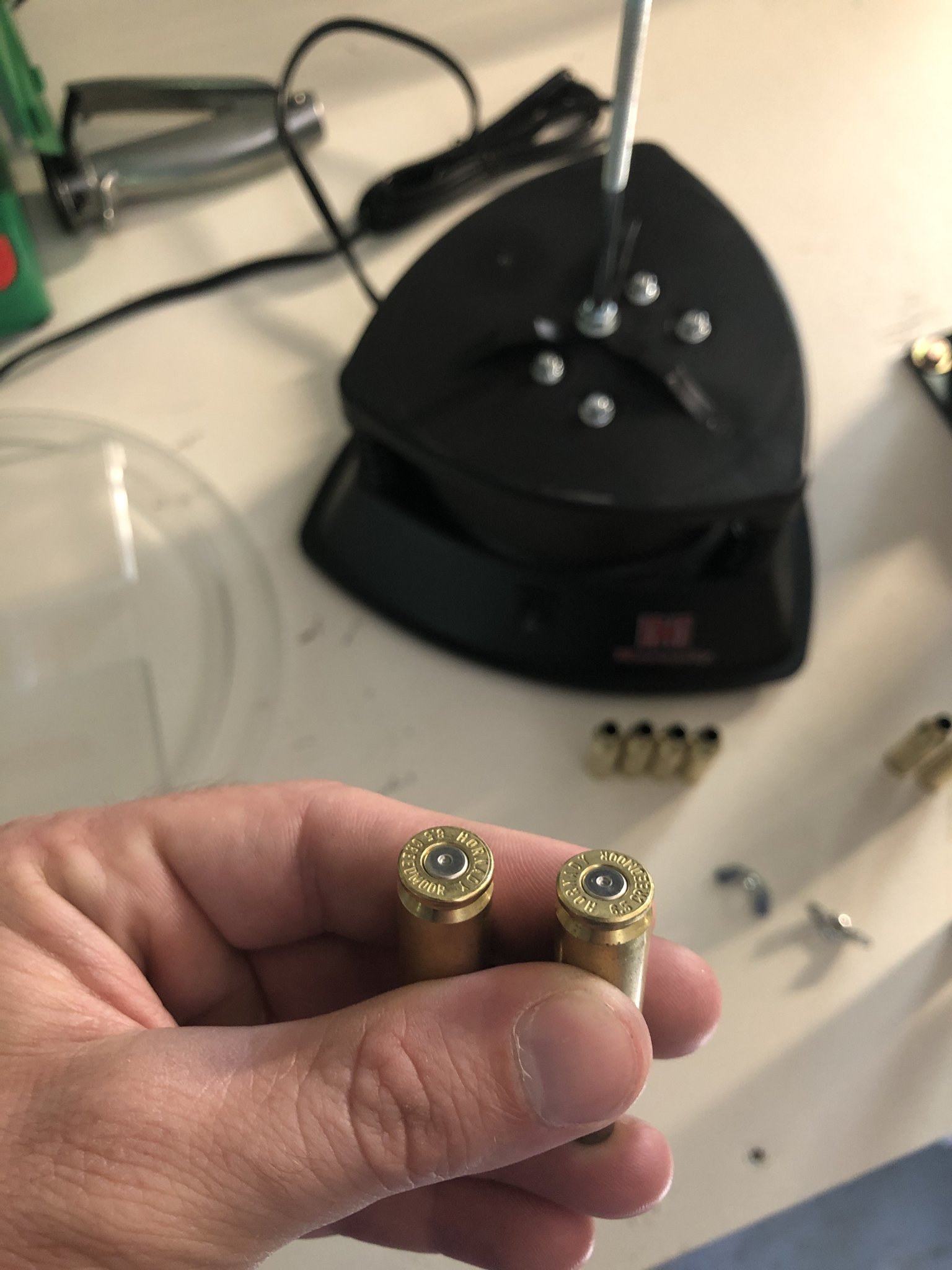

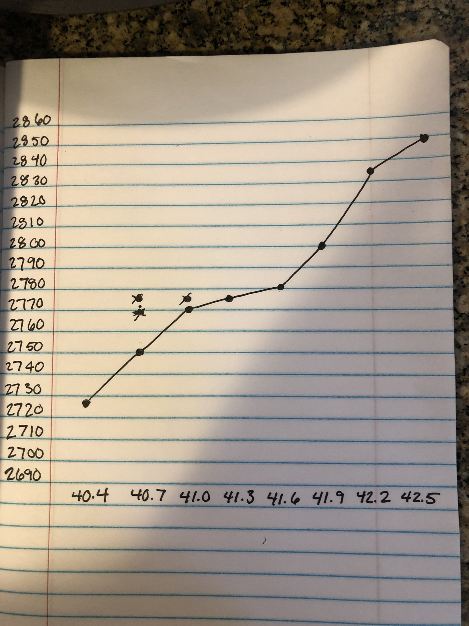

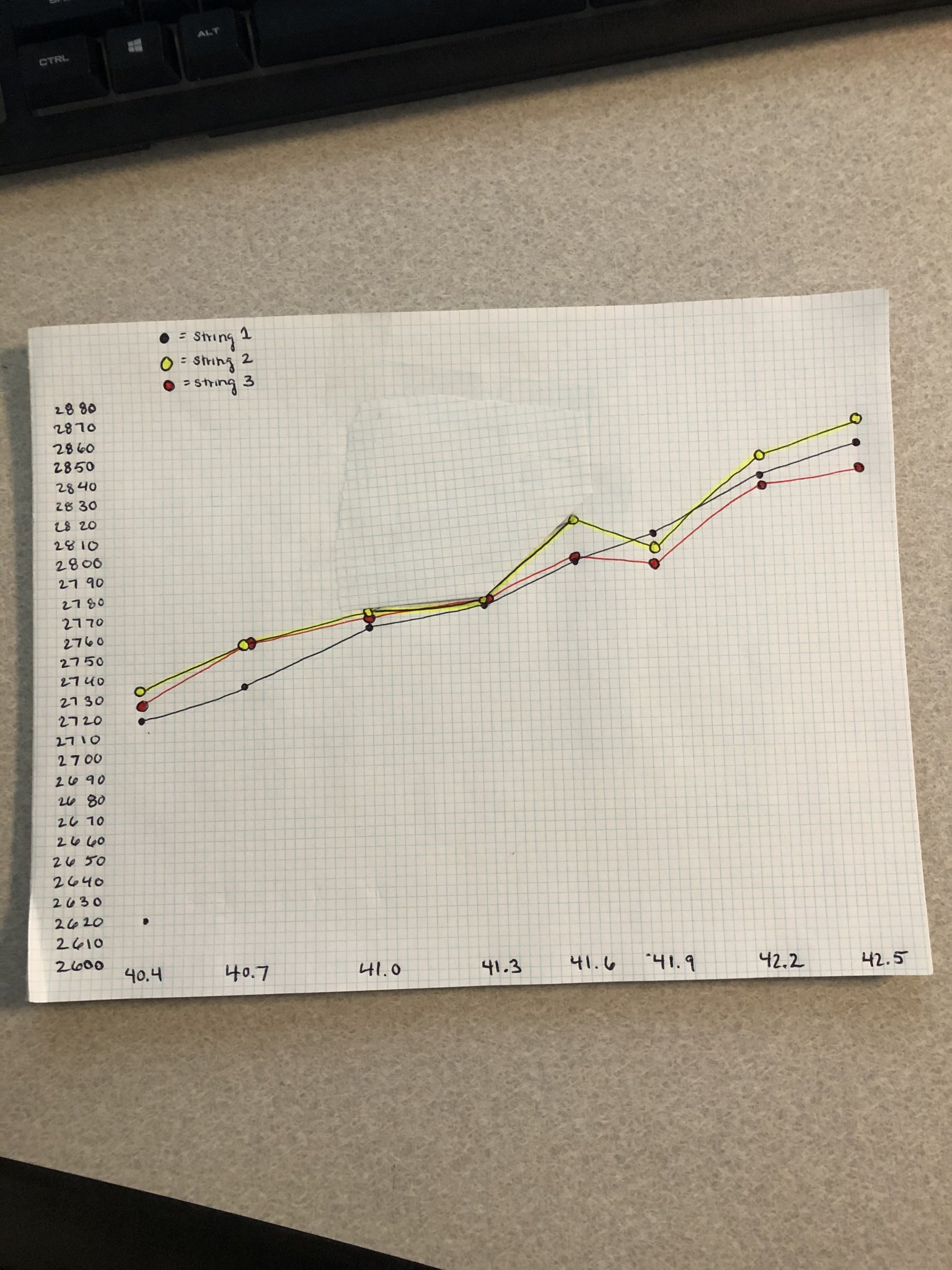

Thoughts? Case pic is the lowest charge on the left and the highest on the right. Bighorn TL3 Action so it leaves that crater around the firing pin dent all the time. Never felt a difference in bolt lift. Avg graph tells me 41.3g but the separate string graph is looking like 41.1-41.2. Anyone else see anything different or suggestions to what else I should test? I’m thinking I’ll do another ladder from 41.0 to 41.6 in .2 increments and 5 rd groups just to fine tune it and have a better sample size. Targets shot at 100 yds.

I do think more data points give you the best results with one thing at a time. Too many error inducing variables gets things all jumbled up. Case in point the chronograph shows a definite node around 41-41.3, if you look at the paper target you would not go with 41-41.3 because the POI is quite different.
That's exactly what I would do, and I would then lock it down in the middle of the node.
