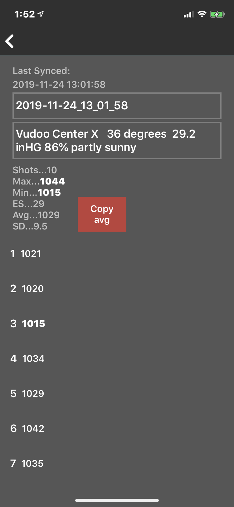

Looks like this thread is either dormant or comatose. So I'll add a post just to de-fibrillate it. I did a chrono on Center X and CCI SV last week and was a little surprised at the results.
Center X has velocity of 1073 as posted by the manufacturer and that's what I was using in Strelok Pro. The chronograph showed an average of 1006 on a sample size of 20. The SD of 15.53 and ES 55.1 For CCI SV I had an average velocity of 1045, SD of 14.27 and ES of 49.
What surprised me was the ES and difference in velocity compared to manufacturer claims.
I plugged in the Center X velocity of 1006 to Strelok and found the calculations to really close to actual ( I also changed from a G1 BC curve to RA 4 curve).
Now I'm wondering about other ammos and how they might compare. I've got a couple of other CCI flavors, SK Std +, Aguila Match, SK Flat Nose, and some Norma Match that I'm going to chrono and see what those look like.
Like everybody, I'm looking for the Holy Grail of 22LR ammo - you know, the one with an ES of less than 10.
Also, just as more info - I did this at an altitude of 5,100 feet and ~ 45 deg F.

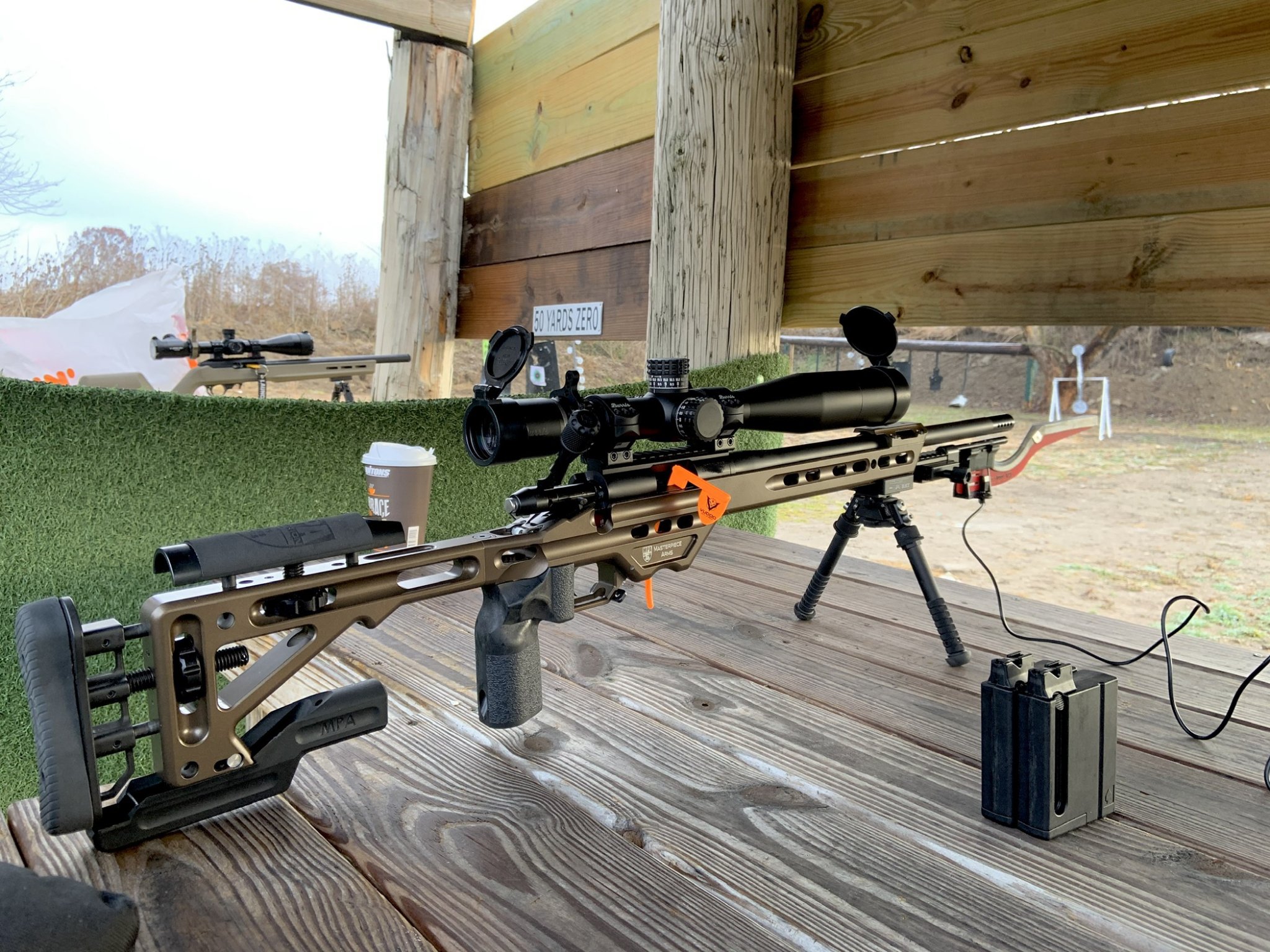

OK ive got one for you all.
Does anyone else get velocity changes like these ?
Magnetospeed V3 and Eley Match. Sig Sauer 200 STR

I’m using the MPA Magnetospeed Mount on my chassis. It has picked up every shot. I have the sensitivity set at 7
This is 10 shots of Center X recorded right before the start of a match
