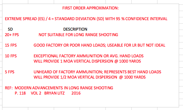

I would recommend first getting a device that gives you accurate muzzle velocity data before atmospherics.
Even if you don't handload, knowing which mfg. provides the best performance cartridge for your rifle by accurately documenting their individual muzzle velocities will pay greater dividends for target accuracy.

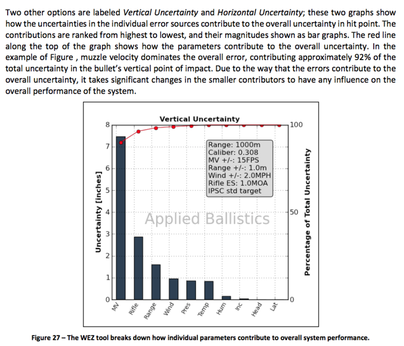

In the bar graph, note the overwhelming influence muzzle velocity has on vertical certainty on probability of hits v. wind speed error. Obviously, the goal is to know how to minimize the uncertainties in both these deterministic variables. Notice the very small influence wind knowledge has on vertical performance; admittedly, horizontal performance is quite another.
Ref: Applied Ballistics Analytics User Manual, Build 057 Screen Shot 2017-09-14 at 5.18.51 PM.png

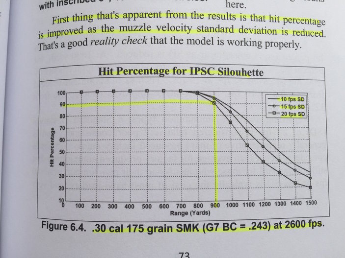

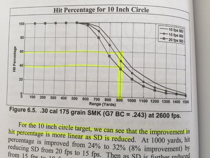

More objective rationale for selecting an accurate chronograph.
Bryan Litz documents the important role of knowing and reducing your muzzle velocity standard deviation on increasing target hit percentage.
Ref: Accuracy & Precision For Long Range Shooting, pp. 73-74

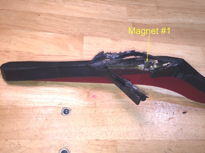

On the other hand, my Kestrel came home in one piece yesterday whereas my MS3 had an .308 autopsy.
