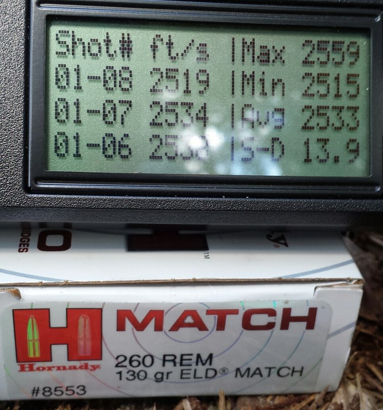

    An update on my 20" CTR .260 Rem:
    MSV3 crony
    88deg.F
    2200DA
    Hornady 130ELDM 10rds:
    13.9SD
    44ES
    130 Prime 10rds:
    6.7SD
    21ES
    Very excited about the Prime ammo! This is only a sample of 10, but the first 8rds held an SD of 4! Velocity is on par as well. From the first round to the 118th round I gained 54fps with the Hornady ammo. Not sure if the barrel has settled down or not, but will continue monitoring.

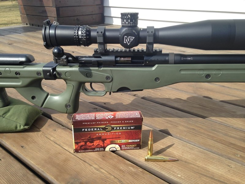

    Federal GMM in 308 Winchester 185 Berger Juggernaut
    20" factory barrel on a AIAE Mk III
    Same chronograph set up as above
    70 degrees F 29.94 BP 852' MSL
    2523
    2551
    2540
    2541
    2543
    Average: 2539
    ES: 28
    SD: 9
    Those are good numbers on the Juggs from a 20" barrel. I almost got the same speed from the FGMM 142s in .260 from a 20" barrel. Even though that is about 200 fps less than I get from my 26" barrel, the 142s fly really well and buck the wind great.
    The Juggs shot lights out to 800 yards, but then the wheels fell off at 1K. I attributed this to the 1:12 twist and extremely low DA's here in the dead of winter. The most accurate factory load I've ever run through this gun. Consistent in the .3's
