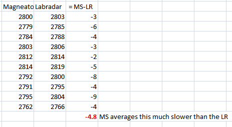

And since labradar wasnt a thing when the AB test was conducted; here is a brief trial I did between the MSv3 and the LR. Both the MSv3 and the LR read very close to one another.
7039105
