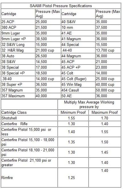

CIP is more generous in some cases, less so in others. Looking at QL sometimes they spec the same pressure or one may be a bit higher than the other.
Examples:
.44 Magnum CIP 40k SAAMI 36k
And one going the other way
.45 ACP CIP 18k SAAMI 21k

The difference is that SAAMI is the standard for this side of the ocean, and CIP is the standard for Europe. They each have their own OAL/maximum pressure guidelines and methods for measuring pressure and in some cartridges the difference is significant. One major difference has already been pointed out in this thread too. CIP REQUIRES a proof load that is a set % over maximum for that caliber is fired through a firearm before it is marked as such.
Re: CIP VS SAAMI
The SAAMI proof tests give a range of % ratios.
