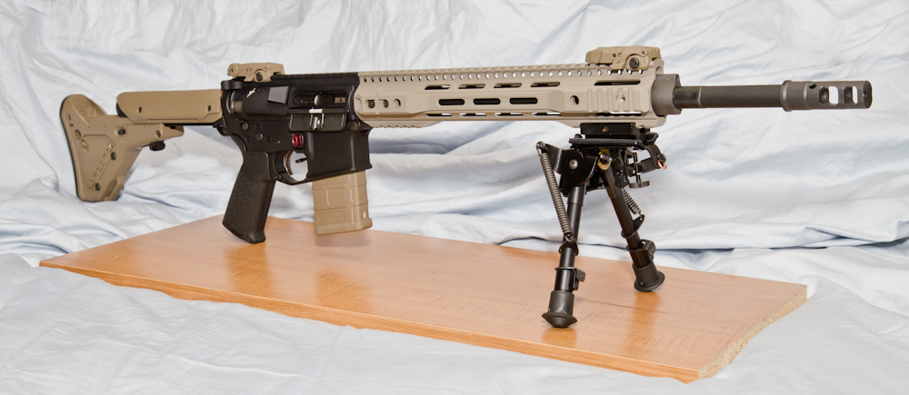

since you have a pxt rail, check out there low profile adjustable gas block. It is not listed on their website, but you can contact them and they probably still have some. They are the set screw variety, lightweight and it fit under a very slim handguard on a build I just finished. The reason I went with it, besides being able to fit under slim handguards, was the adjustment screw is in the front of the block and easily accessible (I run a folding front sight on the free float rail). bought mine off ebay actually, was the only place that had them in stock at the time, but here is a picture on the aim surplus site (sold out also):
