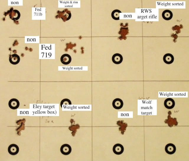

I just put a Shilen .920 on my 77/22 and ran a quick test this weekend.
I went to my local gun shop and purchased every thing they had that was match quality. I decided to test 10 unsorted
and then weigh the remaining 40 and use the most consistent 10 out of each box of 50, so each group is 10 shots at 50 yards.
Target bulls measure .5" across, .25 across the white.
Im thinking wolf looked the most consistent...

0 or 10 depending on how you look at it...
