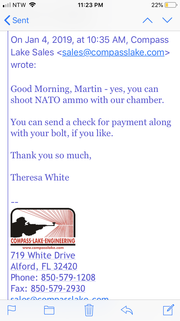

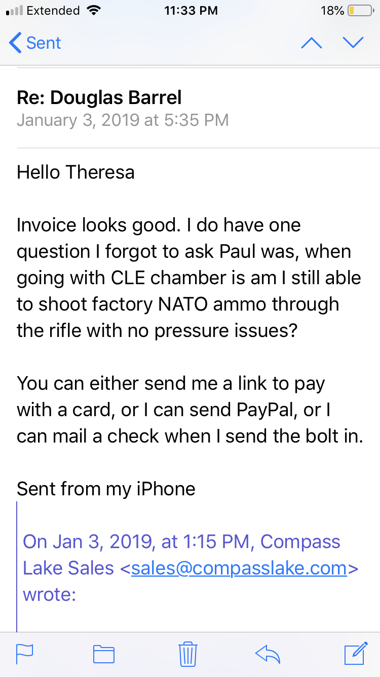

Well this is new. When I ordered my Douglas from them in January, Paul at CLE advised me I could shoot either 5.56 or .223 threw my CLE chamber. I also remember an email from Theresa saying it was also ok for 5.56 ammo.

I would give them a call on Monday or send another email for more clarification. If you can get confirmation that the CLE match chamber is NOT specifically designed for .223 I will be happy to admit that I'm wrong, but I don't think I am.
And I do remember talking to Paul a second time and asking him the same question.
I've personally had over 20 barrels made for me over the years by Frank, and I have not once been told it's ok to shoot NATO ammo from the CLE Match Chamber.
Because the Wylde chamber is essentially the closest you're going to get to a" 5.56 Match Chamber".
This to me is very odd, and according to the above emails I AM WRONG but it still feels like something's amiss.
I wish padam was hanging around somewhere he might know more than both of us, either way I'm personally going to email CLE Monday and get clarification because this is quite interesting.
Well to be honest I’m just using what I’ve been told. It’s the whole reason I went CLE chamber. And the barrel is still sitting in the damn box from CLE. Not yet mounted. I was going to send it back to CLE for a thread job after I bought my suppressor but time and work got in the way. I will also speak with them before I send it in and if I was told the wrong info maybe they will rechamber it for me.
