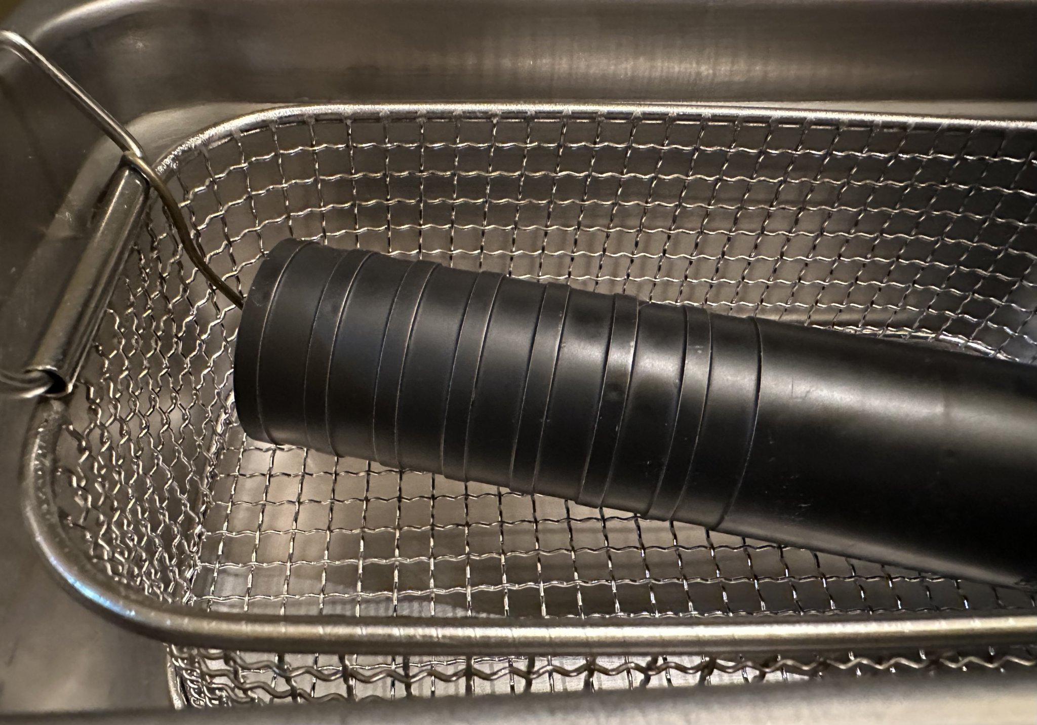

I hung mine in the basket like a rotisserie style setup with a metal coat hanger to keep it suspended off the bottom of the basket. And made sure to put enough mix in there to where the top was covered about 1/2".

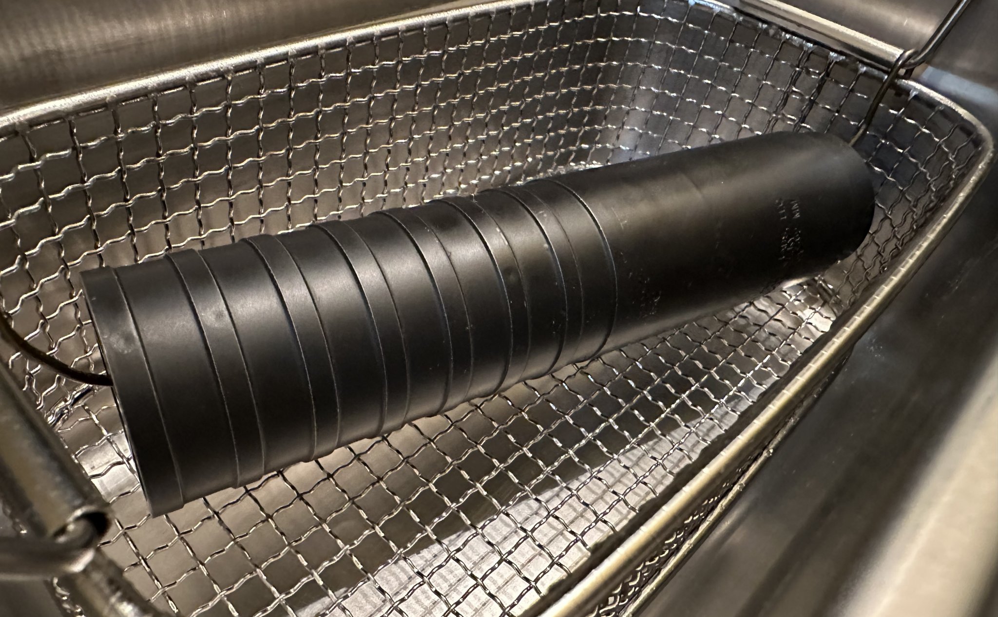

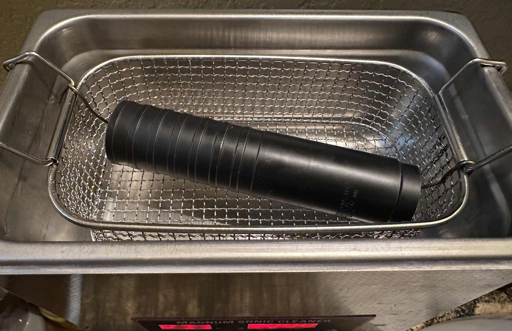

View attachment 8257420View attachment 8257421View attachment 8257422
What ultrasonic cleaner machine are you using?
They haven't made it in years... It's a Hornady Magnum 3-Liter machine. I bought it almost 15 years ago, and it's been a great machine.
