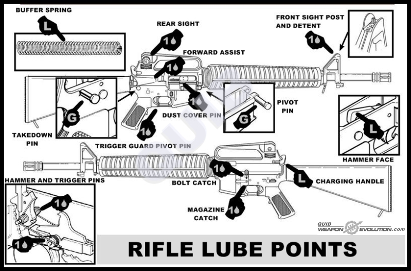

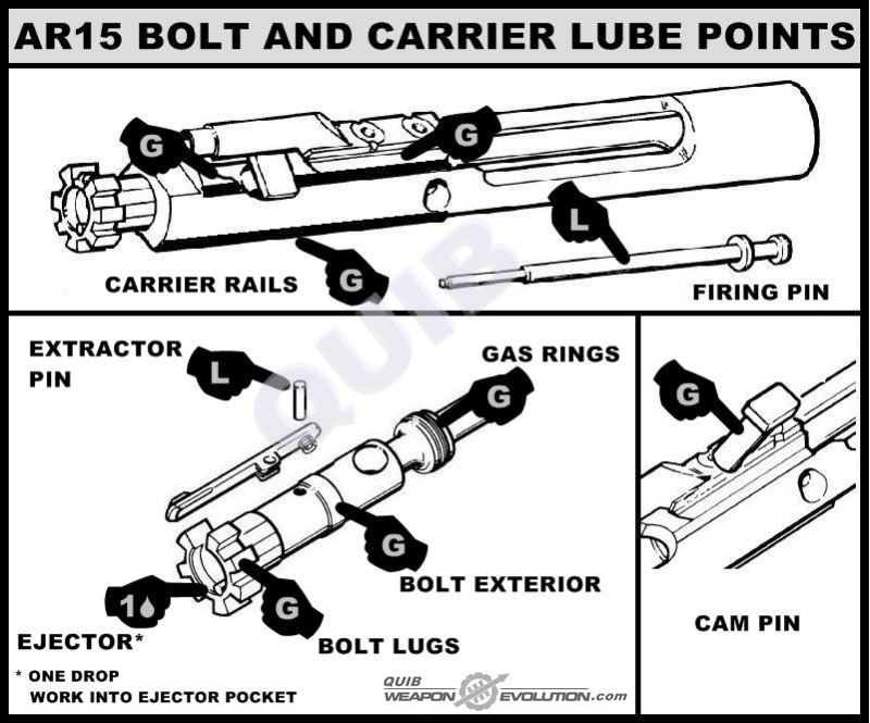

Here are some helpful diagrams for the new AR owner.
