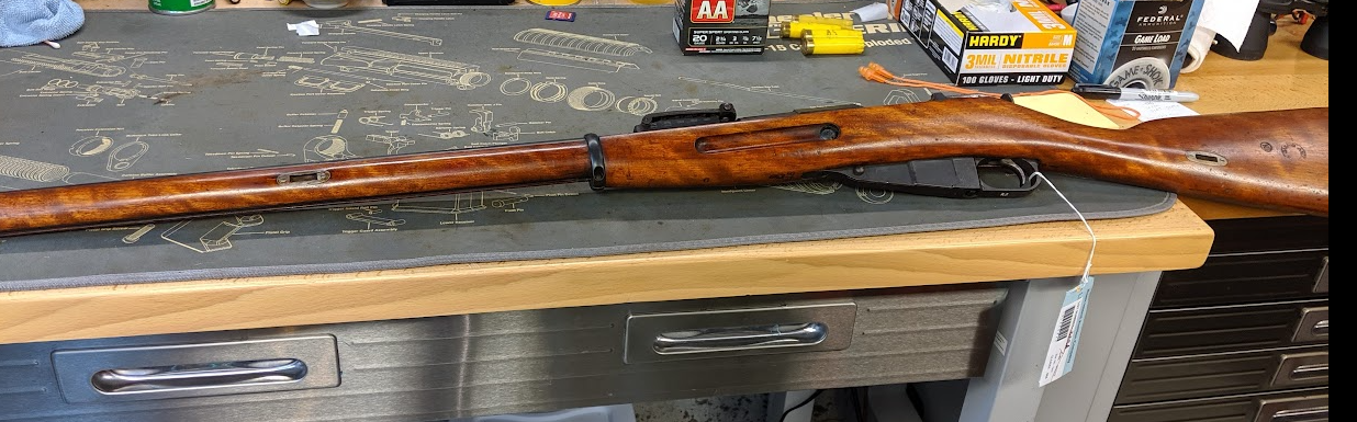

The round in question was 7.62x54R. You folk know I like old things.
I don't really give loads on the internet but lets say it was on the softer side and was using a well respected powder, and a load I had been using FOREVER. Reason I am being shy around the powder is here at work I am not sure I remember correctly, N130 or N150. I just don't remember off the top of my head.
I had a few weeks off, that was nice, and one of the things on the table was doin some shootin. So I did. I got quite a few things dirty, some things I had not shot in decades. Made me really ask myself, why don't you do this more often, it is kind of fun. More on that in another thread.
But the rounds are loaded in 2022, stored in the "usual" little plastic box of your color choice, in a cabinet in the basement. Just like every other one in that same box.
This happened with about 6 rounds left in the box, and really made me think for a sec if I wanted to finish out the box. I stopped short, and still not sure if I will pull the others down. Looking on views on that. 45 rounds-ish in that box shot just fine, but this one, not so much.

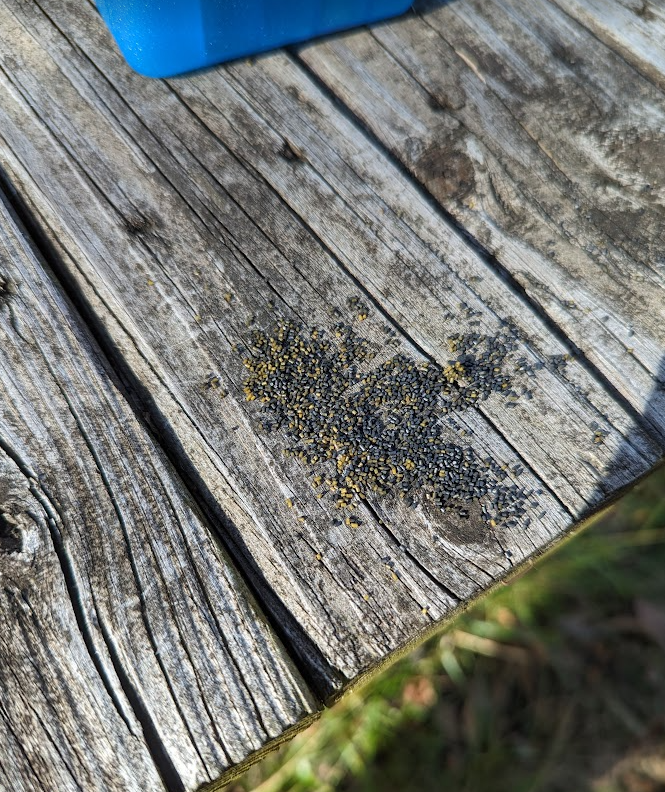

Click no bang....hmm. Give it a few sec, then open up the gun 91/30 sniper wanna be. I got it from SOG years ago at the height of the "fake sniper" craze. Everyone wanted to play Enemy at the Gates, and why not. Cheap rifle and Rachel Weisz, nice butt.
I had a pic of the card, but will blurr out the info.
You likely know the card, but a few things, the 2.791 is COAL, and primer is "old" CCI primers I had laying around in reserve...nothing special, just old packaging I got at a gun show. At the time LRP are still a bit hard to find.

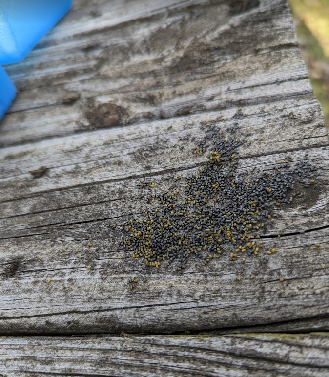

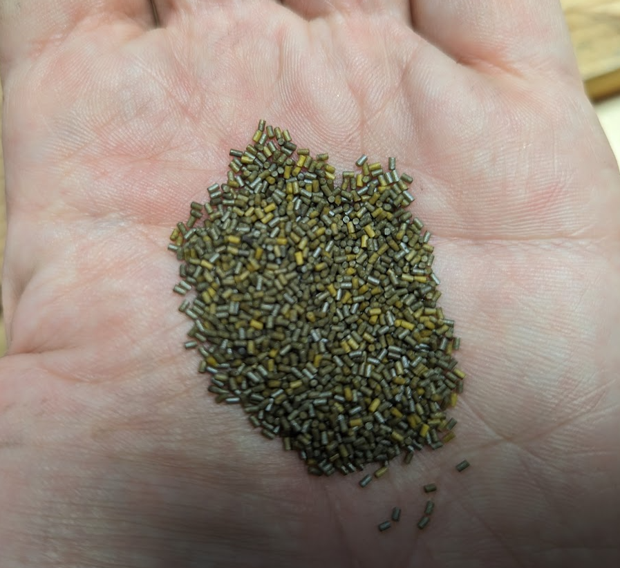

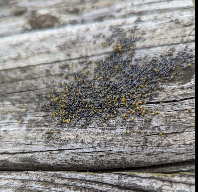

A couple photos of the powder, you can tell something happened somewhere. I just found it odd.

Incomplete ignition cycle. The discolored power was hit by the primer but never started to burn. Which makes sense, with the other rounds feeling and sounding soft.
AFAIK, Could either be caused by weak primers or insufficient powder with not enough case fill or pressure to burn. Either way, watch for squibs. A good primer can push a bullet into the rifling in a case with no powder.

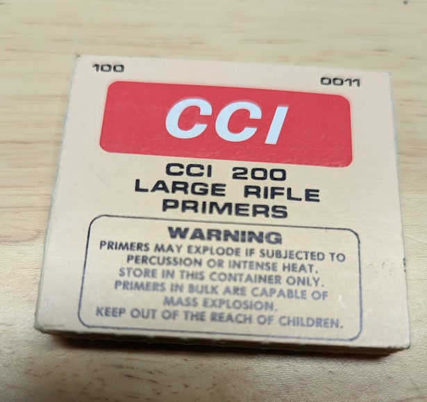

I am wondering with your comment on weak primers, and these being the "old" primers if one just did not have the "stuff" to do its job.
I had used this load in all the 54R stuff going back years. It was liked in the "weak" SVT and ran in the PSL so I just ran with it. All shot this exact length just fine...or fine enough for these old girls.
The primers I did not buy new, but gifted to me that I just tucked away for a rainy day. I did have dividers in the box saying new and old primers, and for the life of me can't remember where the new started and the old left off. I am betting that can be it.
By the powder left both in the case and in the rifle I don't think one grain burned. I did not look good at the primer, I just can't see that well into that long case. I tried to grab it when I popped it out, but all its parts came apart so there is really no telling if it did actually "pop".

The powder discoloration shows that the primer did fire, but did not ignite the powder.

With it being an "old" primer I think that might be where I am going to go. I could be dead wrong, but it is the only thing that would explain the other 40 something working just like they always had.

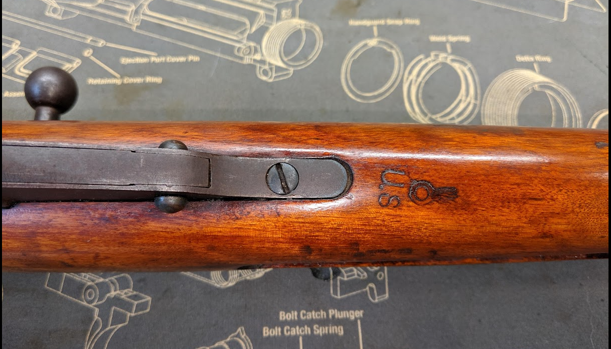

I have several copies of the same rifle, including the Russian stuff. I say Russian because some of it is pre commie stuff.
The russian stuff I don't have boxes for just that rifle like I do with other things, I had not really thought about it why not, but I don't. I even have different boxes for Carcano, but not anything that is 54R. Like a box with 1234 on it, and those are the last 4 of the sn# of the rifle those go with, same with VAR on the box, various rifles. I don't have that with the russian stuff. Box just says 54R so I can see it at a quick look.

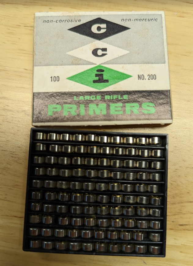

I don't really know how old they are but I did post up the package here a while back, and was contacted and asked permission to use the photo from someone. I bet I still have the PM.
Weather is starting to turn here tho, and I find it no fun shooting in the cold, so it might be till spring. I might load them up this weekend if I am not fooling with the VW again all weekend.
In looking for that above photo I found a photo of the primers. Now what one of these two packages I used, I don't know I did not make a note that deep. Again perhaps another thing i should do when using older stuff.
They did look fine, and did not smell funny like powder is suppose to smell when it turns.

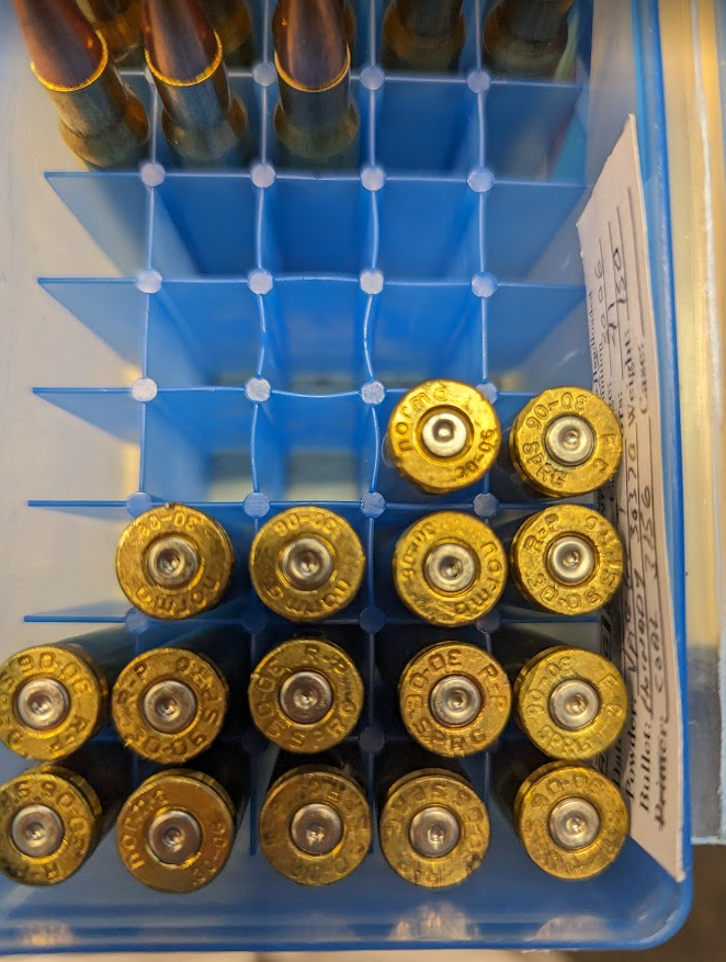

I have been reloading for over 20 years and have never had this issue before. This time same as above but this time with 3006. I did not make a note of the powder, but I have the same odd discoloring as I had with the 54R.
I have not changed anything, and these 3006 got loaded roughly 6 months ago.
So odd I am getting colors like this, smells funky as well. Only one in the 20 did this. This time the primer did not even pop, flat dead. Had to wait till back at the house to pull the bullet.
I do crimp them so I don't think anything could be getting in there. Just strange.
Let’s see the primer from the case that didn’t go off.
Likely that either you’re still not getting ignition from case fill, or there’s some moisture or contamination.
I still have it in the case. I will try to take a photo of it when I get home.
Reactions: TheOfficeT-Rex
If able, lets see one of the firing pin indent while it's still in the case, then decap it and show us the anvil side and the priming compound.
I did not remember yesterday, but when I went to take the photo I did remember. I had already pulled the round down and the case is in the box with all the others. So I am not sure what one it is.
Some of them do look a little funny in the photo, and when I saw the picture I went back downstairs to see if any where proud. They are all seated even with the bottom of the case so it must be the way the photo is taken.
Some sure do look funny however, that first one on the second row looks odd, but I am not sure it was the offender.
When you pop them out I’ll bet you find they’re all properly fired primers.

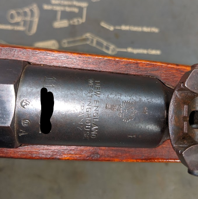

The rifle is an '03 Springfield with a 1918 dated barrel in the 500k SN# range if you need that info as well. Yes one of the dreaded "low number" springfields, that will blow half the planet up if you look at it sideways.

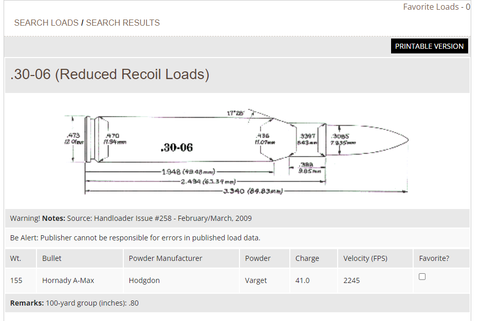

You're below the Hornady 10th manual STARTING load for varget (listed from 44.9). Hodgdon lists different bullets at 150gn, but starting loads of 46 and 47 gn of varget. The Berger manual is similar.
GRT generic inputs put load density at 72% and low burn error codes. Just like the loads you started the thread with, you cant just download the case fill then bitch that they don't light.

I did check that load last night, I have a couple three books, they ranged from 44 to 44.9 as a starting load for a 150 grain bullet of various types. The Sierra manual had 44.9, the old lyman had 44, I think the other had 44.5.
I generally check a few different sources and go with the lowest number for starters. Being a little sensitive to recoil I want them to be as soft as possible.
I came across some "youth" loads that had them in the high 30's, but did not find that till I already had these made up.

The odd powder color is from the primer igniting but not setting off the powder charge. This is very common when using SRP in cold climates.
I'll take a stab at the issue. This is multiple factors contributing to hangfires. You have a light charge/low case fill, old/weak primers, lower ambient temps, and the powder biased to the front of the cartridge (powder slides forward every time your fire). Your load on it's face isn't dangerous but the combination of factors are causing random ignition. It probably goes away when it's hot outside or you tip the gun back between rounds. You can test this by either using magnum primers or adding a couple of grains of powder. You're encountering the same issue in 54R because it has roughly the same case volume as 30-06 and you're using the same light load approach.
Thanks for that, I learned quite a bit in your post.
With what you say it is sounding right. I did not notice this last summer in the 3006, the 54R is a new recipe for me.
It could very well be the older primers, that is also new across the board.

I’m not here to yuck your yum, but without moving to trailboss/tinstar/H4895 reduced loads you’re setting yourself up to chase issues- as you’re seeing now on two rifles. GLHF.
4895 in all flavors will have worse fill percentage, pressure to pressure. The recoil would probably feel pretty similar but ignition may be worse, all things being equal. 44gr of Varget and 44gr of 4895 all hover around too little pressure. 52gr of H4350 would bring the load up to 40kPSI, 100fps more velocity, and 97% fill. Or try magnum primers.
Reactions: lash
I have no personal experience with reduced 4895 loads, but was referencing this paper from Hodgdon.
Like wildcats, the further off-piste you go, the more troubleshooting you're forced to do yourself.
Hodgdon might beg to differ on the suitability of H4895 for reduced loads…

I have never used H but have used IMR quite a bit.
It just seems like IMR is just more available, I think I remember Hodgden distributing IMR as well, I want to say it is an Oz company, but not sure.
Varget and IMR 4895 in old "full power" military cartridges crosses a great many boxes. You can find a published load for about anything in one of those two powders.
I loaded up some more 54R this week, but this time using new primers. If it stays nice today I might give those a run and see how they do. I do want to run them in a few other rifles.
I have an almost too pretty to shoot US marked Westinghouse I have had for a while and never shot. Gun looks like it was made yesterday. I think today might be the day.
