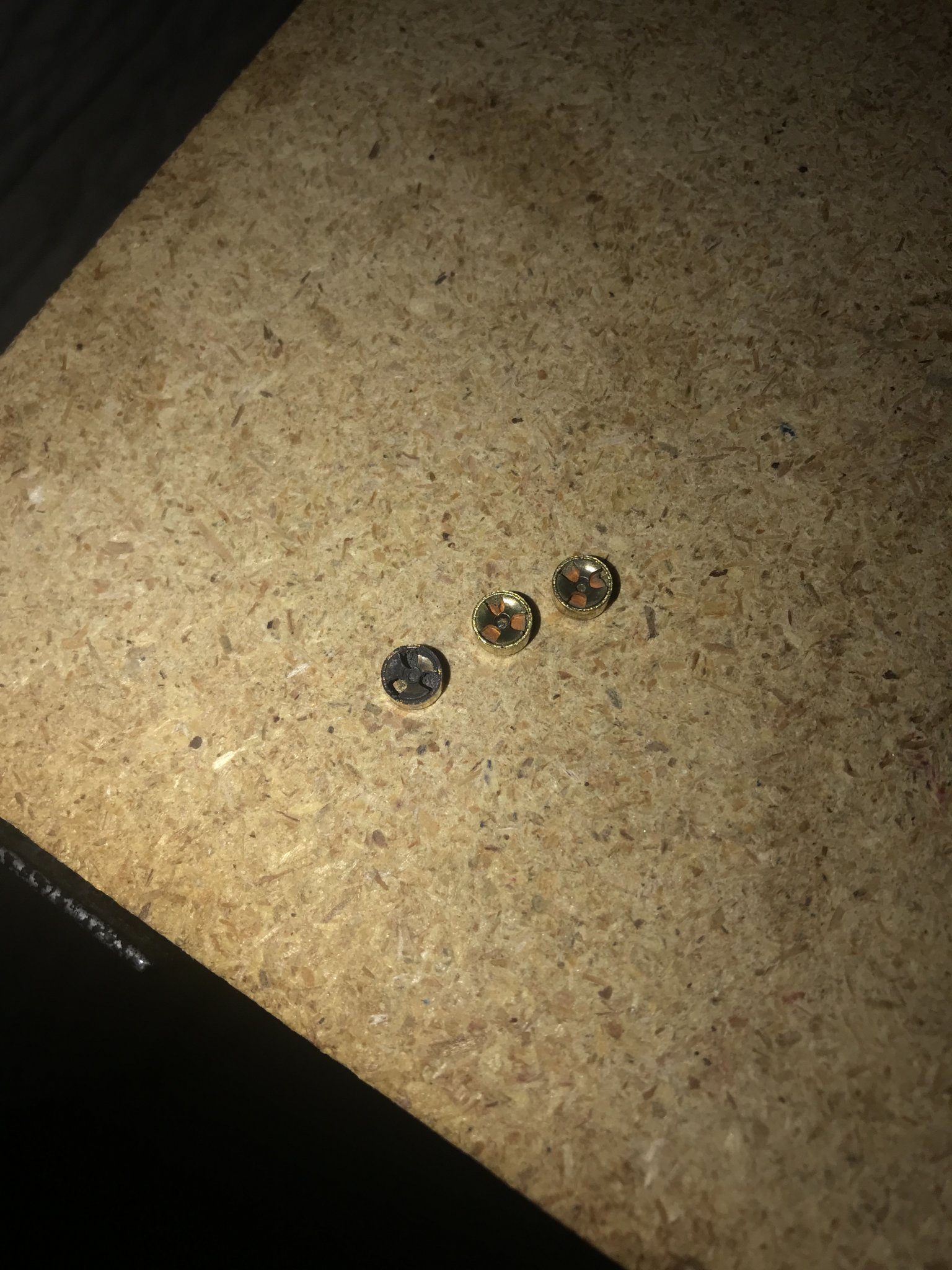

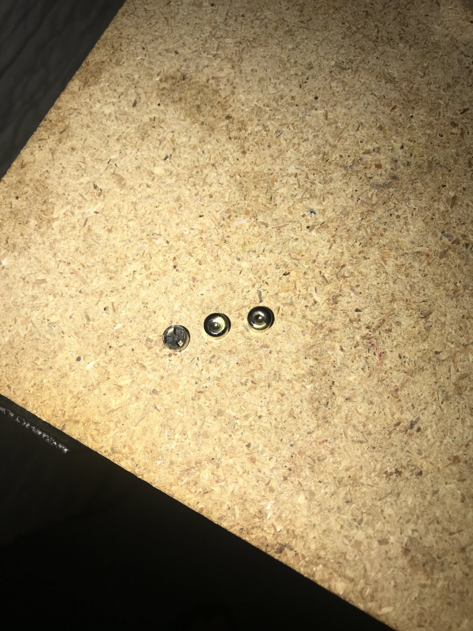

I didn't clean my brass with an ultrasonic cleaner and no moisture/water got into them (I made the ammo about 2 days before shooting it). Below are pictures of the two primers with a primer that successfully detonated for reference. To me it looks like the edges of the two primers have some scorching but they didn't go off all the way. The marks on the back don't look like light strikes to me. They are Remington 9 1/2 Large Rifle primers.
Anyway, I am wondering if anyone has any idea why this happened. The only thing I have been doing different recently (although I've had several range sessions using this method without incident) was switching from using my Lee F/L sizing die with expander ball to removing the expander ball and using an expander mandrel after running the brass through the F/L sizing die. Could this have perhaps made my brass slightly shorter resulting in more head space and a less solid hit on the brass? I just find it hard to believe that it could be the primers themselves that were to blame.

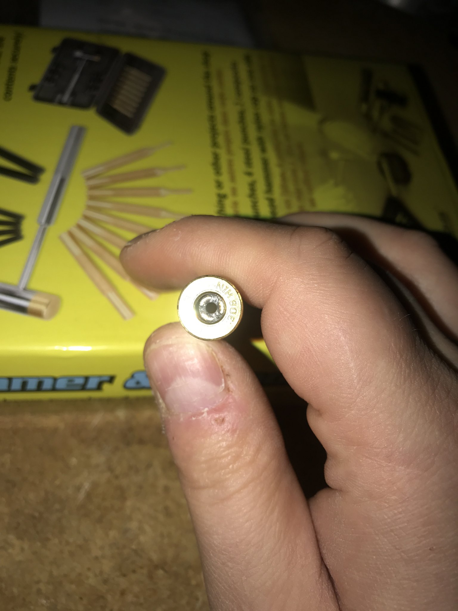

Can we see a picture of the firing pin strike in the primer that didnt fire?
There should be a picture in the original post. I show the strikes on the two that didn't fire. They look pretty solid to me.

Anvil looks compressed from the pics. I had one round like this not long ago. I chalked it up to a bad primer. The cup was very deformed from the firing pin, after I popped the primer I set it on the floor and hit with a hammer and it still didn't go off.

Sure looks like those primers were well struck and have a nice indentation. to me this also means that the energy of the strike went into the primer rather than being absorbed by pushing a high prime inward in the case.

And your pics disprove the blocked flash hole theory--those primers never ignited. From what I've seen, primers are powerful enough to blow anything out of a flash hole short of maybe a broken off drill bit or something similar.

Yes, I think you're right. Even if the flash-hole was blocked, I think it would get unblocked in a hurry. Also, the primers clearly didn't go off, so a blocked flash-hole wasn't the culprit. I think either the primers got damaged/contaminated somehow or they were duds from the manufacturer.
