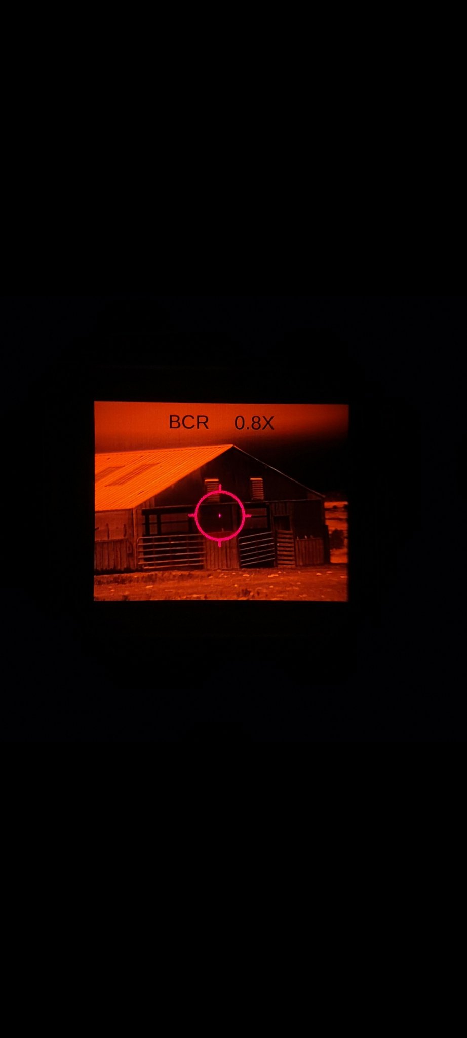

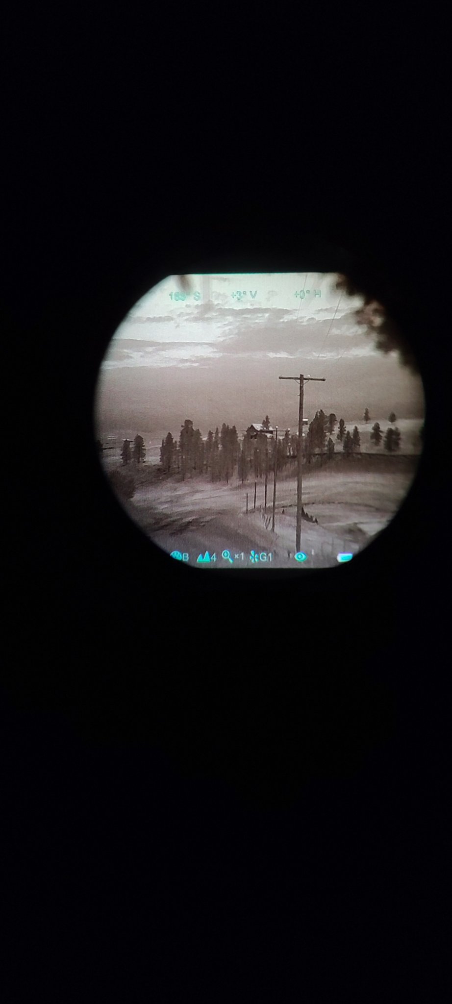

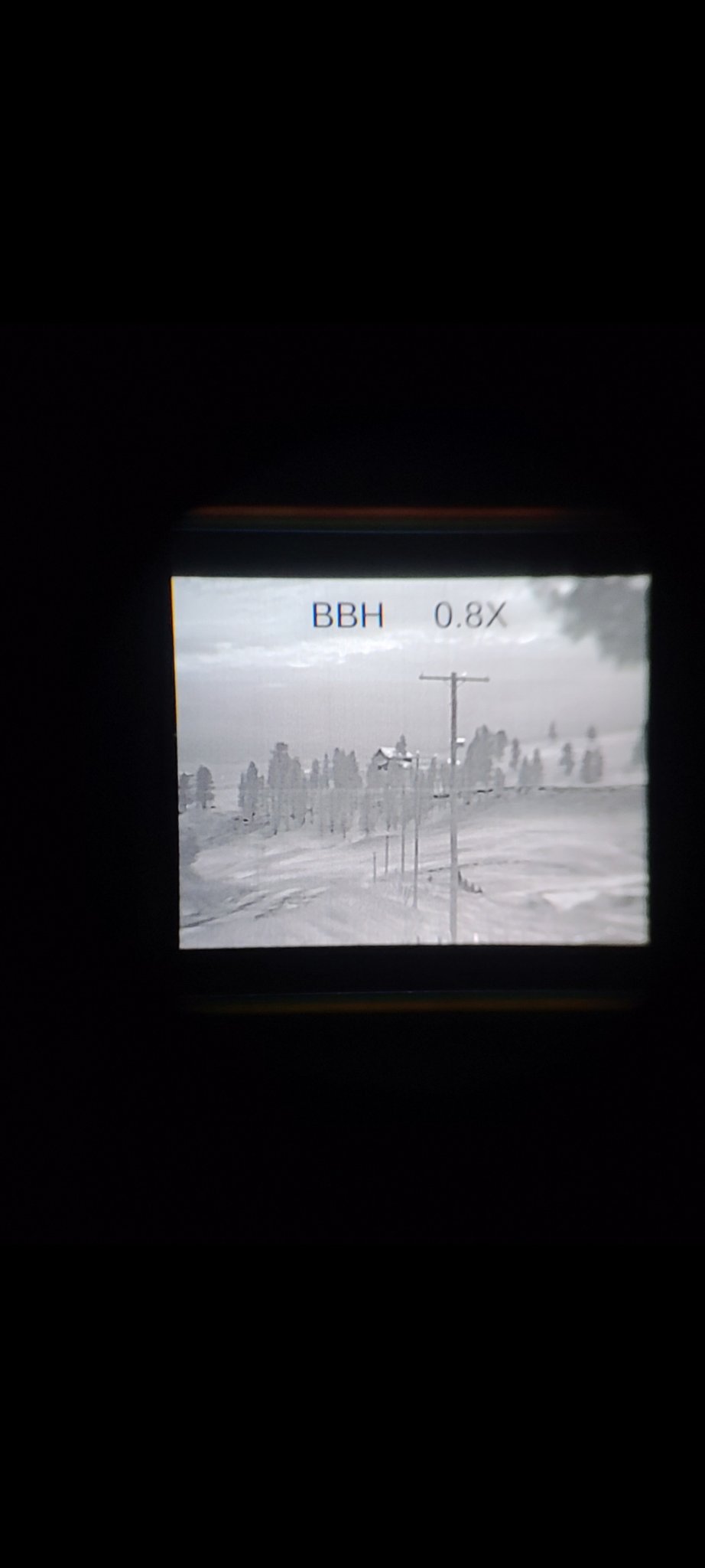

Wig does it seem like to you that the OLED Farbdisplay 873×500 Pixel is one of the limiting factors of the TigIR as far as being able to effectively go beyond 4.5x on the day scope.
That pixel density is actually higher than UTC Xii (which is a 640x480 OLED display). The main limiting factor is the lack of manual focus on the objective housing and issue with parallex on the eye piece. What happens is, when you increase magnification and look further out than 200 yards....the image get real blurry REALLY quickly. With the UTC Xii/X, you can have a very fine focus that will persist at well over 10x optical on your day scope.
The TigIR to me (I've owned one then sold it after finding out the image issues at distance myself), is a great optic to use on fixed lower powered scopes within 200 yards (best was with a 3x G33 magnifier/EOTech combo)....but that's it. Taking it out further than that decreases your PID exponentially....even the Super Yoter C whooped it's azz at PID at distance.
To demonstrate, here's a photo of a house well over 1000 yards away. One image with was taken with the Tig and the other with the Super yoter C. You tell me which on looks better. Both photos used the G33 3x magnifier. Below there Is also a picture with the Tig in a red color pallet at close range using an EOTech with a G33 magnifier....but this time within 100 yards. Notice how much sharper the image is compared to the other photo at distance.

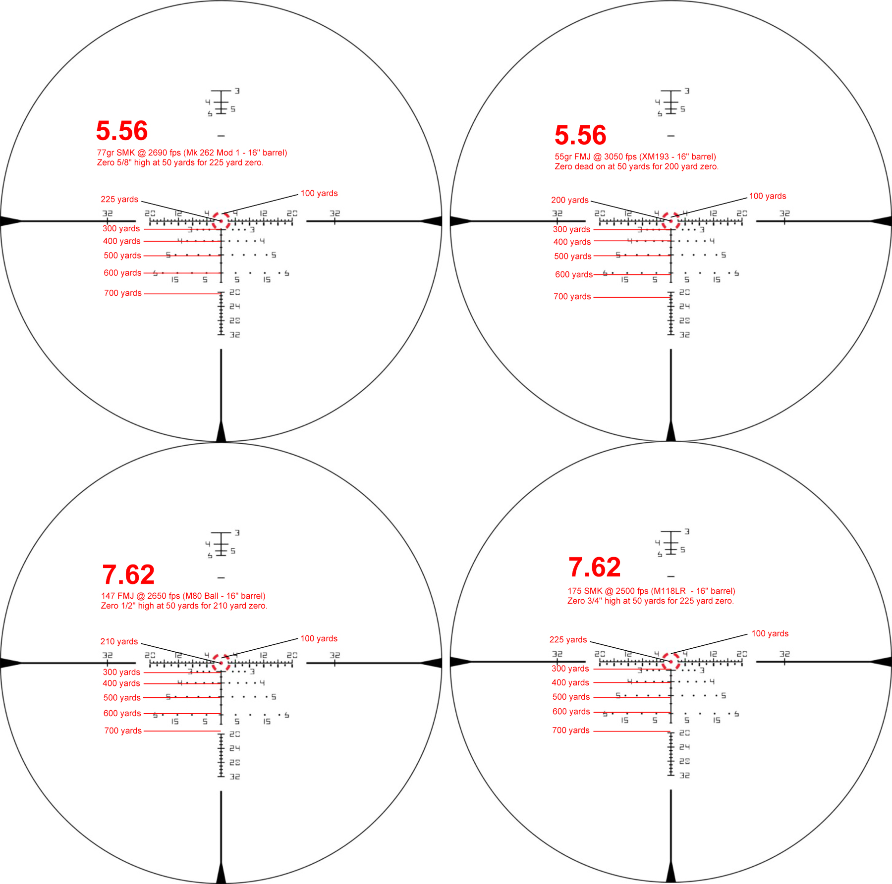

To OP I don't know what your experience level is but 800 yards is a long shot at night not to mention id at that range. There's guys on here that can reliably make that pid and shot but I'm not one of them and you probably aren't either. A used yoter and g3 would come in around 6k if you shop around and is stupid easy to use. It'll get you to 4-500 depending on conditions. If you just want to check the intermediate range box like I did and get on with your life it's a tough combo to beat.
Note the smk drops in 556 and 308 out of a 16"
Eta drops pic stolen from someone on here but can't remember who😆
Only issues Iv had was the rail mount arm breaking it was on a pvs26 or a 30 can’t remember we had both. In its defense it felt hard when I was attaching it and it was used more than the only spoon in a meth house.
Also tripod with a pvs-14 and a 3x magnifier is a great observation device at night probably better stuff out now but that was always a go to in the hide
The yoter does punches way above it's price. Especially with used ones popping up it's a great starter device. Some like me will be satisfied and people going high dollar will be able to see what's what and sell it for close to what they paid.

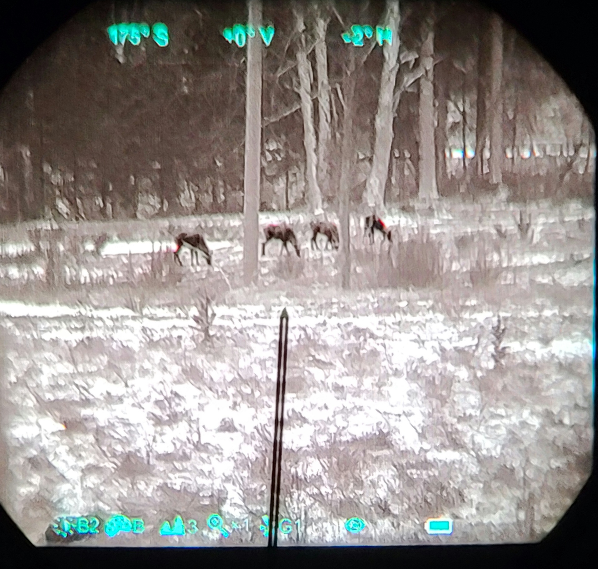

I am comfortable with way more than 4x on my Tig. Here's a shot at 20x:
Now I agree that its lack of manual focus hurts it beyond 300-500 yards depending on how picky one is, but I'd wager most users would feel comfortable with its image quality through a 10x day optic. At 600 yards it easily detects man-size targets but you'd have some trouble shooting one confidently.

The Yoter C samples 1 Pixel per 0.79 Square Inches at 100 yards with a 50 mm lens.
The Snipe-Ir samples 1 Pixel per 1.39 Square Inches at 100 yards with a 35 mm lens.
Bigger Germanium lens gathers more data. They are both 12 um units. Snipe is twice the price.
Yoter C will walk all over the Snipe at longer distances for image quality. I am a one is none and two is one type of guy.
If I had to choose between these units, I would buy 2 Yoter C's and call it a day. :)

Here's another Tig image that's a little more representative:
I've been taking 20x pics with my Hensoldt because I don't have a decent unmounted riflescope right now, but next time I unmount one from its host I will get some TTL pics on lower mag. But I don't find it to be excessively pixellated at this distance/mag combo. One fun accidental discovery is that the Hensoldt objective lens is so big it can see around the Tig, so light sources show up as visible light overlaid on the thermal image. You can see the reflection of a streetlight glinting in the car's right taillight.
Reactions: WhereNow&How
The yoter will hang with far more expensive devices and would crush something like the snipe which seems to get very poor reviews. A lot of what you're paying for in something like a tig is durability. Don't get me wrong the yoter is solidly built but next to my nox/14/coti it has a commercial vrs military grade feel.

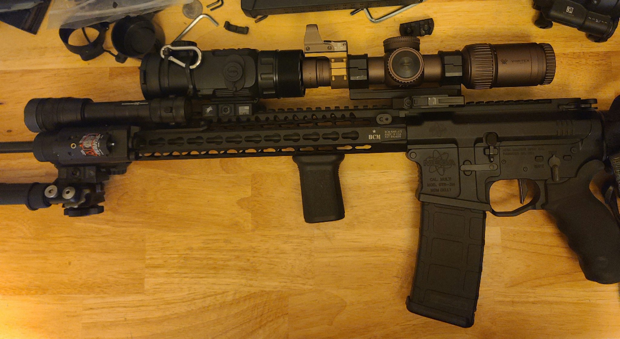

With any clip on weight/balance is going to be an issue. With lights lasers + the clip-on even a rifle that started out light weight becomes front heavy really fast.
For scale this is a 15" rail. On shorter rails you'll run out of 12 o'clock real-estate in a hurry.
