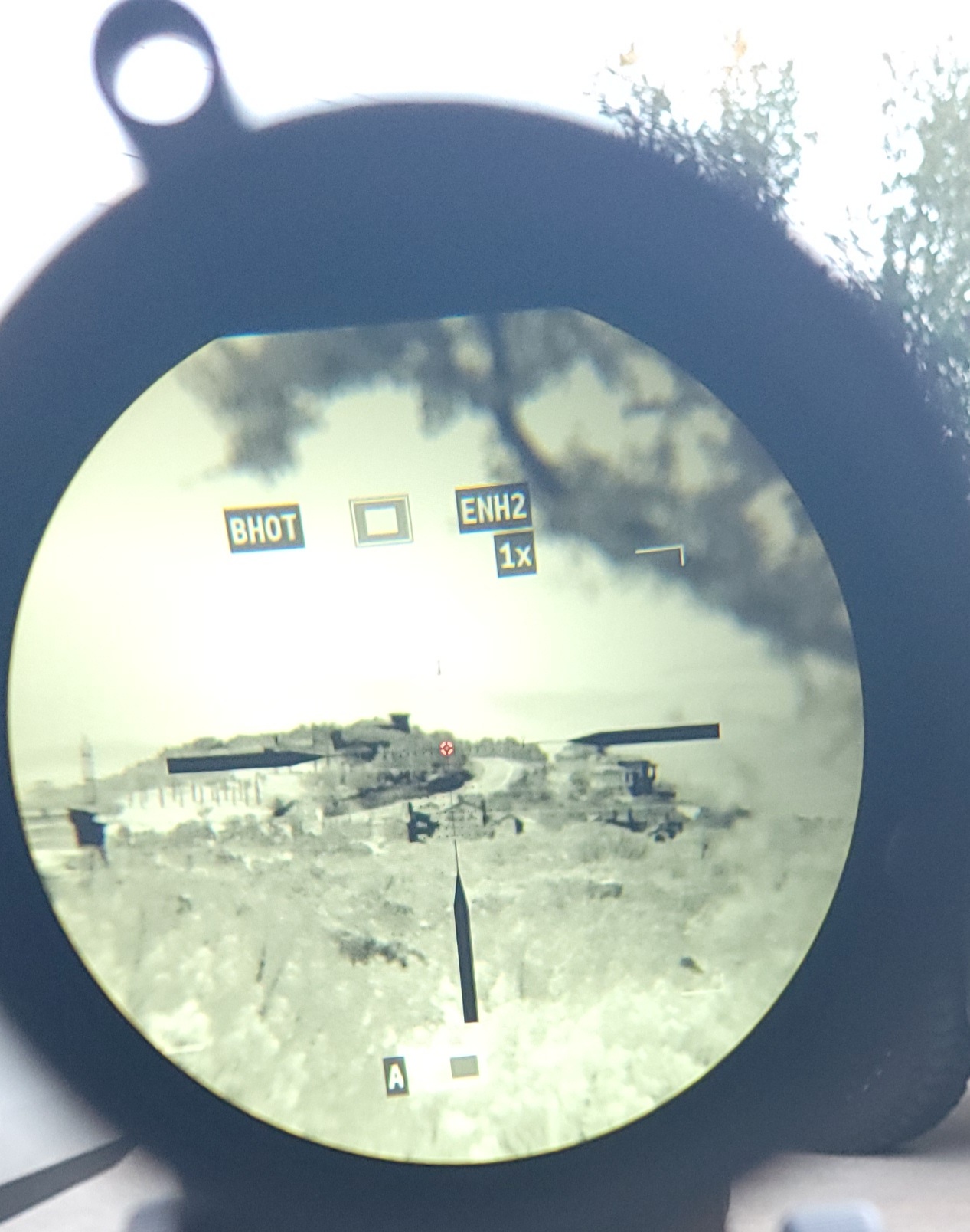

The second cell phone pic below is a house and hill top at 2200 meters. I was able to see a person walking their dog on that road with enough detail to tell them apart at that range.

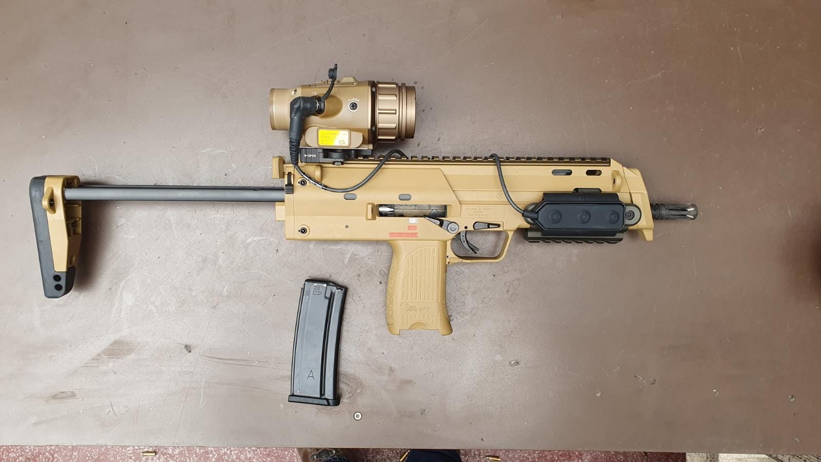

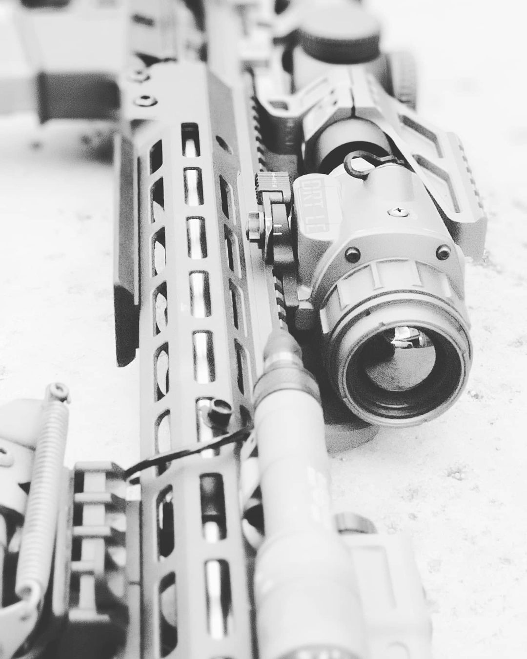

    Is there any news to report on the commercial availability of drs iws

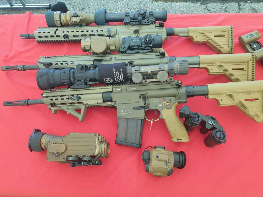

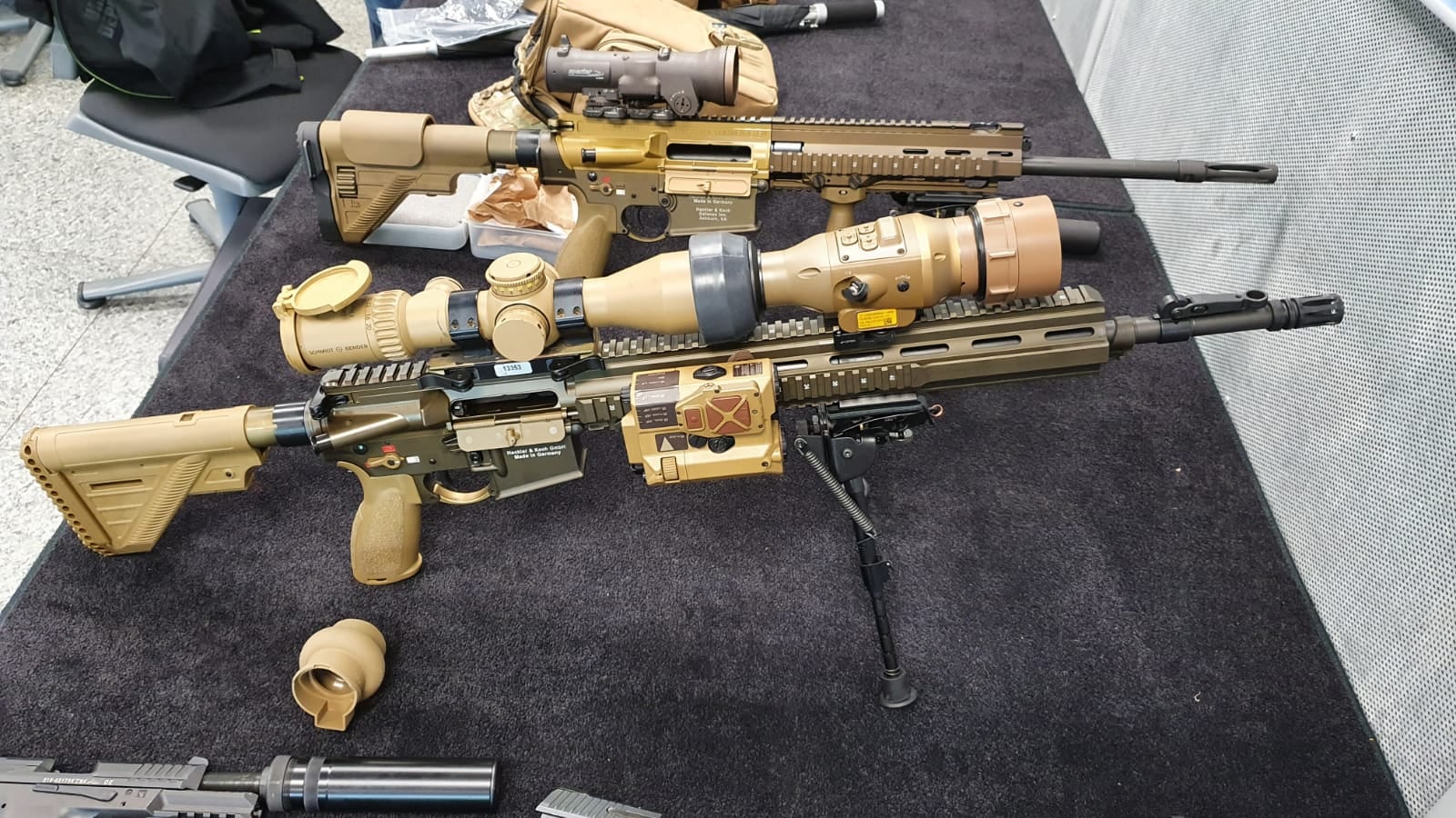

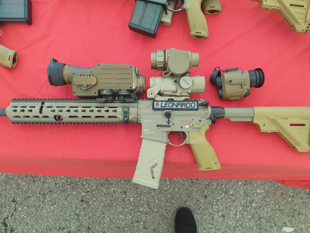

    Terry Cross
    Dingleberry
    Commercial Supporter
    Supporter+
    Mar 15, 2003
    1,952
    5,001
    Alexandria, LA 71303
    www.kmwlrs.com
    From the way it is used in the photos, it must be the equivalent of a modernized CRATOS.
    Very cool and I'm very interested.

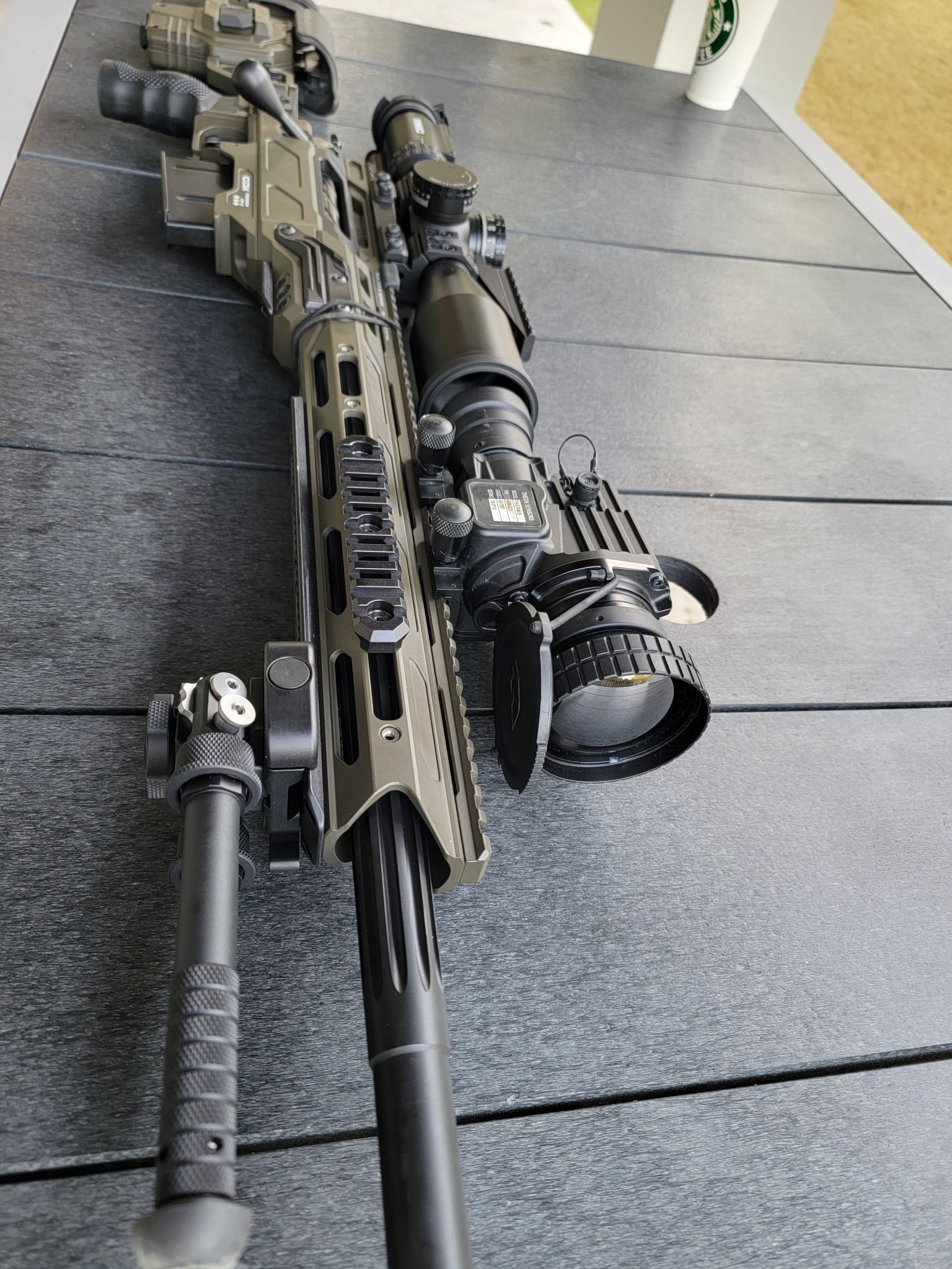

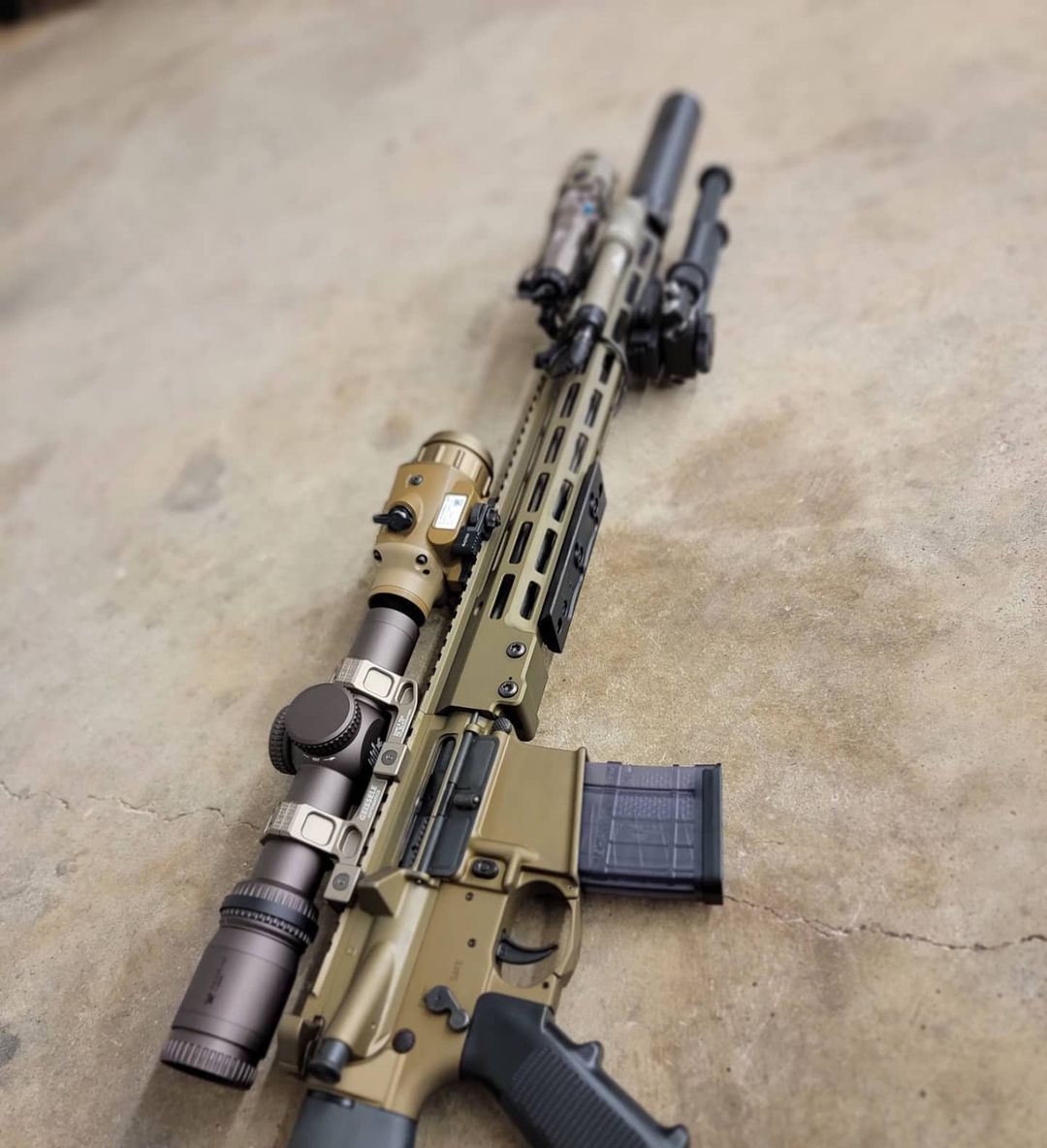

    Sweet ass rifle. Can you give me a run down on it? Looking to build another and rather like this one..
    cake5150
    Jan 7, 2014
    386
    207
    Fort Wayne, Indiana

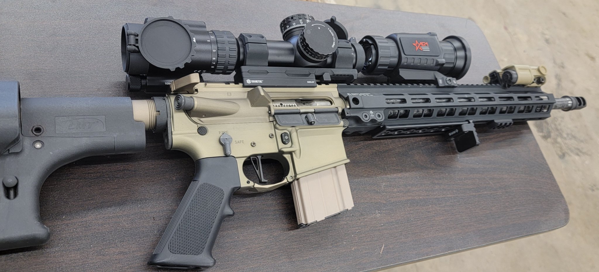

    I know who's stuff that is.... :)
    I have to ask, is the INOD in that picture (at least it looks like an INOD, please correct me if I'm wrong) really as good as people say? If the performance of my AN/PAS-13G at 200 yd was a 3 out of 10 for me, approximately where would that thing fall? The only MWIR device I have ever played with was a 13B(V)3, and I was fairly shocked with how far it could see.. Asking for a friend :D
