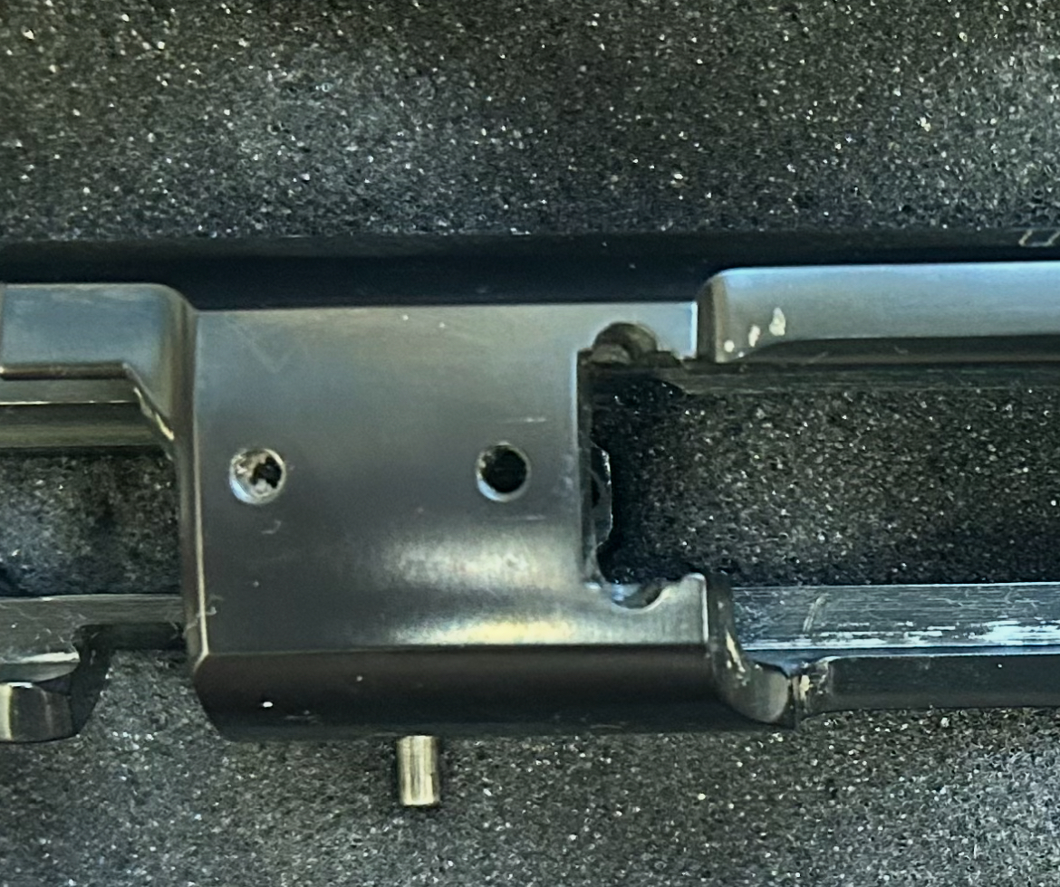

I’m not a machinest and thus I am not an expert, but since you are openly asking for opinions, here’s mine. Below is my vintage Remington 40-X repeater with a factory clip slot that was reportedly made in the 1969-70 era based on its serial number. Please note the two small “semi-circular” cuts that facilitate holding the old 5-rd stripper clip into the clip slot for rapid fire reloading during a rifle match. The two little semi-circular cuts are what is seen on the original 6-digit M40 rifles made from 1967-69. I call this a “true” clip-slot design:

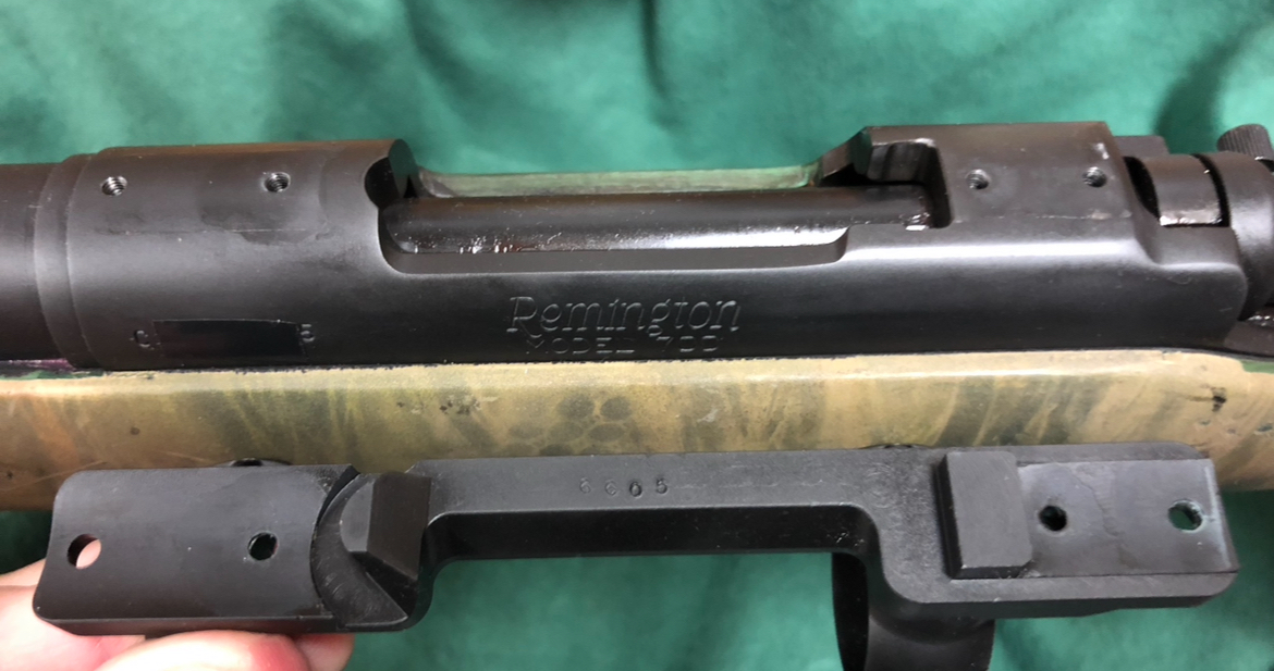

…in contrast, below is my C-prefix M40A1 replica that was made by a retired 2112 at PWS many years ago. It’s lacks the semi-circular cuts, and is what I will call a “lug slot” cut. It allows the rear lug of the Unertl scope mount to fit tightly into the “lug slot”, but it’s not going to work well with the old 5-rd stripper clip as it lacks the two small semi-circular cuts to hold the stripper clip in a vertical position. That’s my opinion of the nuanced difference between a true M40 era “clip slot” versus the later “lug slot” used on the M40A1/A3/A5s.

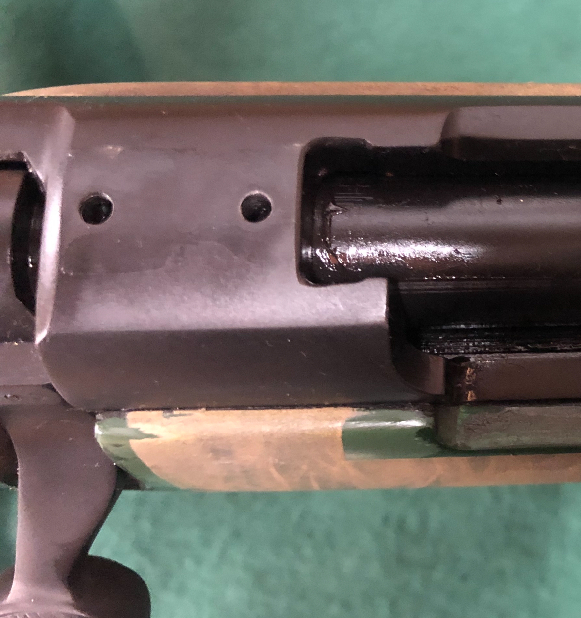

Below picture shows the front and rear lugs of a reproduction M40A1 scope mount that illustrate the purpose of hand-filing the scope rail to fit very tightly (basically zero tolerance) within lug slots machined on the M40A1/A3/A5 receivers.
Lastly, I will also note that once the M40 or M40A1 scope rail is installed, it is visually IMPOSSIBLE to see if the machining on the receiver has the small semi-circular cuts for the stripper clip or not - so it’s purely an OCD thing when it comes to machining that area.

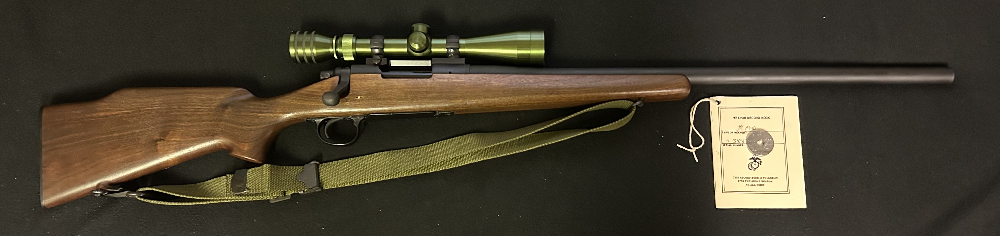

My 2cts as a non-machinest, and good luck with your project. (Below is my replica M40 project based on that old 40-X clip-slotted receiver).
