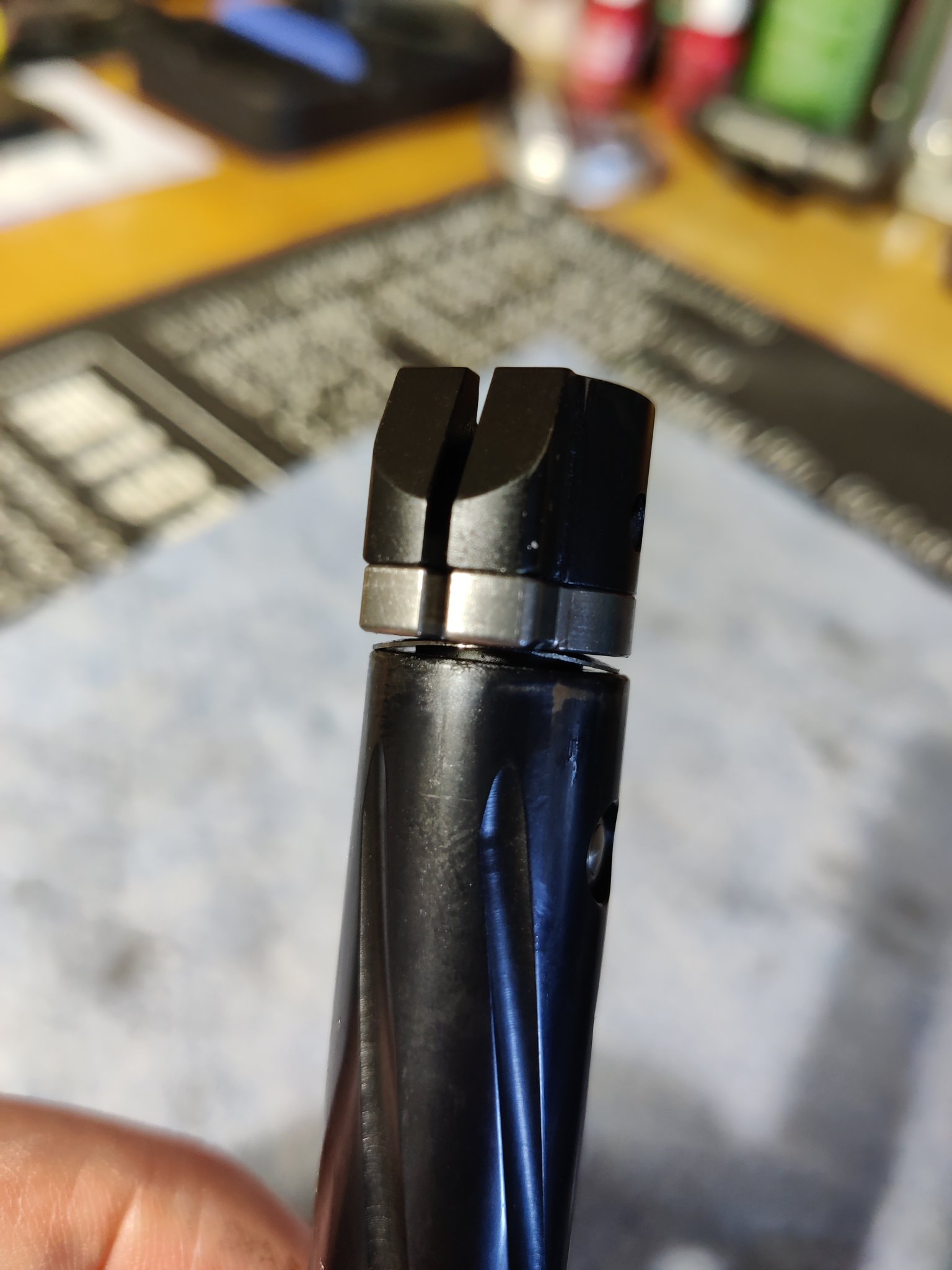

Bought an origin action and the guy thought he reassembled the bolt head to bolt correctly, does someone have pictures of their bolt and how everything should look? I noticed the silver parts has a taper on one side, does that face towards the bolt or the bolt body? Also where is the correct location for the spring type washer?
Thank you for the help
Washer behind the baffle...baffle looks symmetric to me...
My baffle is flat on one side and tapered where the bolt head slides through, but yes that picture does get me closer. He assembled it wrong, he has washer between baffle
You got my curiosity going and I tore it down real quick...flat side of baffle faces the spring washer.
