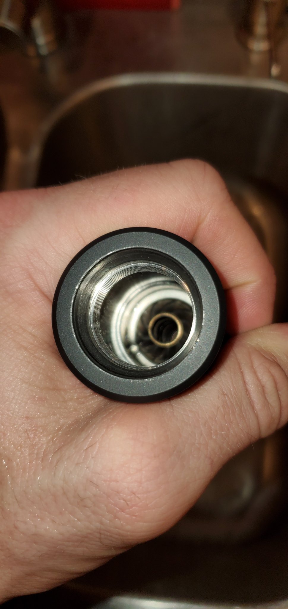

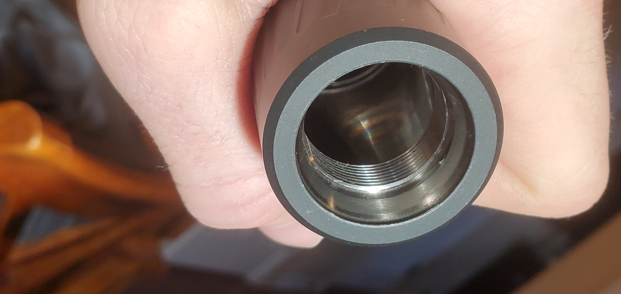

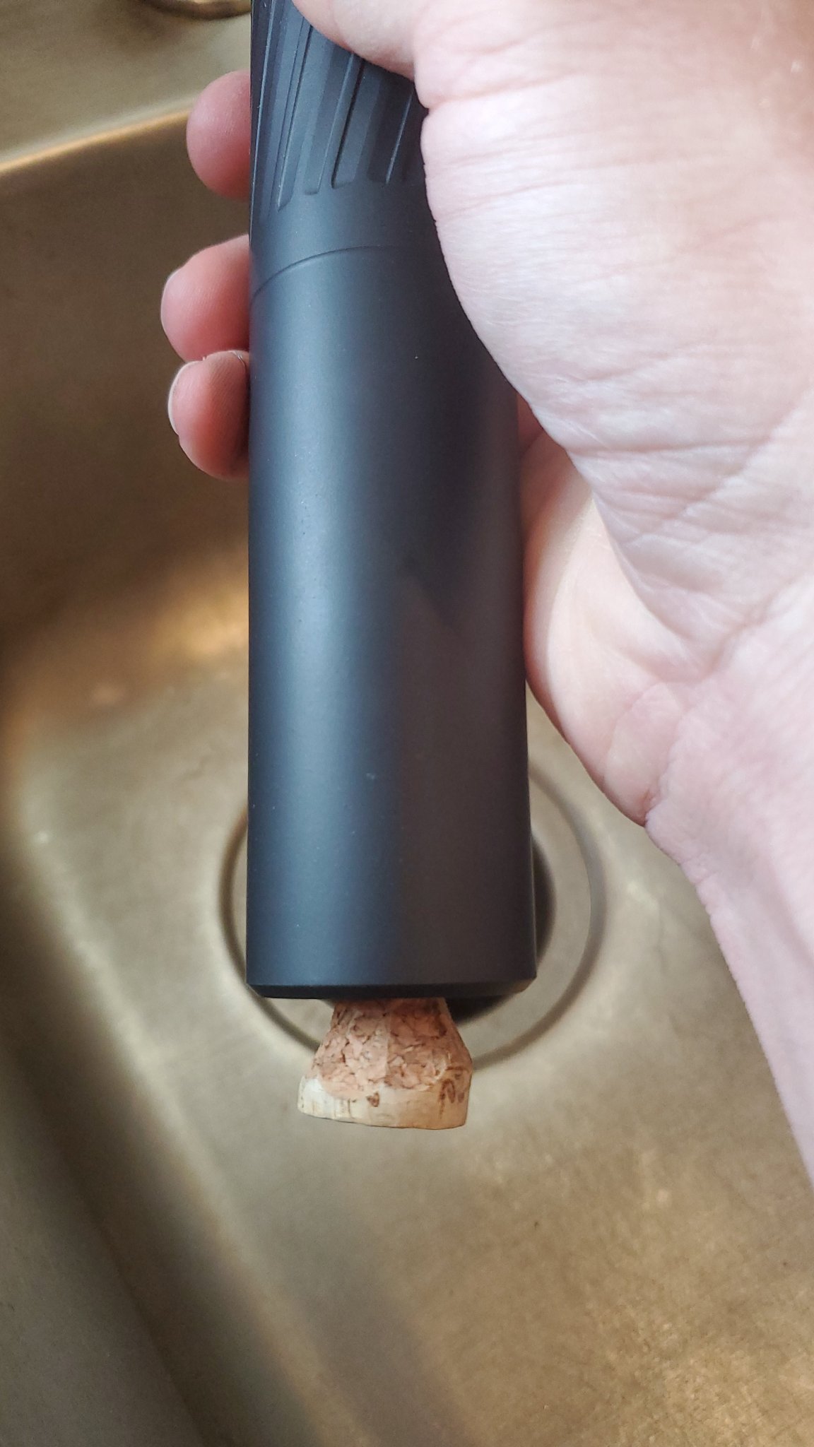

I made a plug yesterday out of a wine cork. Filled up my TB U7 and thing started to foam out pretty quick. No way of preventing the CLR from overflowing foam on the cerakote. I wiped it up and then dumped it out after 30 minutes as I didnt want the CLR all over the cerakote. I rinsed it out and was surprised how much crap came out after 30 minutes.
I filled it back up again but didnt fill it into the brake threaded part or taper. I watched it for 30 minutes and dabbed out the foam on the top from spilling over. 10x less foam then the first time. I cleaned it out again with soap water.
Filled it up for a 3rd time at same level as the second. I let it sit for a few hours and cleaned it out. The blast chamber at this point was 100 percent clean but still a little on the ring at the bottom of the baffle against the tube. I was going to call it good at this point. But said what the heck.. filled it up again, and left it for 10 hours. Little more came out but not a ton. So I called it good.
I am waiting on another product like the CLR that will allow me to soak the can completely instead of having to babysit it for the first hour so it doesn't spill out and soak the cerakote. It was recommended to me here by another member and it's called hillyard iforce DMB product #474. Pretty much the same thing as the CLR but I'm told works better. Not that the CLR isn't amazing.

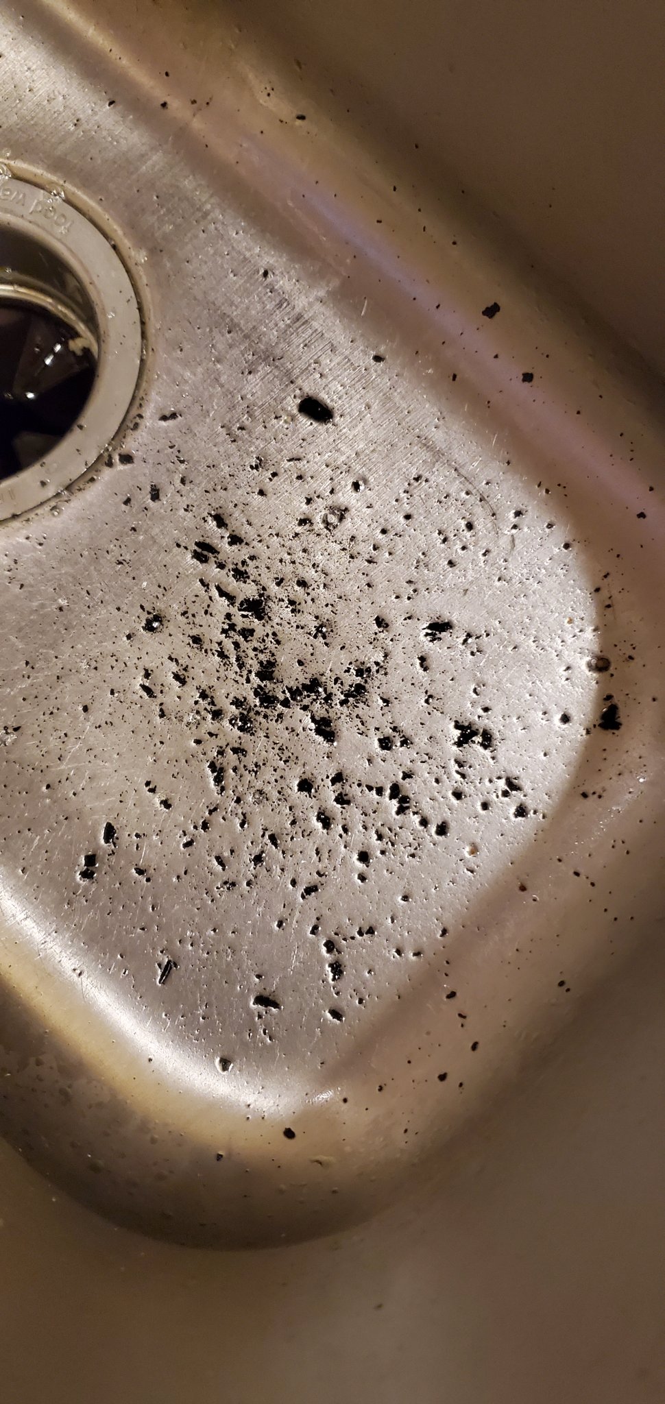

The picture of some carbon is what it looks like every time you flush it out. But take that times 10 for every rinse. Flushing with water and shake the can, tip it over and you get that many many times over. I just took a pic of one quick where it didnt wash down the sink yet. The carbon is like mud. Soon as you touch it its soft and you can not pick up chunks of it.
I lost 2 oz of weight in the can.
