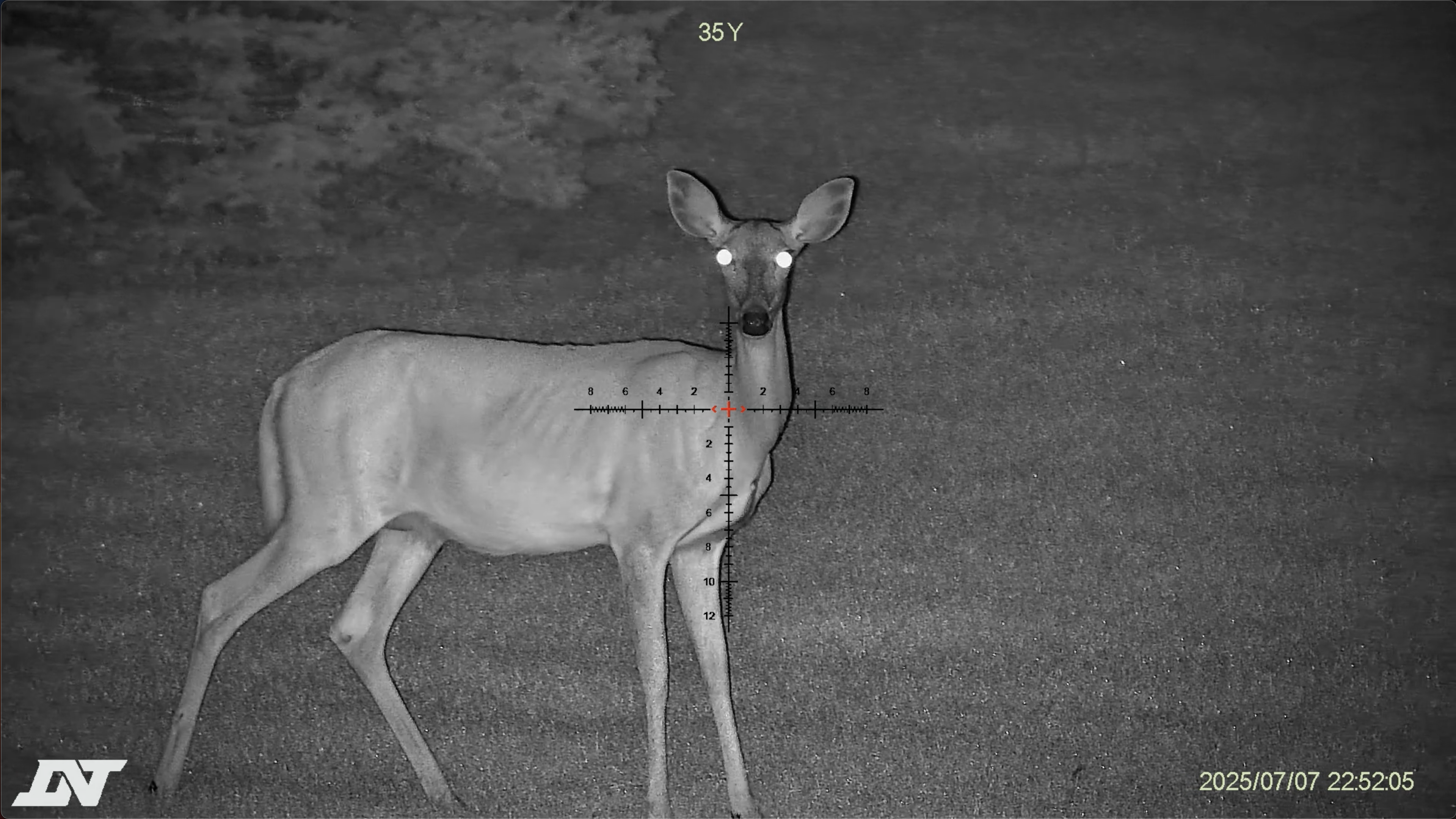

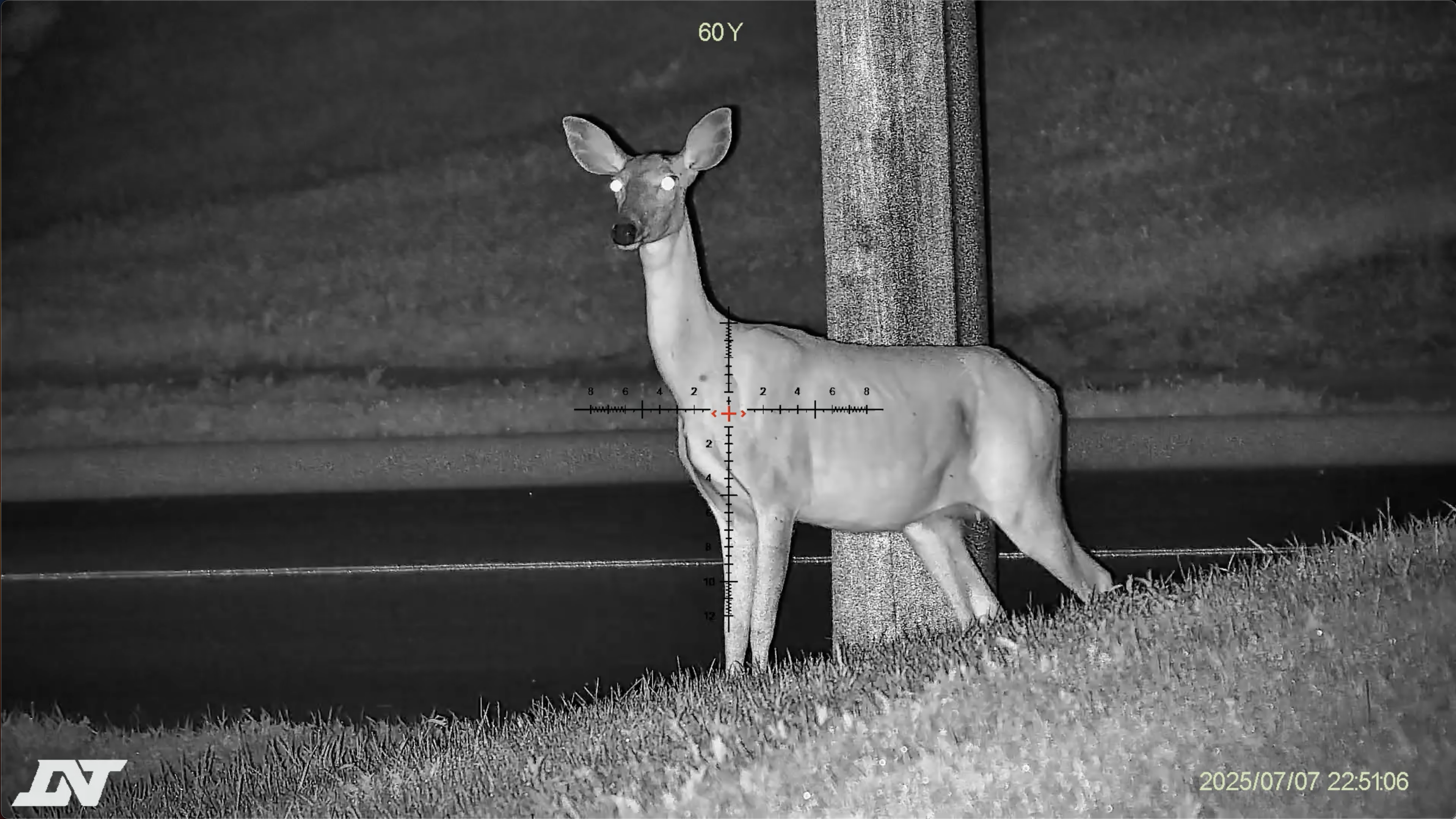

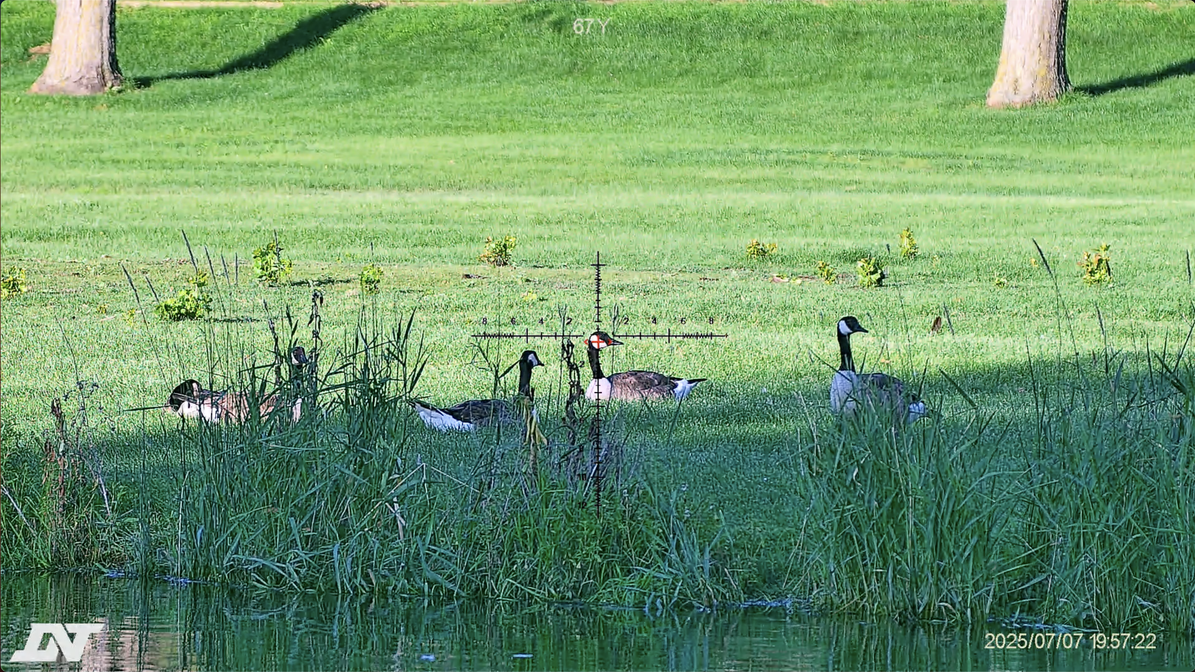

I was highly skeptical, but I've been testing out the DNT Zulus HD LRF both the 3-12 and 5-20 Gen1 which is Day and Digital NV only. (Non-Thermal) and I've been highly impressed. I hear the Gen2 just got released as well.
Pros are that it works day or night, has built in LRF, with FFP reticle, and onboard ballistics that calculate holds in real time.
Does it "REQUIRE" IR ... No. But it's built in and helps for sure.
Major pro for me, is it has onboard HD video and audio recording...and it's stupid cheap.
Is it BETTER than everything else? Probably not, but it's pretty damn good, that's for sure.

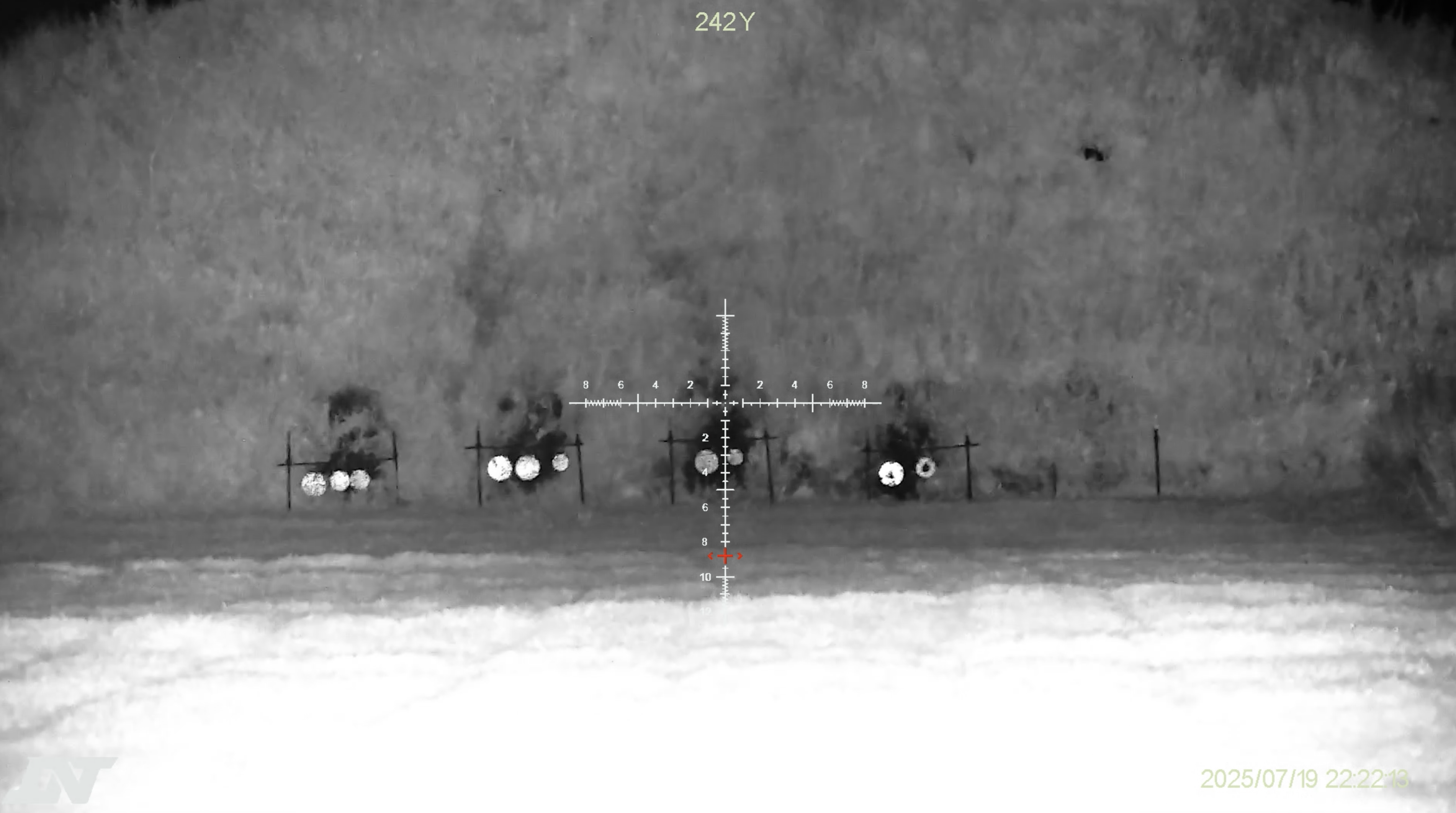

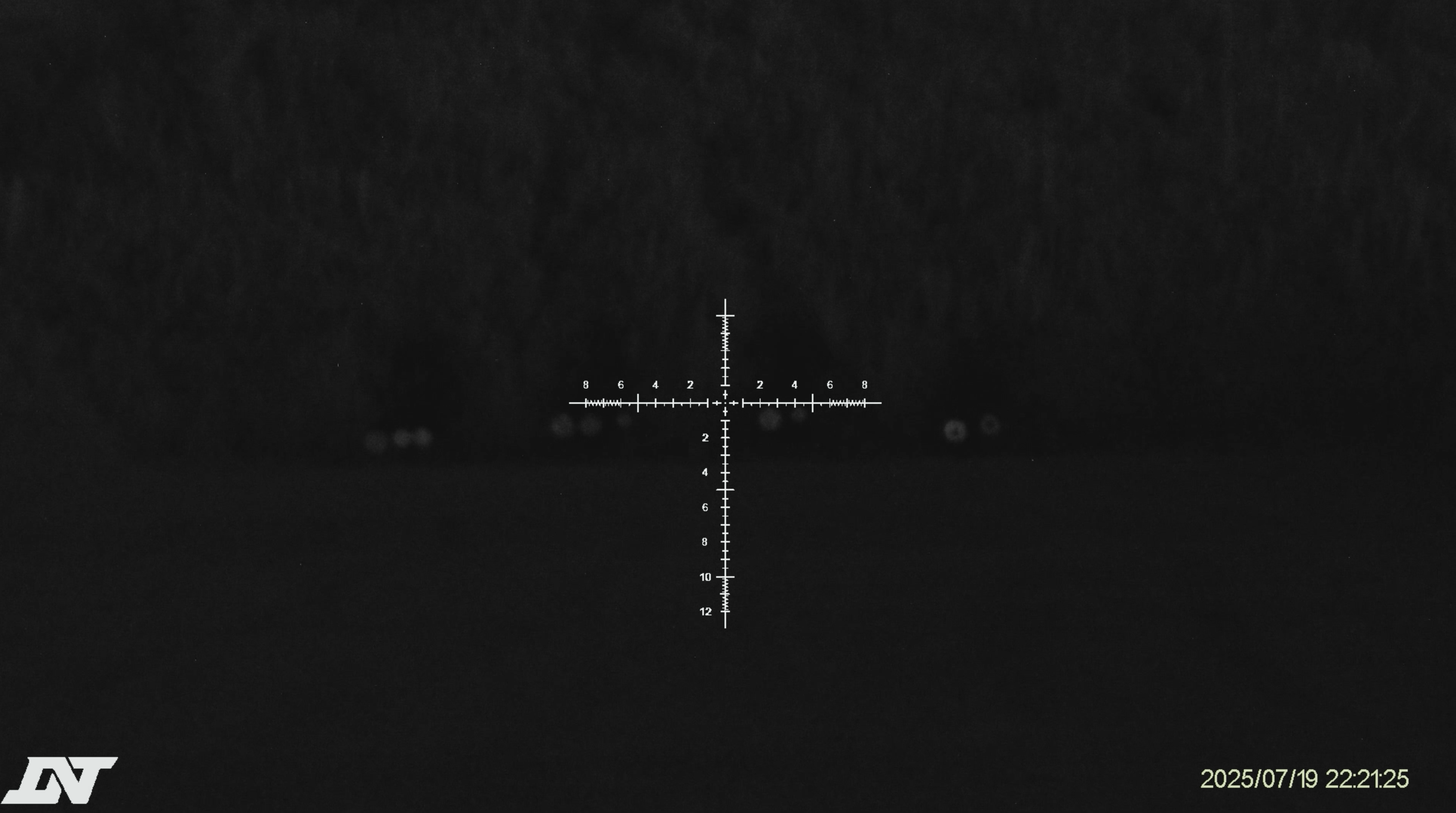

Digital NV functions...but barely without IR. It's gotta have full mood, star light, residual street lights etc to amplify.
Here's tonight. Completely overcast with no stars or moon visible.
Good for what it is...but I don't think it will ever compare to what it wants to be.

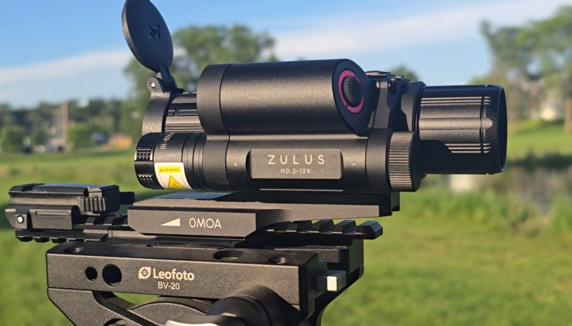

View attachment 8730932View attachment 8730933
Thanks for the photos. With those I can see how a minor tactic change, would allow one of those scopes to have a place. Is the laser on all the time, or can it be turned on & off quickly? That mfg'ers 3-12 model is what I was looking at, and its looking like based upon your range & mil hold the same reason.
I've been testing the 3-12 and the 5-20 swapping them back and forth between 223, and 22lr and just using the tripod to film critters.
The 5-20 has a pretty narrow fov and imo, would be better suited for day shooting. Even at 5x...its pretty tight if youre trying to locate things, and 99% of my night time engagements would be inside 100 yds.
If I were going to buy one for night time. It would be a 3-12. It was mounted to my AR, or I would have used it last night. The 5-20 was attached to my tripod.
The LRF is NOT on all the time.
It's a single press to activate it, and then another single press turns it off while it calculates and displays ballistic holds.
Here's the 3-12 and few days ago
