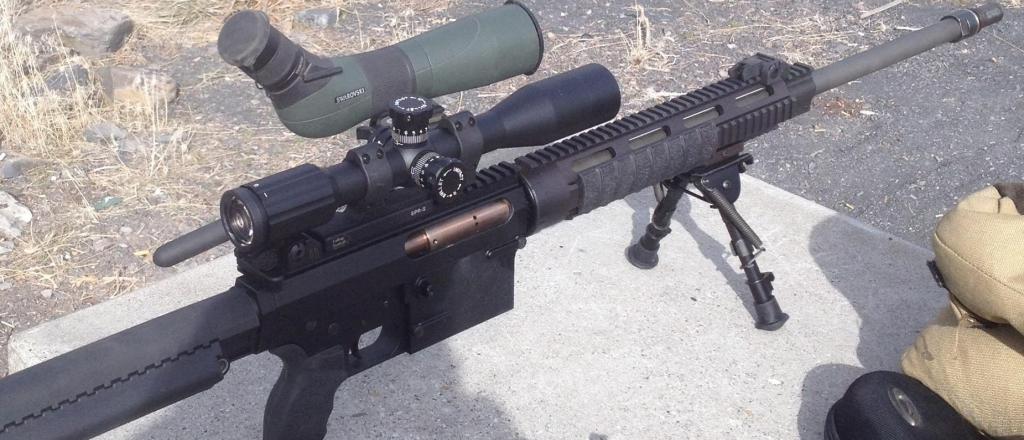

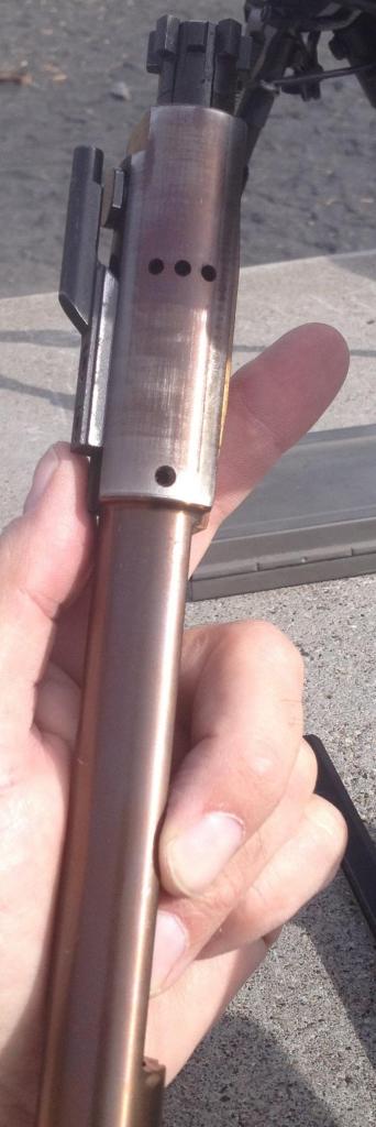

    I went to the range and shot a few through her. I bought a couple of boxes of 168gr Gold Medal Match. The last two boxes. It's wasn't sighted in but I got it close enough to shoot some 3 round groups and it was under half an inch the best of three the worst was under an inch. I thought it had a 2 stage match trigger but I was wrong. The trigger blows! I think the groups would tighten up if it had a different trigger and some loads that were dialed in for it. But heck it still shoots pretty good. Oh, look at the size of that bolt! AR bolt on steroids!

    Excellent shooting DuneBoer!
    Shoot more and take pics for us...rifle and group pics.
    Also can you post more information about the rifle?
