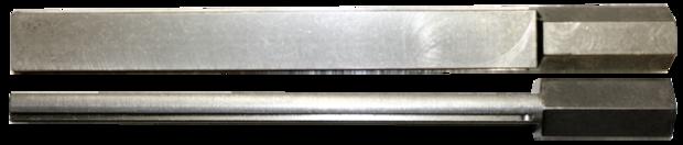

long story short I need an action wrench. I made a barrel vice, but I am only an ok machinist, and I can't justify buying one when they are $80+ when I am only gonna need it this once. also I like to do my own work, as I am quite mechanical and somewhat untrusting of gunsmiths.
You should be able to make one very easily if you're an OK machinist. Take a piece of hex stock and mill most of it flat and a chunk out for the antibind rail, and there it is. Or, take a piece of flat and weld a nut to the end of it. Since your barrel has already been off, it should work just fine.

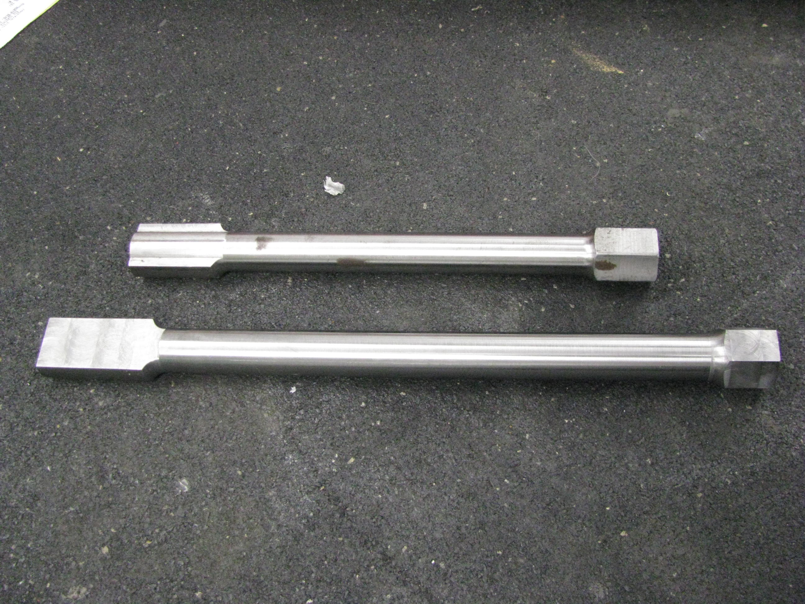

Red, I would be very careful of an action wrench like this. By the time you reach 150 to 250 foot pounds torque to break the threads loose on a tight fitting barrel the action will have to twist quite a bit.
A better one is cut away through the action and only grabs the front action bridge right up at the barrel. Even that style will not tolerate much over 150 pounds.
We just built one for use on the Chey Tac sized Stiller actions.
IMG_5419.JPG Here it is beside the Holland 700 sized wrench.

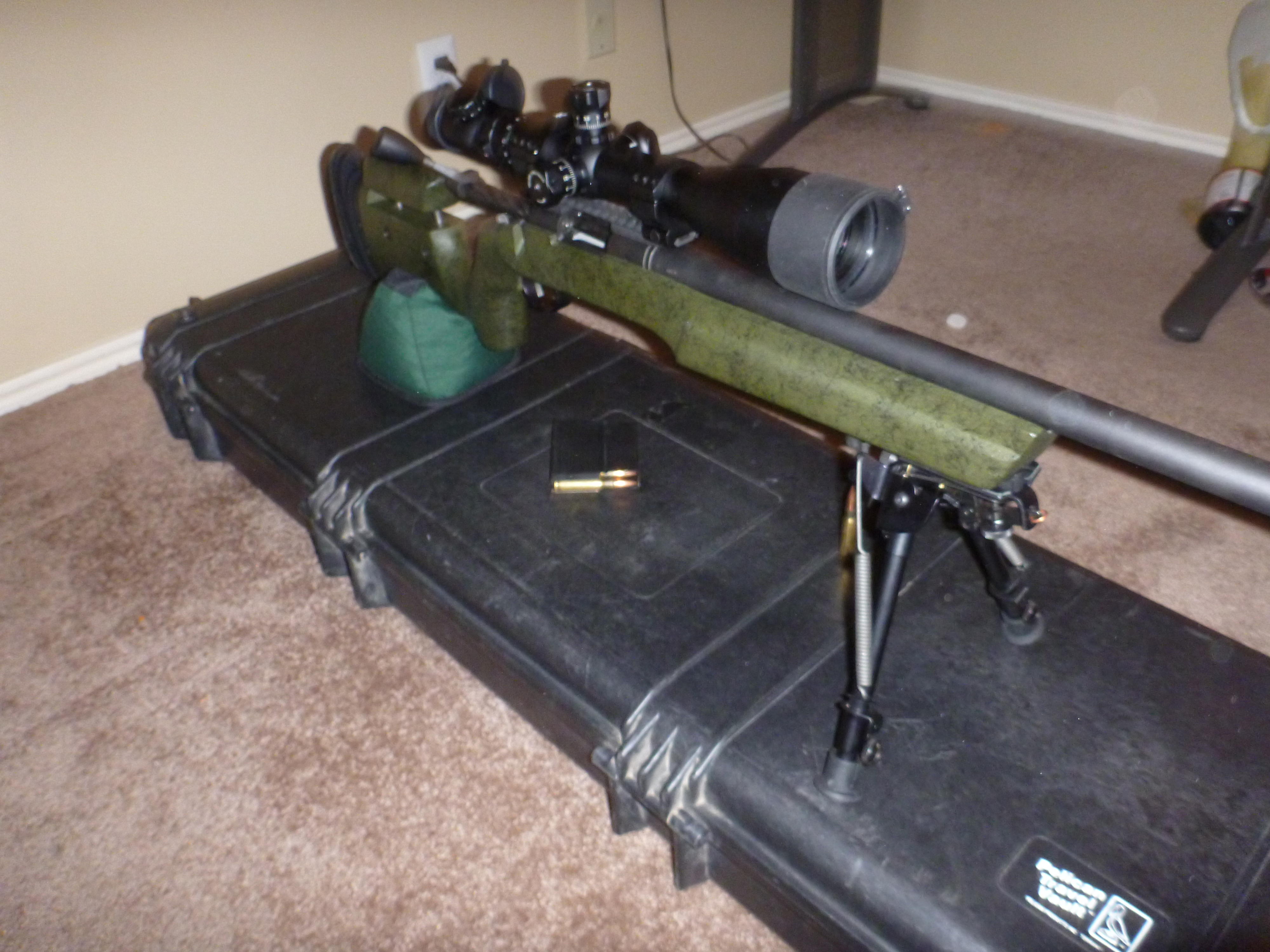

I just want to take a minute and publicly thank "sgtsmmiii" for his kindness in loaning my the action wrench to fix my r700, you sir are a true gentleman. I have now removed and re torqued my factory barrel and am back to shooting 1/2 moa average. Also my cold bore shots are far more consistent (about 3/4" right at 100) my woes are over, and I am most grateful. I would also like to say I believe some of you meant to help, but my lord some of you are ass holes about it. Work on that?
As for my character that was questioned repeatedly during this ordeal you can all ask sgtsmmiii if I screwed him...
Also for the haters here is a pic.:
http://www.snipershide.com/shooting/attachment.php?attachmentid=28823&stc=1&d=1391385997
