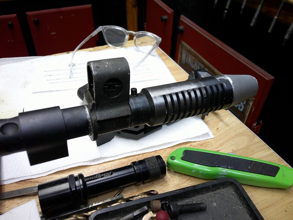

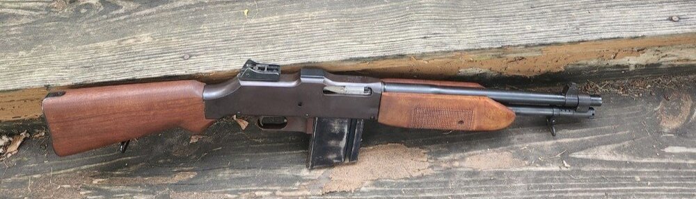

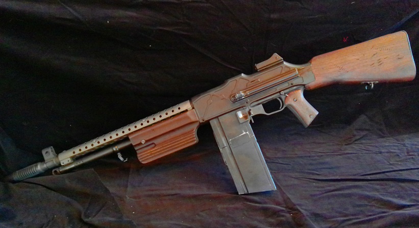

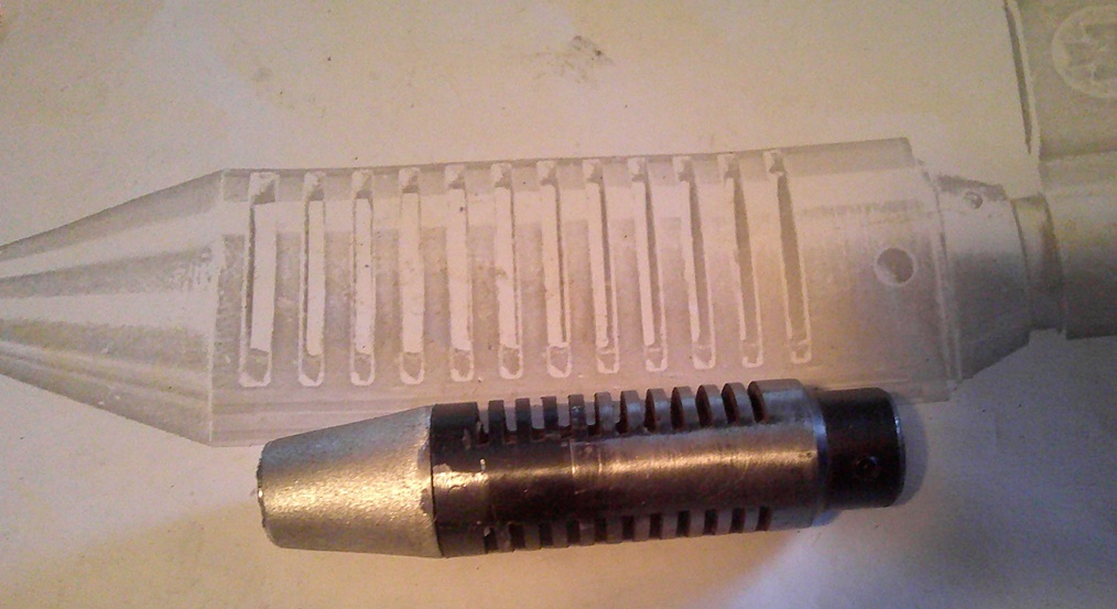

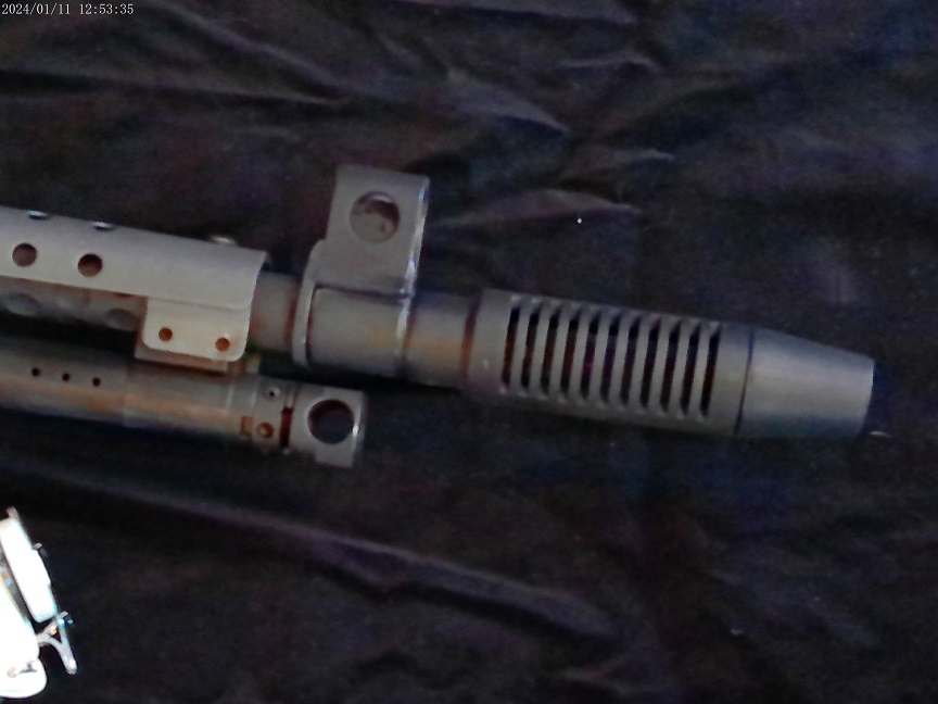

    Work has begun. Here is the muzzle brake. I made the threaded section a little longer.
    After doing research for the R80 monitor I came across the experimental m1918 "Jungle Carbine". I might go in this direction. Anyone want to buy a 5/8x24 threaded Monitor muzzle brake?

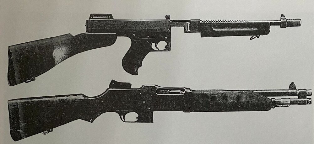

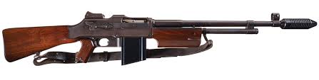

    The resulting firearm was similar to a variant of the BAR produced after WWI, the Colt Monitor. It was an M1918 with a shortened barrel and gas tube, no bipod, a pistol grip, and a Cutts Compensator on the muzzle. About 130 were produced, and all were sold to law enforcement entities.

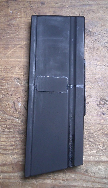

    I modified two mags by brazing re-enforcing plates, this is much sturdier than trying to weld/braze the thin magazine walls together.
    But people seem to like to weld the walls together even though it's a lot more work.

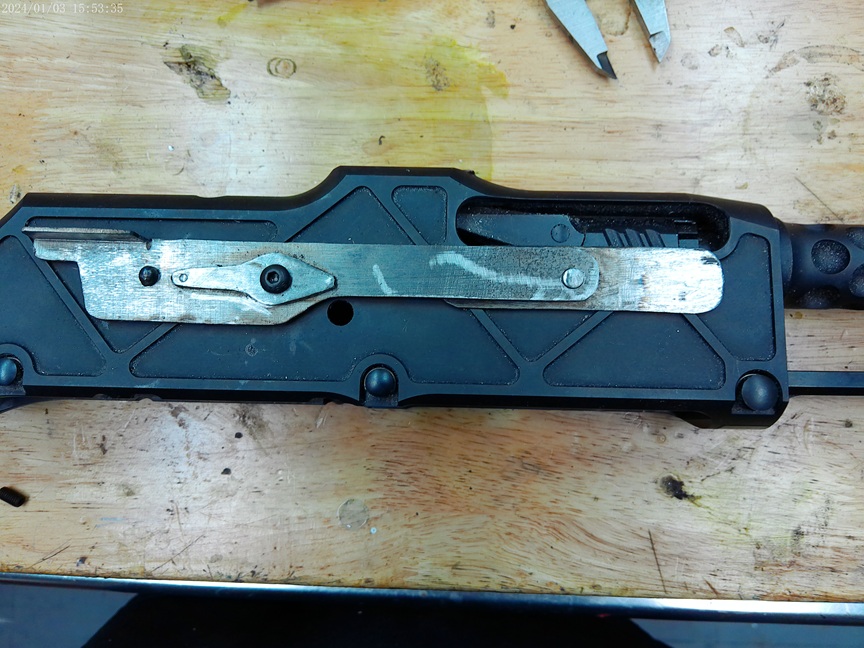

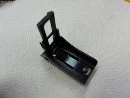

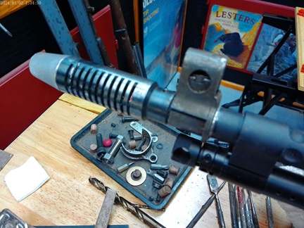

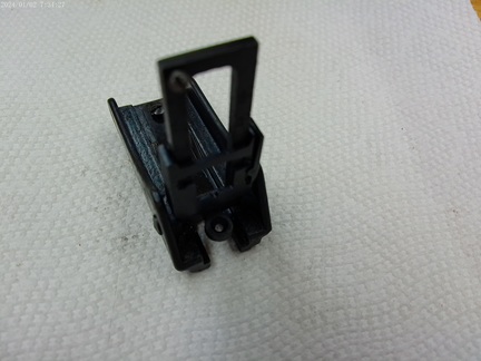

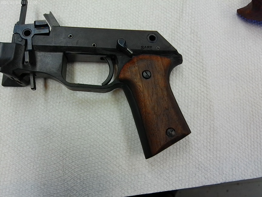

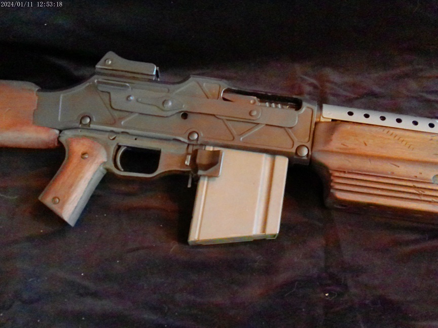

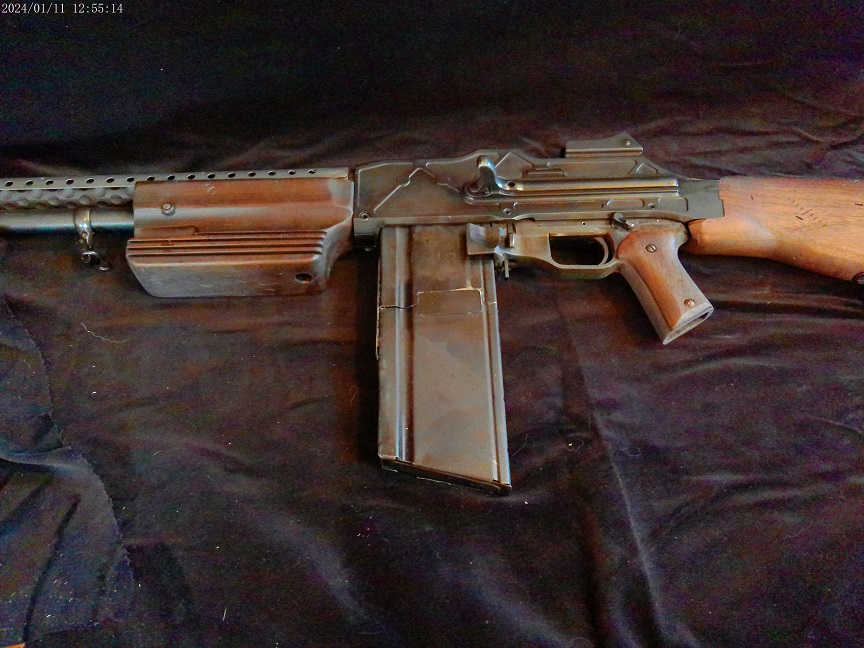

    Getting rid of the HCAR picatinny rail and installing original WWII rear BAR sight. The screws holding it in were smothered in red loctite and peened over. I had to drill them out. The muzzle brake was on so tight I was flexing the barrel trying to remove it. I had to cut that off too. I can't get the stock extension off and will have to wait till Monday to talk to their tech guys to find out how that's held on.
    Front sight and muzzle brake

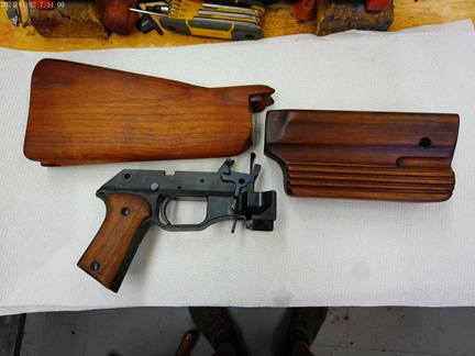

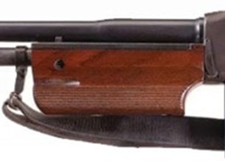

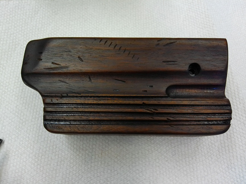

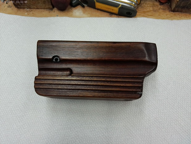

    Any particular reason the forend on the monitor was so much bigger than a regular BAR?
    Co-pilot has this to say:
    The forend on the Colt R80 Monitor was designed with law enforcement in mind, making it distinct from the M1918 BAR, which was primarily a military weapon. Here are some key differences:
    1. Purpose and Ergonomics: The Colt Monitor's forend was shorter and more streamlined to improve handling and maneuverability in close-quarters situations, which were common for law enforcement. In contrast, the M1918 BAR had a longer forend designed for stability during sustained fire in battlefield conditions.
    2. Weight and Portability: The Monitor was lighter overall, with a shorter barrel and forend, making it easier to carry and use without a bipod. The M1918 BAR, on the other hand, was heavier and often used with a bipod for support3.
    3. Material and Design: The Monitor's forend was simplified and optimized for shoulder firing, while the M1918 BAR's forend was bulkier, reflecting its role as a squad automatic weapon1.
    These changes made the Colt Monitor more suitable for law enforcement needs, such as combating organized crime during the Prohibition era. It was a fascinating evolution of the BAR design!

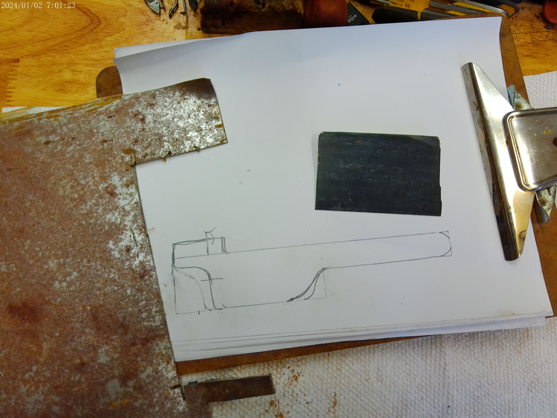

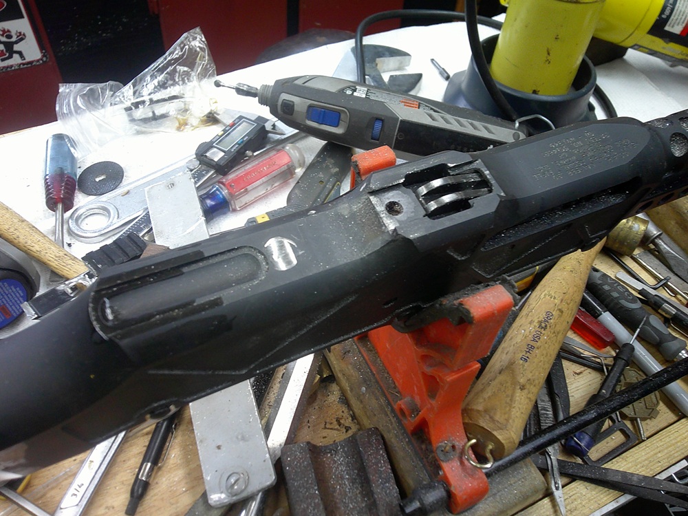

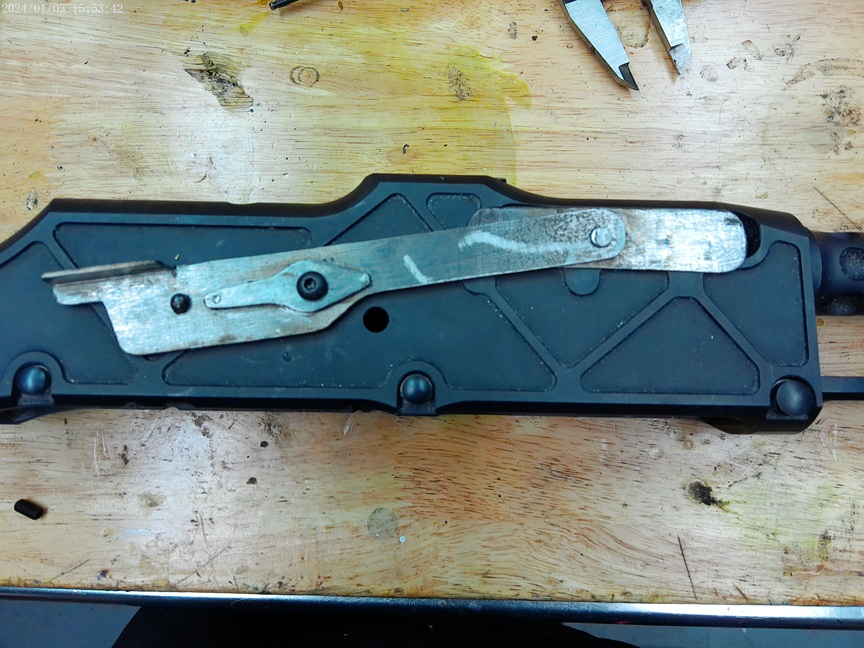

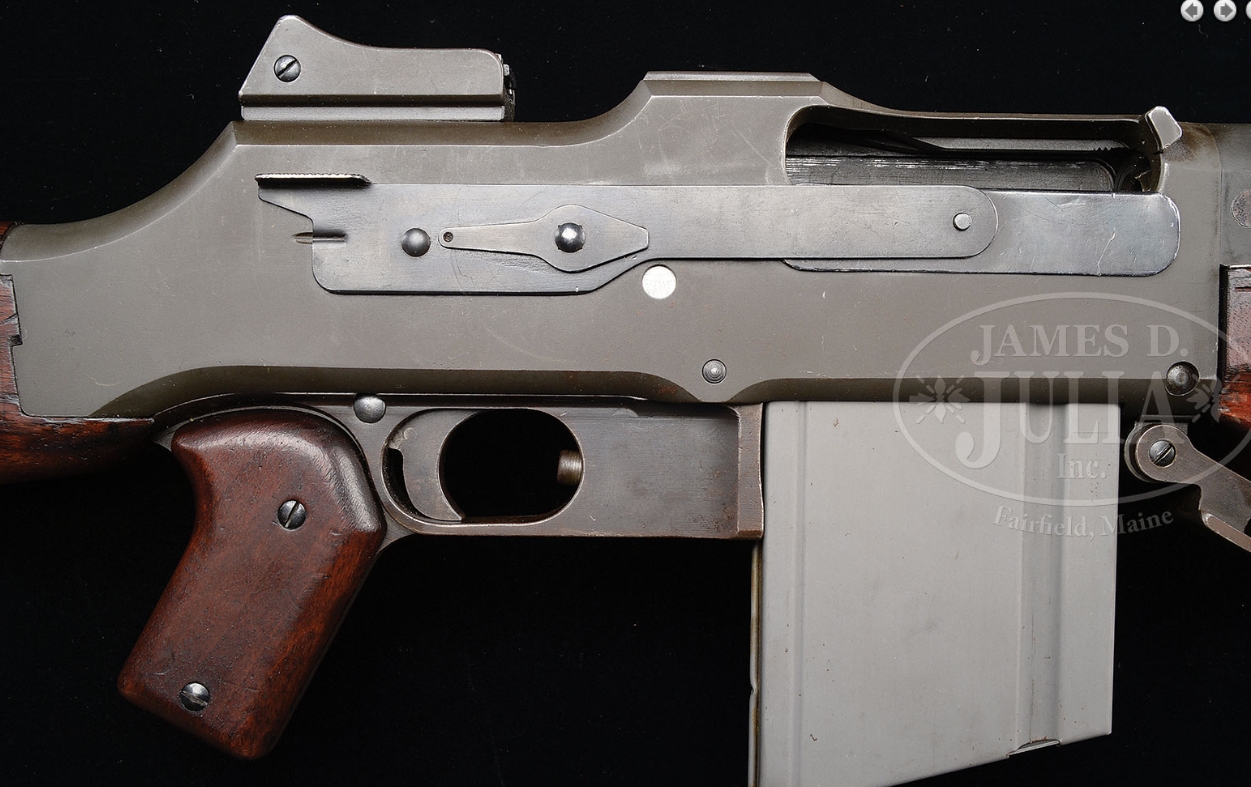

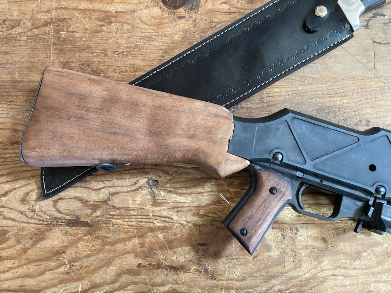

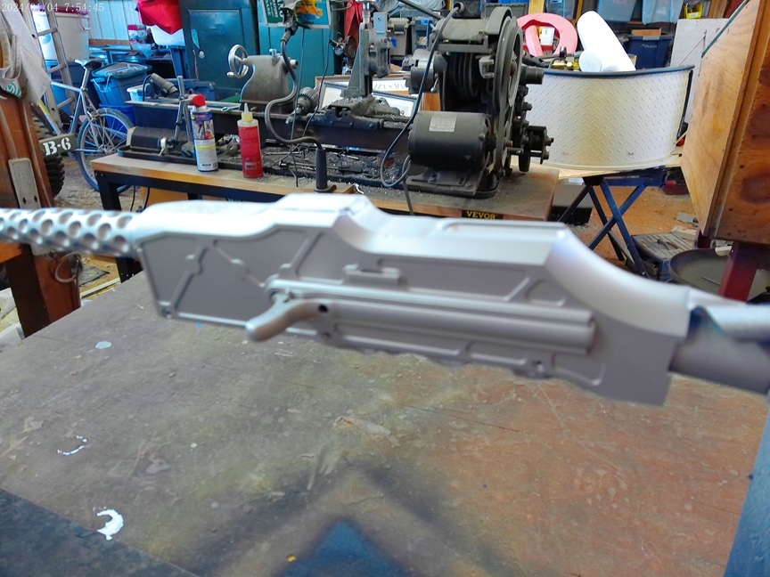

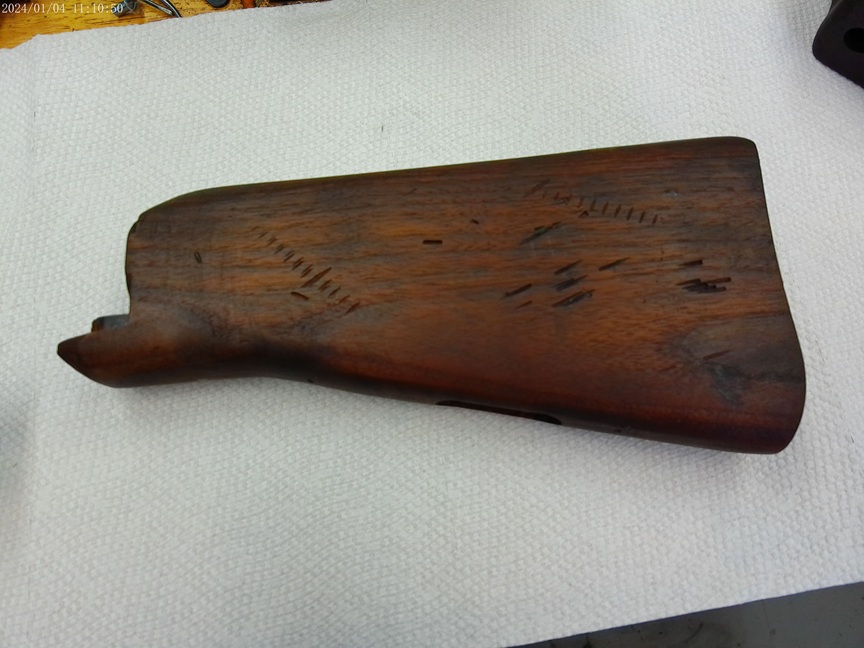

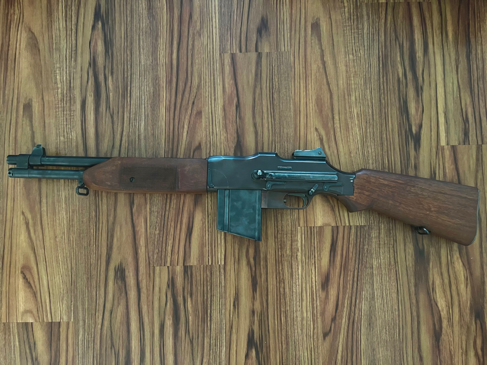

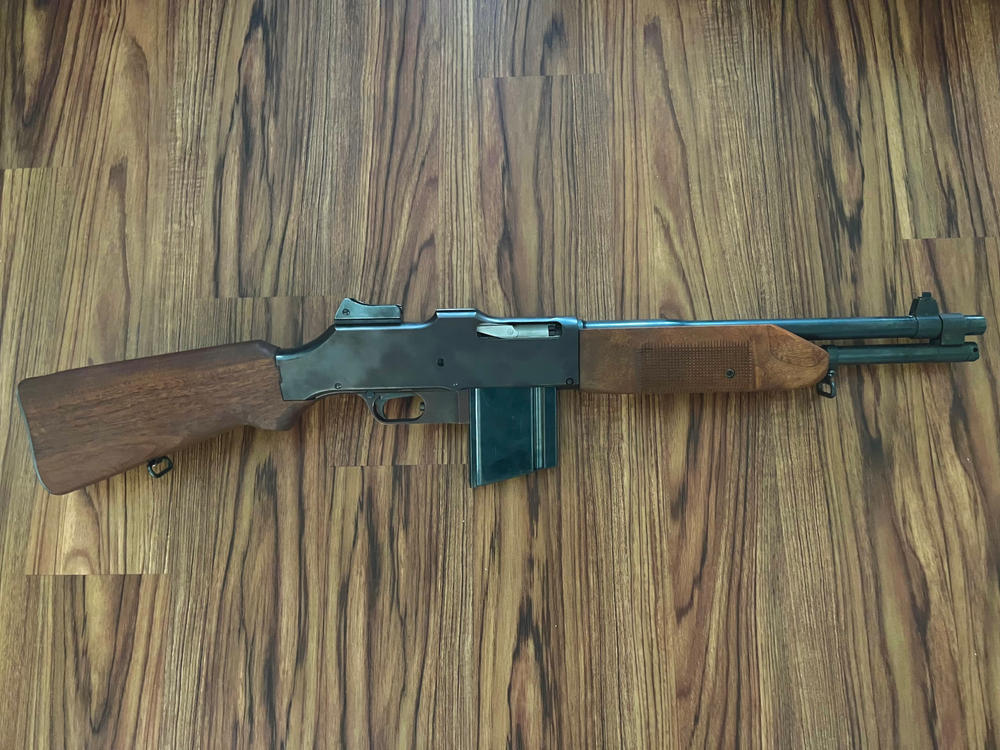

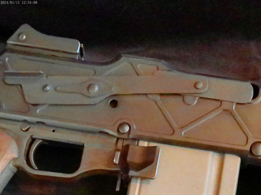

    Going to try and make the dust cover...not sure it's worth it. This is an easy way to spot a fake Monitor, as used in "Highwaymen". In converting the 1918 BAR to a Monitor, most do the obvious stock, pistol grip, forend and muzzle brake mods, but stop at the more complicated dust cover.
    "Highwaymen" modified m1918

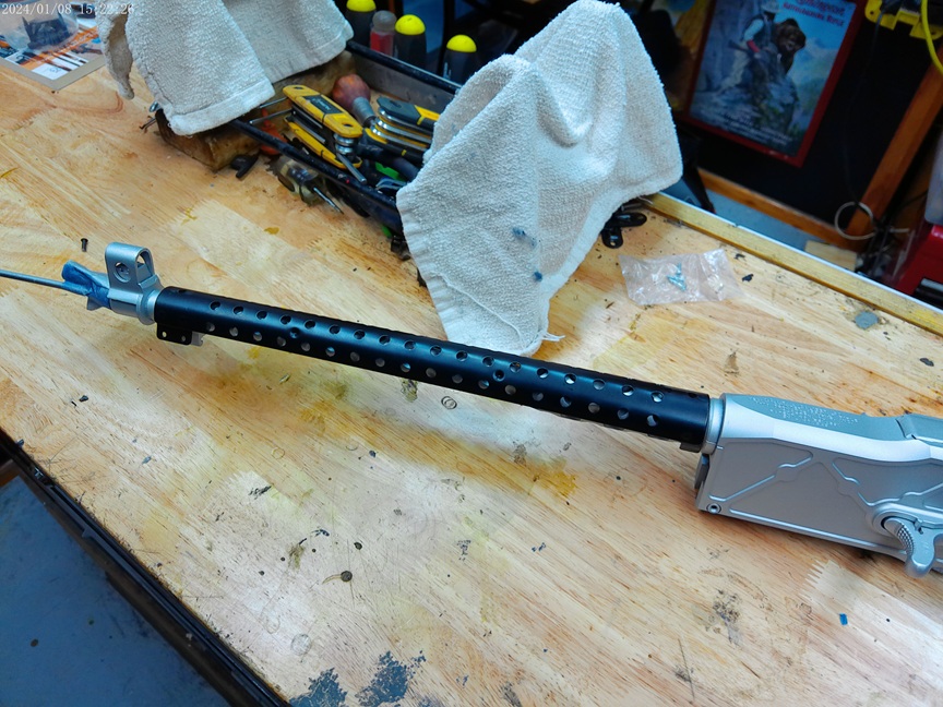

    Modifying an Ohio Ordnance M1918 would have been much easier...and way more authentic. The HCR was literally 2.5K cheaper. For that price I have to sacrifice a correct barrel and receiver profile. The HCAR has a dimpled barrel, i.e. fluting, and lightening cuts in the receiver. I have considered milling off the raised ridges from the lightening cuts in the receiver. I think the receiver would still be strong enough. The dimpled barrel is a perhaps insurmountable problem short of just replacing the barrel which I don't want to do. I am considering adding a heat shield or some type of sleeve to hide the dimples.
    How about filling with devcon?
    I considered Devcon, Acraglas and welding. I've repaired pits and gouges in metal before using all three. Devcon and Acraglas always leave a tell- tale outline. Welding can be done to where it is completely undetectable but you're really changing the metallurgy and are probably going to destroy accuracy. This is going to be a more or less Colt R80 sort of inspired copy so I'm just going to leave the barrel as is and maybe hide with a heat shield, which does no harm and is period appropriate...plus it will look bad-ass.

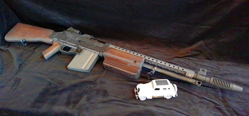

    Who would have guessed a generic heat shield would fit perfectly. Final "hard Use" Cerakote tomorrow and then final re-assembly and test firing.
    I prefer the period correct heat shield to the dimpled barrel and the time and money intensive alternative of replacing, cutting, and crowning a new barrel. I would also have had to redo the gas system and drill a new gas port.
