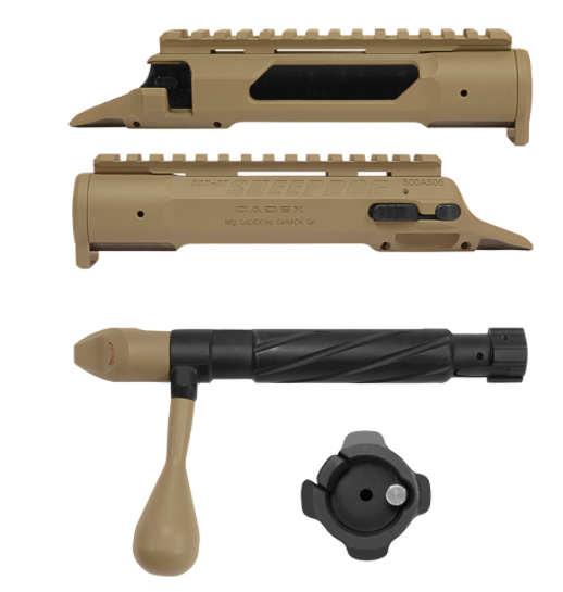

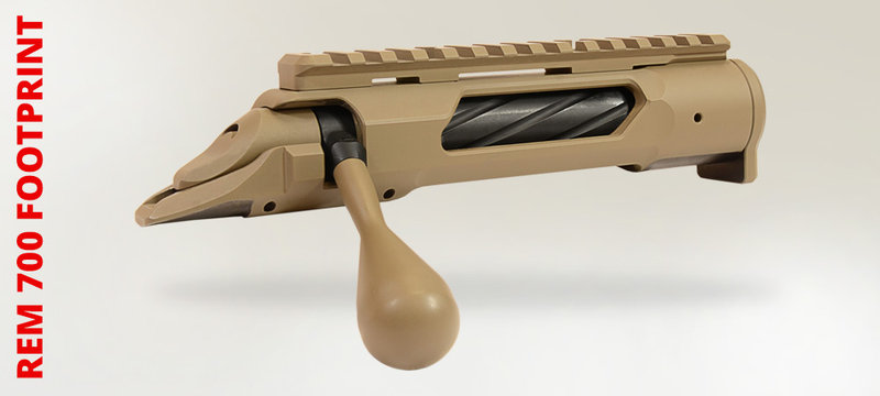

Soon we'll begin delivering our newest action, the Cadex Defence Sheepdog/Shepherd R7. Have you considered it for your next build? Here are the features. If you're interested in becoming a US Cadex Defence dealer or you would like more information on our products please private message me or send me an email at [email protected]
Rem 700 footprint
Deep laser engraved markings
CNC machined
Material: Stainless 416
Length: Sheepdog: 7.85″ Shepherd: 8.70″
Diameter: 1.350″
Thread: 1 1/16″ – 18 tpi
Receiver Rockwell Hardness : 41-43 HRc
Bolt to body fit: 0.002 to 0.004
.250″ hardened steel recoil lug
Stainless 0, 20, 30 MOA top rail
8-40 top rail screws
Heavy duty bolt stop
Unique top rail localisation system with integrated recoil lugs machined into the action top
Sheepdog Compatible Magazines: AICS DSSF 3.055″
Shepherd Compatible Magazines: AICS up to 3.850″ CIP
Compatible with Rem Style trigger
Tool-free bolt disassembly
Ejector: Rem Style
Cadex heavy duty extractor
Bolt Rockwell hardness: 43-45 HRc
Shroud with red cocking indicator
Operating handle: Multiple bolt knob styles
Bolt stop: Cadex design
Multiple bolt faces available that will fit: Bolt B .260 Rem, 6.5x47 Lapua, 6.5 Creedmoor, .308 Win. Bolt C .300WM . Bolt D .300 Norma/.338 Lapua
Spiral fluted bolt 4 lug with 50° bolt throw

Hows the bolt lift with a 50° throw?
Wondering this myself because there is no such thing as a free lunch. Either it's stiff, doing a substantial amount of cocking on close or the spring is not hitting very hard. Unless they have a very stiff spring being moved very little.
Would be curious to find out because I am kinda the engineering type.
