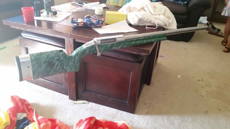

Finally got the stock from McMillan (6+ months). Just setting it together. The bedding is now drying.

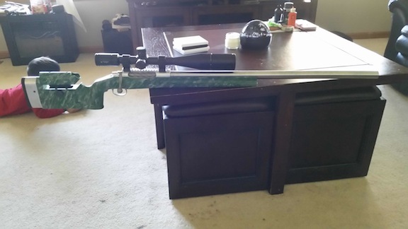

The gun is now complete. Now I need to find time for load development, but with next season months away nothing is pressing.
