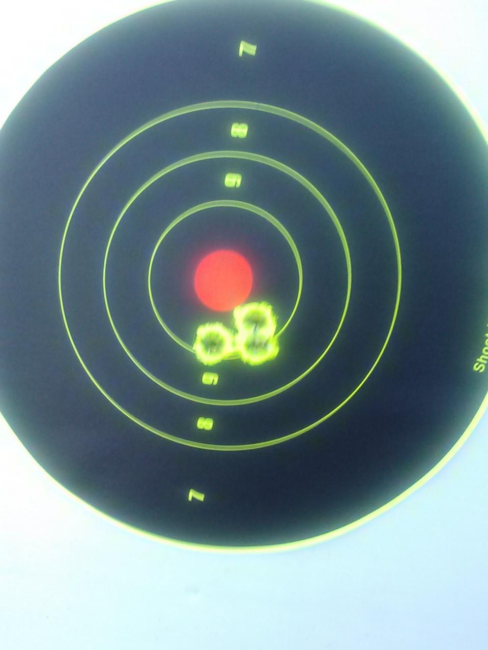

    When you can pull down M2 Ball from 1968, minimal trim to square up mouth, debur, charge with new powder, and obtain this at 200M:
    .519".........I would say that brings a lot of the obsessive "must do" variables into serious question, let alone using a concentricity gauge. No I did not run them through a sizer die. Most of the brass is pretty dinged up. I know, 3 shots, this was just preliminary testing.
    Yes I owned and used a concentricity gauge, a NECO. I sold it over 15 years ago. I probably bought more bullets and powder with the proceeds, a much more worthwhile investment. If you NEED a concentricity gauge, you probably need better loading equipment, a new gunsmith, or both.
    Yeah, I didn't care for the Neco either. Good shooting by the way. I'm still learning, so for now I will stick with what the benchrest guys are doing. I may not be that good a shot so far, but at least I won't be able to blame it on my equipment. My best at 200yd F-TR is not as good as your shots, but I am working on it with a 600-42X. In the meantime, I will also be striving to make the best ammo I can, using any trick that MIGHT work.
