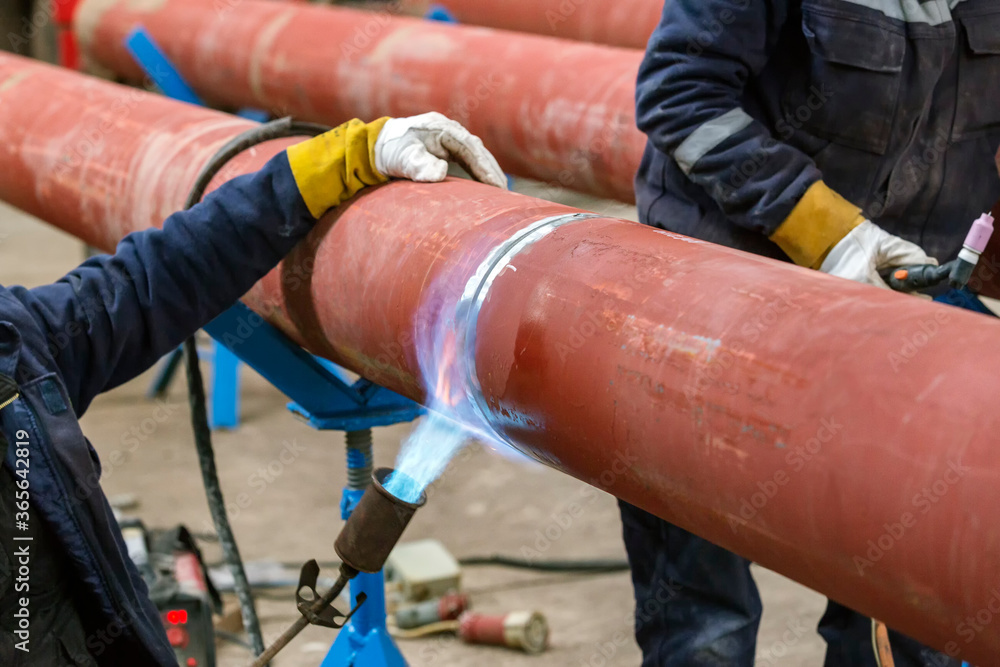

    Metal absorbs water. As a pipe welder, we preheated the metal and could actually see the water dripping off of the pipe. I'd suggest heating your weapons in a dry environment before heading out to the range in 20 degree weather.
    The hunter who is out in weather just has to work with it but usually that is a one or two shot situation.
    Look at the condensation cooking out of the pipe.
    LOL. This is an old wives tail that welders who don't actually understand what's happening have perpetuated for years.
    Steel absorbs almost zero water. What you're seeing on the outside of the flame is because the gas being used for the flame is a hydrocarbon. When you consume a hydrocarbon in a chemical reaction such as a flame, the byproducts are carbon dioxide and water. This leads to the incorrect assumptions of "sweating the steal" or "cooking the water out."

    LOL. You have no idea what you just posted is exactly what I said and has zero to do with "metal absorbs water." And condensation doesn't "cook out of pipe."
    Pro tip: "hydrogen embrittlement" is hard crystallization. And has literally zero to do with water inside the metal. They hydrogen you're avoiding with the preheating isn't the hydrogen in H2O. It's the hydrogen that isn't able to be released due to rapid cooling. Hence the preheat. This literally has zero to do with any H2O inside the metal.
    Also, in that picture you provided, the condensation on the pipe is actually a product of the flame. That's why you'll never see the "water cooking out of the pipe" anywhere else except outside of the flame. I.E. even if the other side of the pipe is the same temperature of the side you have the flame on, there won't be the condensation.
    Metal does not absorb water.
