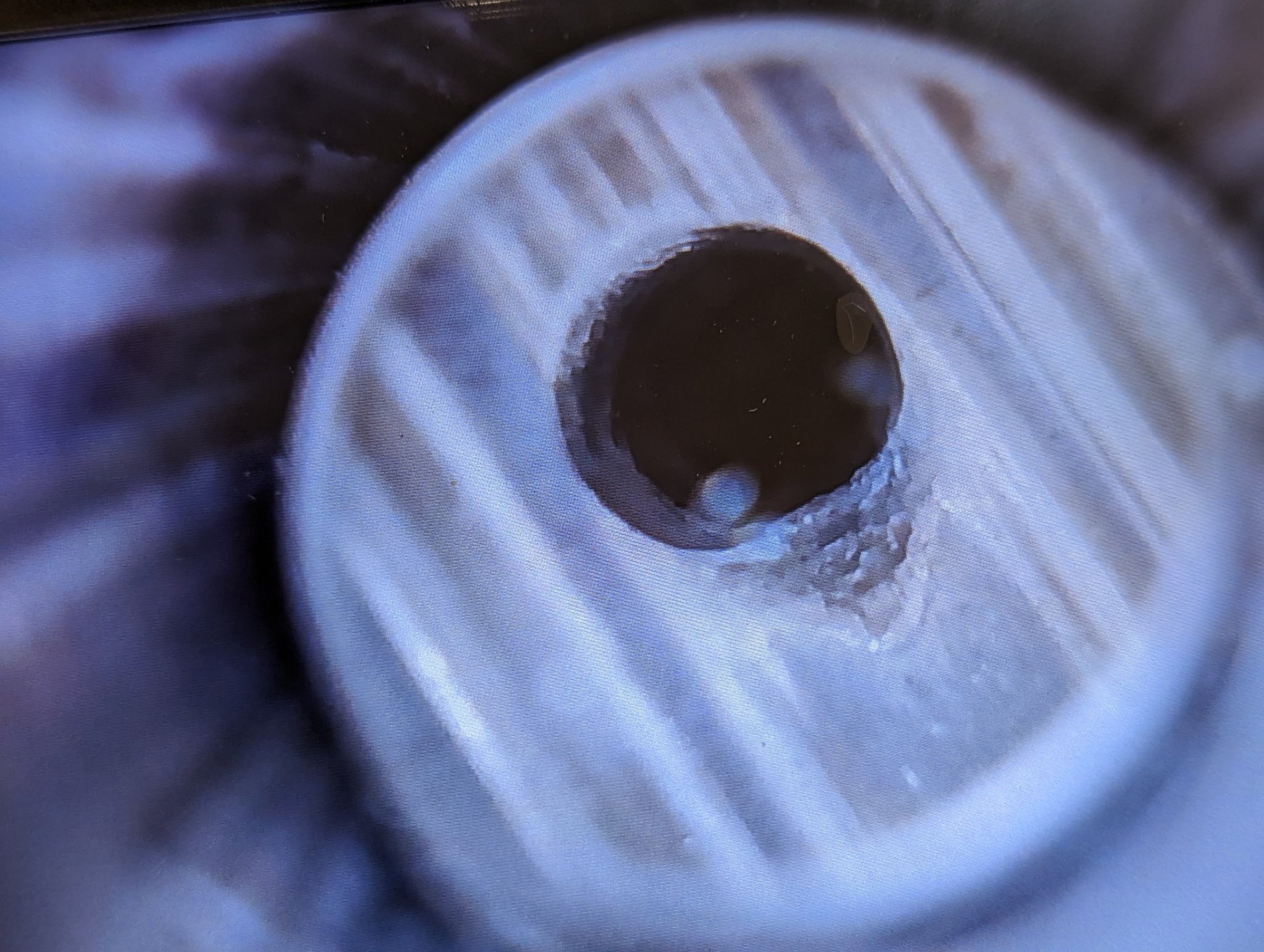

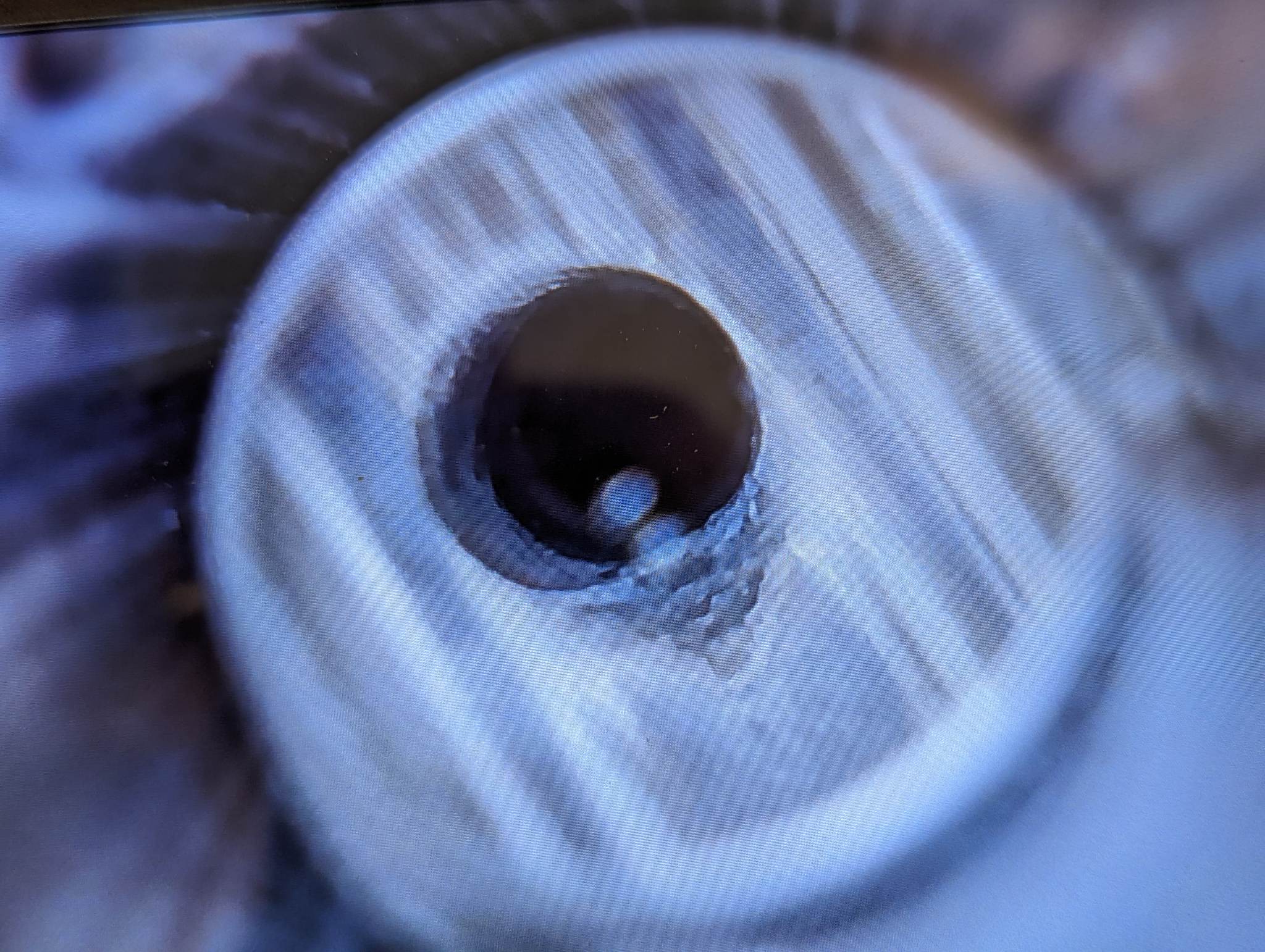

-Bore scoped barrel; confirmed that gas block is properly in line with gas hole.
At this time, I believe I've exhausted all likely options, and I don't think the Sprinco reduced power spring will yield any wildly better results than the JP reduced power spring.
Therefore, I will pursue opening up the gas hole and report back.

Borescope the barrel and make sure the barrel/block gas holes are lined up perfectly. It doesn’t take much to cover 1/3 of the hole if it’s not lined up just right.

Pretty confident it's aligned right; will confirm again using your method though. The CFE and Lever loads were worked up to from much lower in previous tests without the Magneto and weren't any better unfortunately. You're giving good advice for sure. But I have indeed been down that road.

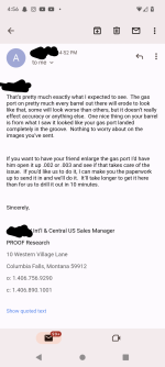

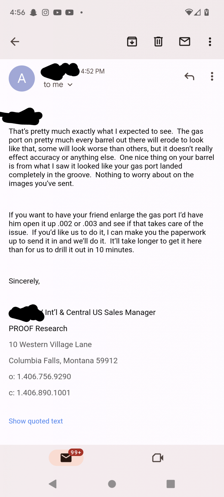

Thanks all, lots of good ideas and several different opinions here. I don't know the answers to all your questions but will test what I can and report back. Very grateful for all the responses.
Proof spec GP for the 20” rifle +1 gas 6 ARC is .093, basically the standard rifle length/Colt port spec for .223/5.56mm. It comes down to you are so overgassed that carrier speed is exceeding the magazine’s ability to feed the next cartridge or you are so undergassed as to be short-stroking; the symptoms of either condition present similarly.

UPDATE: I took a bore scope to it today to confirm that the block is aligned correctly.
It is aligned correctly, but I saw what looks like some large chipping/wear uncharacteristic of the low round count on the barrel.
Does this look right?
I've contacted Proof; they verbally told me it was normal but it sure doesn't look normal to me. I will be sending them the photos to confirm.
Eh, gas port erosion has a lot of factors.

**After scoping the barrel, my gunsmith saw what he labeled "a really concerning problem with your barrel." I've attached the image here. It looks concerning to me, but Proof's reassuring response seems reasonable. Just want to confirm that the "chip" wear doesn't look problematic to y'all.
