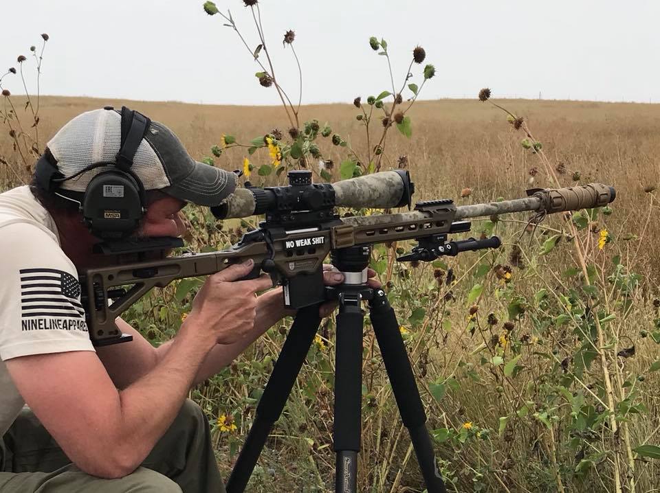

Yes I have a Tikka T3X CTR in .308, a Tikka T1X in 22LR, and I've been considering a T3X in .223 but didn't know they had a CTR, so I was looking around for the threaded varmint. Now that I know there's a .223 CTR that's very tempting. I have a sub-moa AR-15, but it's so filthy to shoot with my suppressor, that I haven't shot suppressed in years. The suppressor has been sitting in the safe... so I've always wanted a .223 bolt just to use the suppressor. I also ended up placing an order for my 308 suppressor.
If I had to start all over again... I'd get a Tikka T3X CTR in .223, and I'd get a Tikka T3X CTR in 6.5cm. I don't see any real reason for .308... train with the .223 and long range with the 6.5cm.
And the T1X for NRL22 :)

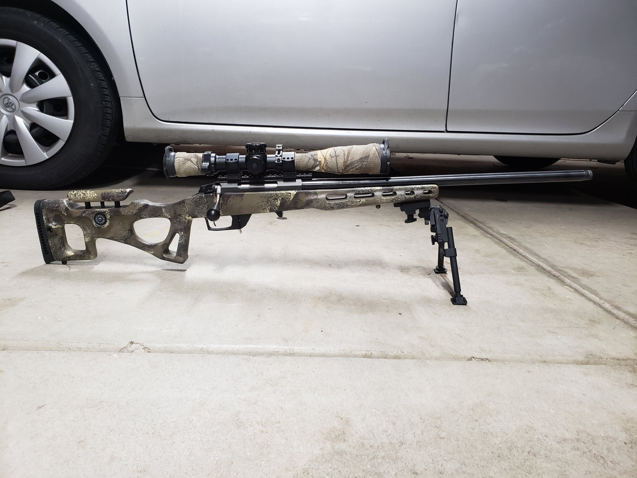

I have a 223 Varmint that I bought with CDI bottom metal fitted to the factory stock. I had the barrel threaded and worked up a load with the 75 gr ELDM. It is a hammer for sure, my favorite rifle to shoot. I load them to 2.49" to get .020" off the lands. My son has taken it out to 1400 yards and we took first in a Jim See team match with him shooting it.
I would like to see how long you can load in the 223 CTR mags before I would buy one. I do like my 6.5 CTR mags.

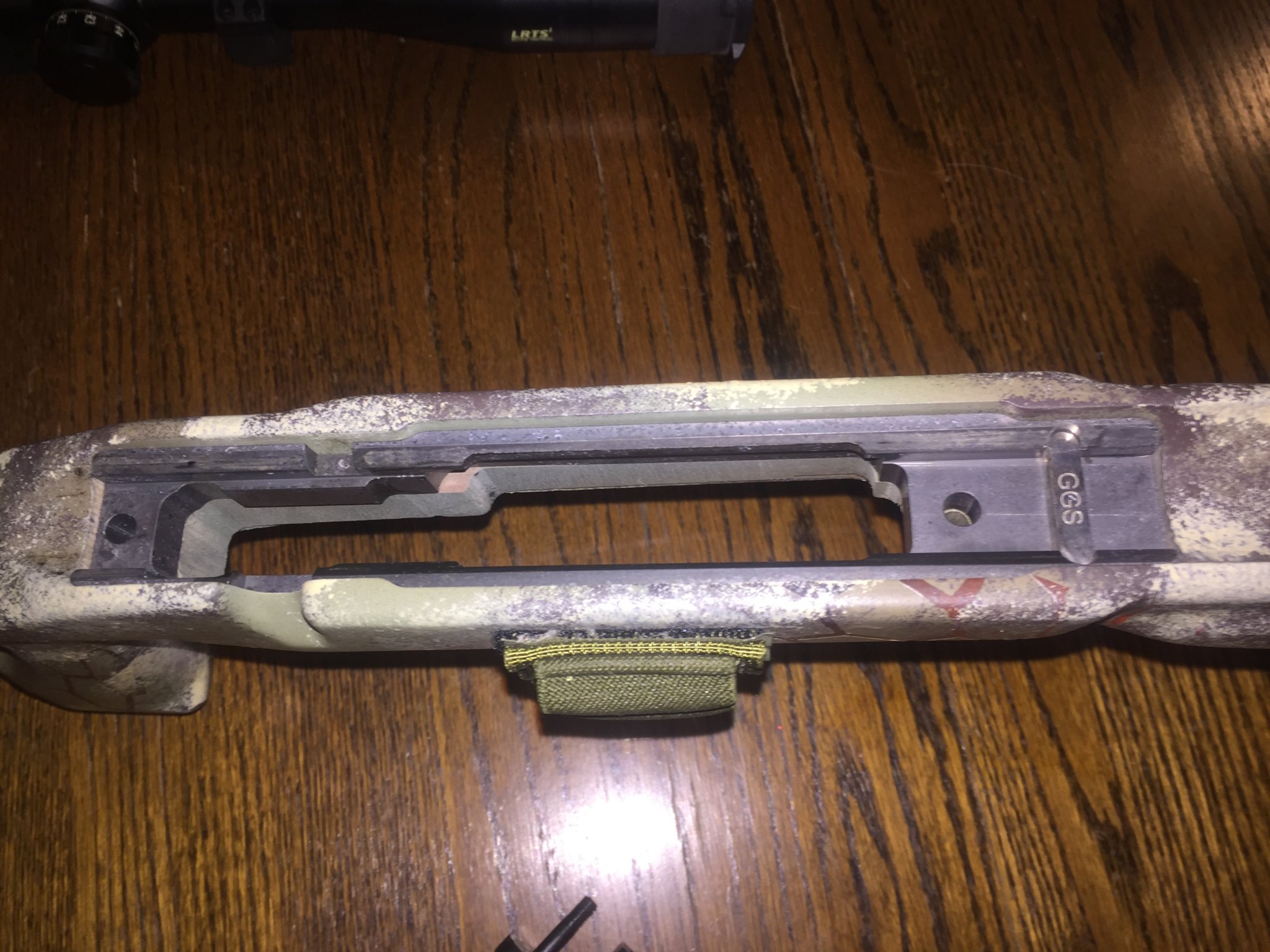

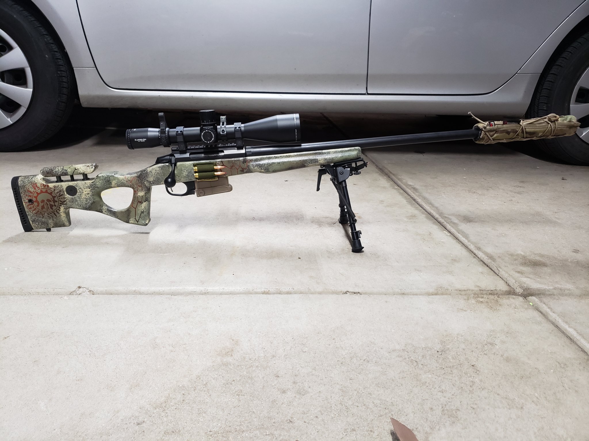

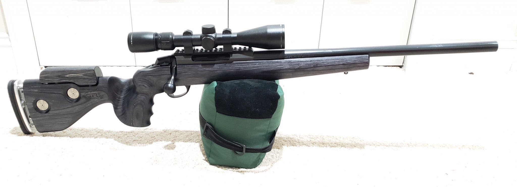

That is a German Gun Stock Raptor that my son picked up used. They have an aluminum insert with a stainless recoil lug. They are laminated birch in epoxy resin with epoxy paint. We both have their lightweight Rangers (2.4lbs) and I have a Predator.
Top pic is the varmint in a Ranger, second is my CTR in the Predator, third is the aluminum bedding block.
All the stocks have the CTR bottom metal inlet. My son has a 270 in a Ranger with the standard T3 inlet.

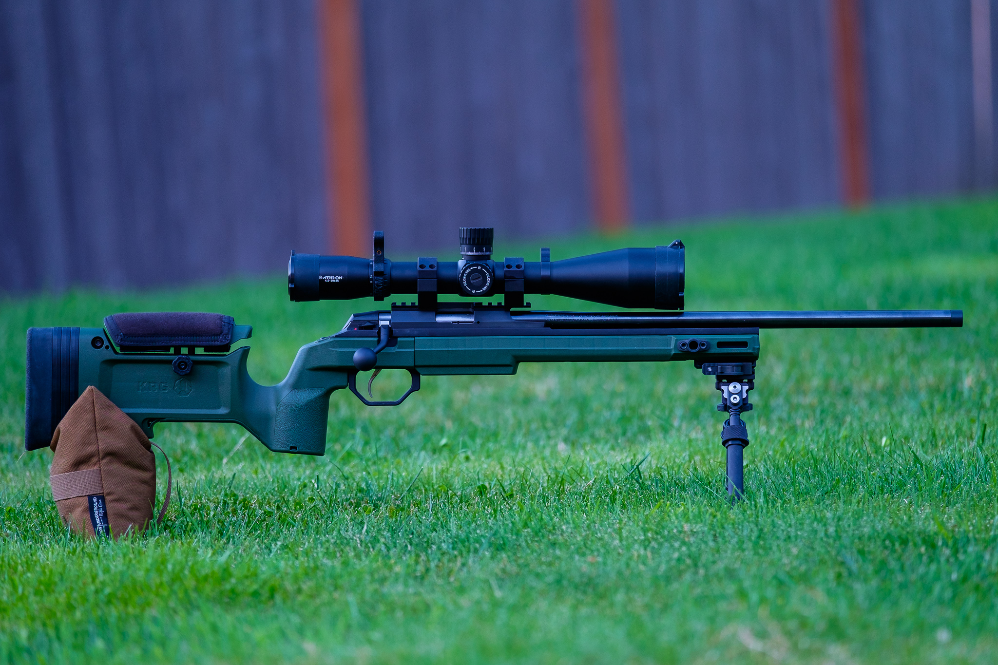

I couldn't wait for the CTR in 223 to become available, so I put together a CTR-ish 223 with the following:
-Tikka T3x lite 223
-CTR stock and bottom metal, you can find these for sale all the time in the classifieds
-CTR 223 magazine, available at Eurooptic
Runs great and drives nails

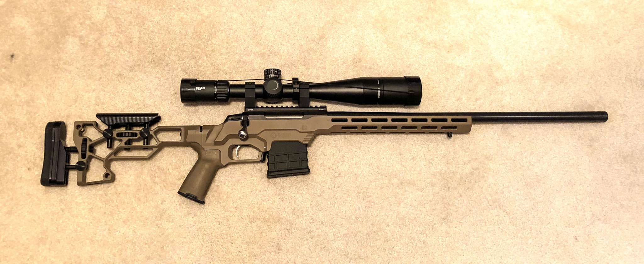

A CTR or Varmint in the Bravo stock would work. The Bravo ergo's aren't great but they aren't bad and acceptable for the price point. It also appears to provide a solid bedding surface so that eliminates the hassle of bedding. I'm satisfied with it on my Vudoo.
I can also switch over the forearm plate and bag rider from the Vudoo to the Tikka that way.

The GRS stocks are fantastic. I am amazed at how overlooked they are on these boards. Most of these chassis look like they have the ergonomics and weight of a brick. I guess most are for bench rest shooting, I hunt with mine. The GRS stocks are super comfortable and, to me, really reduce felt recoil. I know that's such an overused term, but the way the GRS stocks fill your hands and transmit force to your body just makes recoil feel much more comfortable. The grip angle works beautifully as well. It feels like a handful when you first try it but it quickly becomes more natural feeling than a normal stock.
The synthetic stocks require no bedding, they have pillars molded in and you tighten down to 5nm (about 45 inch pounds). The laminate ones only say to be bedded if you use magnum calibers but I bedded mine anyway. I watched a few youtube videos on how to do it and went to down. I kinda found it fun. I can provide lots of tips on bedding Tikkas in GRS laminate stocks.
I think your thought process is spot-on. I believe there really isn't much difference among the Tikkas, it's kind of their whole MO anyway. I did exactly what you said, I bought normal, cheap Tikka T3x Lites and customized them myself. Get a Varmint with the $75 rebate going on now, get a GRS stock from Eurooptic (they just cut the prices across the board), and if you want, send the barreled action off to LRI for Cerakoting. You'll have a weatherproof, semi-custom rifle with fully adjustable ergonomic stock for less than other people are paying for just a receiver. I bet it will be less than a 3/4th MOA shooter, too. Maybe even a half.
Here's a picture of my T3 Scout 223 in a GRS Hunter stock. Pillar bedded myself, 1/3 MOA all day.
-Stooxie

Thanks for the detailed input and confirmation of my suspicions. The cant and contour of the GRS grip looks very comfortable, more so than my KRG Bravo. Where do you position your thumb on the GRS?
One thing I like about laminated stocks is they are easy to custom contour to your own hand. I have Devcon Steel Putty in stock and a can of Spruh Konig which makes spot finishing easy. The Boyds Pro Varmint my Savage Bmag sits in required heavy modification to obtain a comfortable grip, though its the most comfortable grip I have now.
Compared to the Varmint, the T3x Tactical and Sporter appear to be not much more than stylized marketing hype.
The Varmint with the GRS which adds quick cheek riser and LOP adjustment with a natural grip position makes the most sense. The worst part is the GRS Hybrid is backordered 3-5 months, but EuroOptic's price is hard to argue.
The GRS laminates use aluminum pillars right? What about the recoil lug fit? I'm assuming the GRS laminates are actually milled parallel to the bore compared to my Boyds stock that I spent hours on squaring and cleaning up sloppy machining. Thankfully I have a small manual mill that makes mods relatively easy.

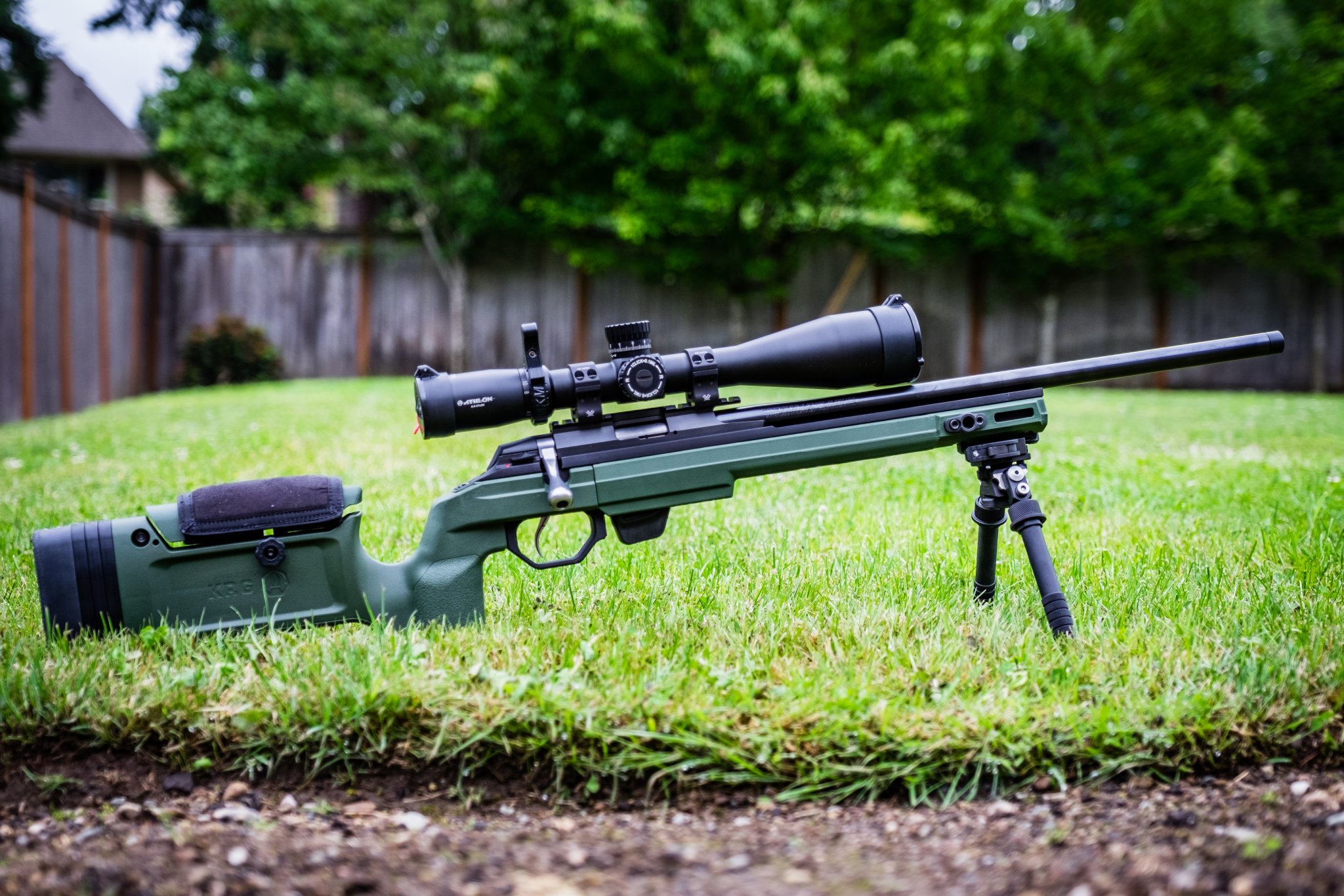

I'm a little late to @Sieg's party here, but fwiw here's a photo of my .223 T3X Varmint in an MDT LSS-XL gen-2 chassis with MDT skeleton buttstock. Scope is a Vortex Viper PST 5-25x50 on an MDT 20MOA rail.
I don't handload .223 yet because I have quite a bit of .223 factory ammo on hand. The rifle definitely likes 69grain SMKs as loaded in Defender Ammunition's match rounds; these will group into 1/2" @100 quite consistently. I've gotten 1.5" groups at 300 but I don't shoot paper out that far very often.
After this case of 69gr SMK supply is gone, I have several boxes of Defender's 77grain SMK in their 5.56 loading. I've shot maybe 40-50 round of it as a trial and it seemed to be as accurate as the 69grain with similar velocity as the lighter bullet. Of course, it is widely known that 5.56 ammo is loaded to higher pressure than .223 - but the reality is no one handloads .223 to factory pressure anyway. I see absolutely no pressure signs with the the 5.56 round.
The rifle, so far, has not liked any 75grain loading I've tried in it at all. The loads tried so far are all 75grain Hornadys, one the HPBT in Hornady's no-longer-available Steel Match loading and ELDs in two buddies' handloads that are 1/2"@100 rounds in their rifles. None will keep even 1" groups in my rifle.
I haven't been shooting this rifle much because I've been working with my Vudoo and my Stiller-based 6.5CM so much. The latter two rifles are in MPA BA Comp chassis; I've come to really like the vertical grips. The MDT LSS-XL chassis has a usable thumb shelf which works with the AR grip in place now; I like the MPA grip better, but as I recall the MPA grip doesn't fit the MDT chassis quite right. Not sure how I'll upgrade the grip; I'm not a fan of the MDT vertical grip (to be fair, I've not had a chance to put my hand on one).
Finally, of course, if/when I shoot this rifle more, I have to put a grown-up bolt handle in place of the dinky little factory nub.
Anyway. You won't go wrong with the T3X Varmint accuracy-wise.
