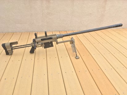

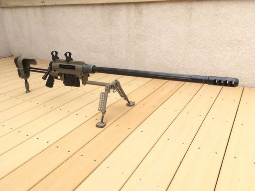

Big ol' piece of metal came in today. Could bust some skulls just swinging the receiver around.
Debating if I want to go through the hassle of actually shooting the thing :rolleyes: mostly finding some 408 and then driving a while to get some decent range.
May just throw it up for sale and shop around for a proper M96 versus the M98.
Definitely a sweet ass gun though.
