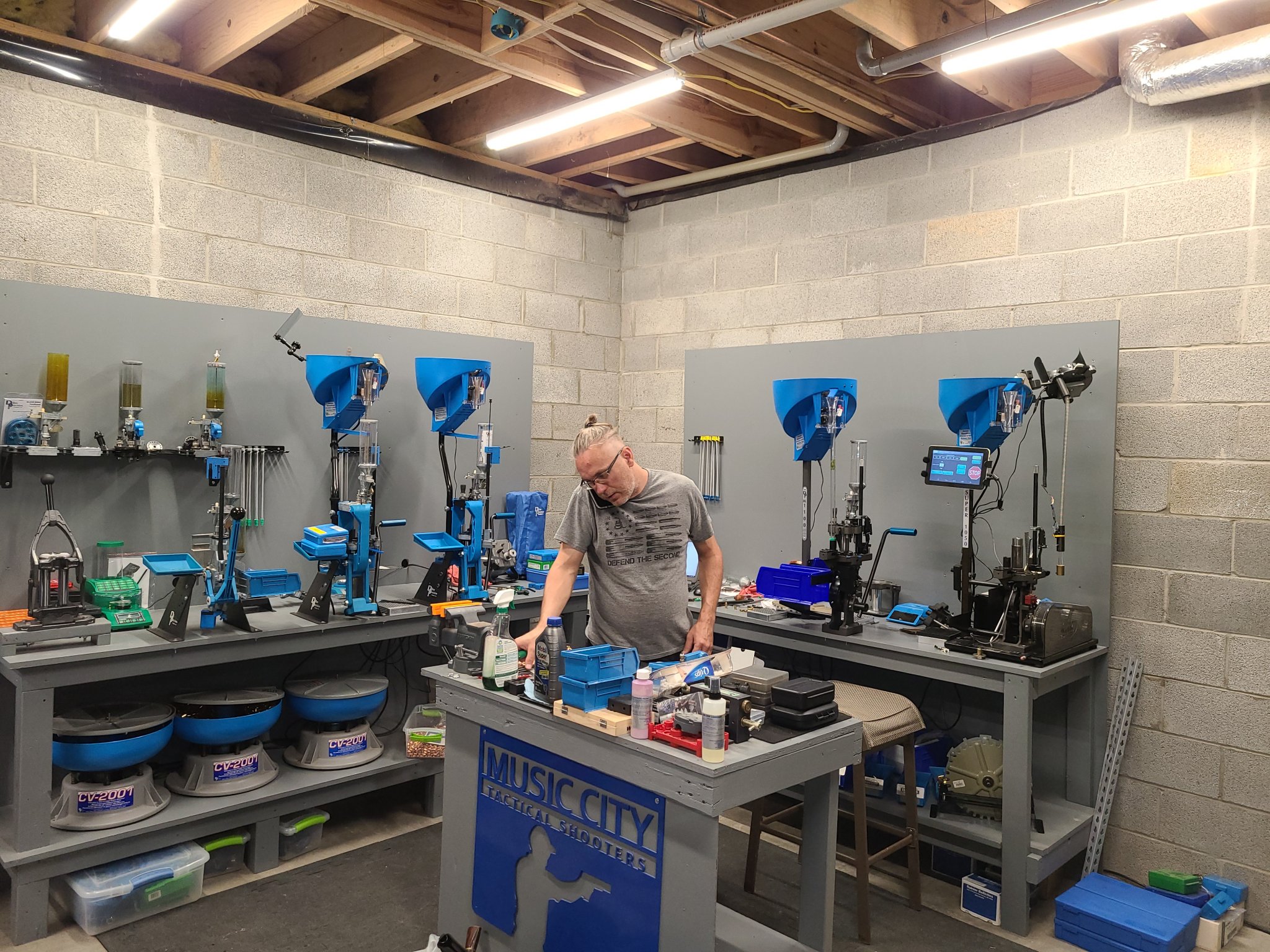

    the 2 machines on the right side is an 1100 and 1050 with auto drive.
