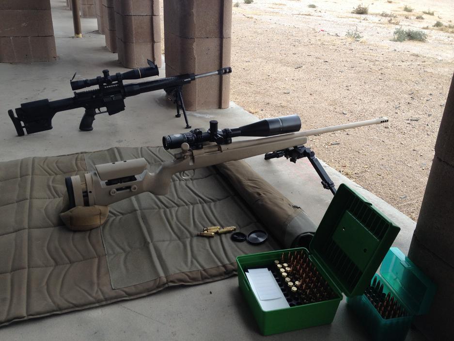

It'd be a cold day in hell before I'd go with a straight cylinder heavy bbl for anything but an unlimited BR rail gun, or something like Frank's F-class rig. Rem sender/varmint or hvy Palma is as heavy as I want to use. Just finished a 260 Imp 30* on a Howa SA, with a 26" Krieger sendero contour, PTG DBM, McM adjustable A5, Sightron SIII 6-24x50 in TPS TSR aluminum rings on an EGW aluminum 20 MOA sloped rail, Harris bipod, and it weighs 14.3lbs empty. This is my 2nd 260 Imp 30* - first one is on a SA 700, everything else the same, but with a Bushnell HDMR 34mm ERS in Seekins rings & NF steel base, Harris bipod - weight 14.7lbs. I put a Harrell's tactical brake on the Howa, and have a TB 30BA brake/mount on the M700. Recoil is very comfortable with the M700; haven't shot the Howa yet, as I just finished putting it together last night.
