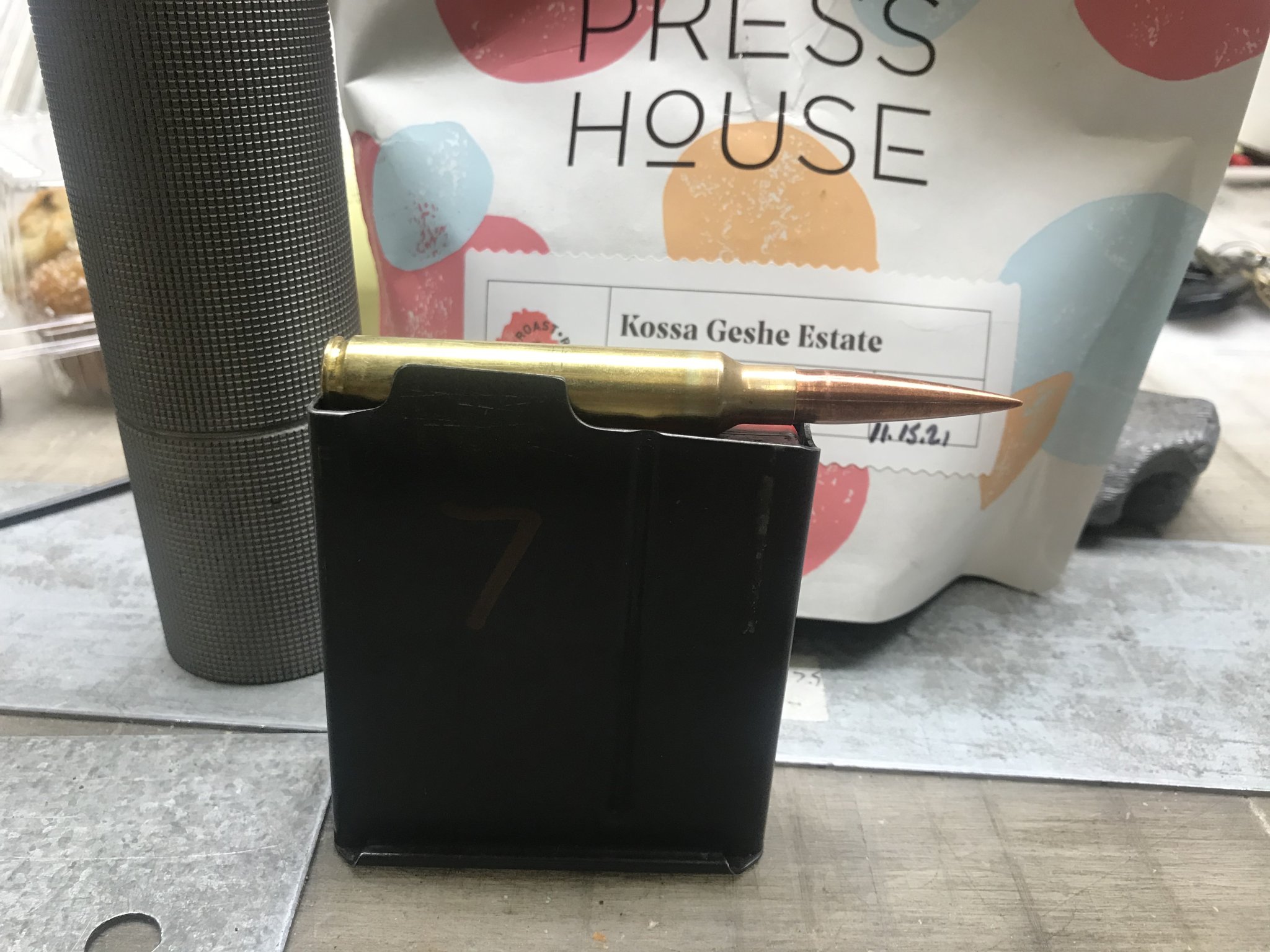

I have a magazine for my 375ct but have never used it as all the bullets I have tried are not even close to fitting. I think the only bullet that would fit would be the 350 SMK which I don't use as I am set up for solids.
Reactions: Steel head
Holy hell that’s a round right there.
