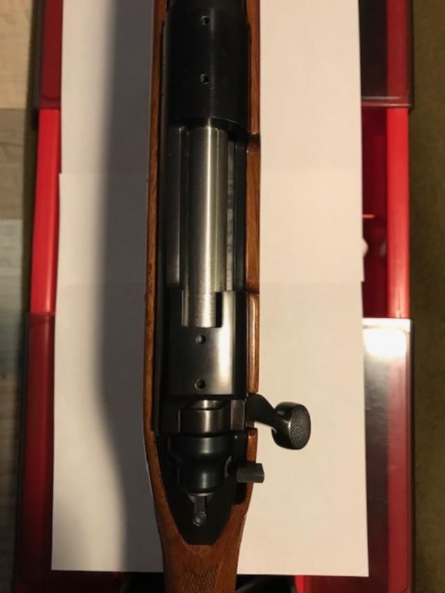

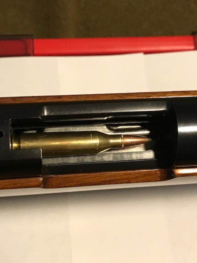

If you can rebarrel to a 6 creed then you can rebarrel to a 243 as they both use the same bolt face. Do you know if yours is a long action? I believe I read somewhere the 6 remingtons were. If that's the case, it's probably best you stick to long action cartridges.

I added a couple of pics of the action, I don't believe this is a long action, that is a 243 round. Charlie112
