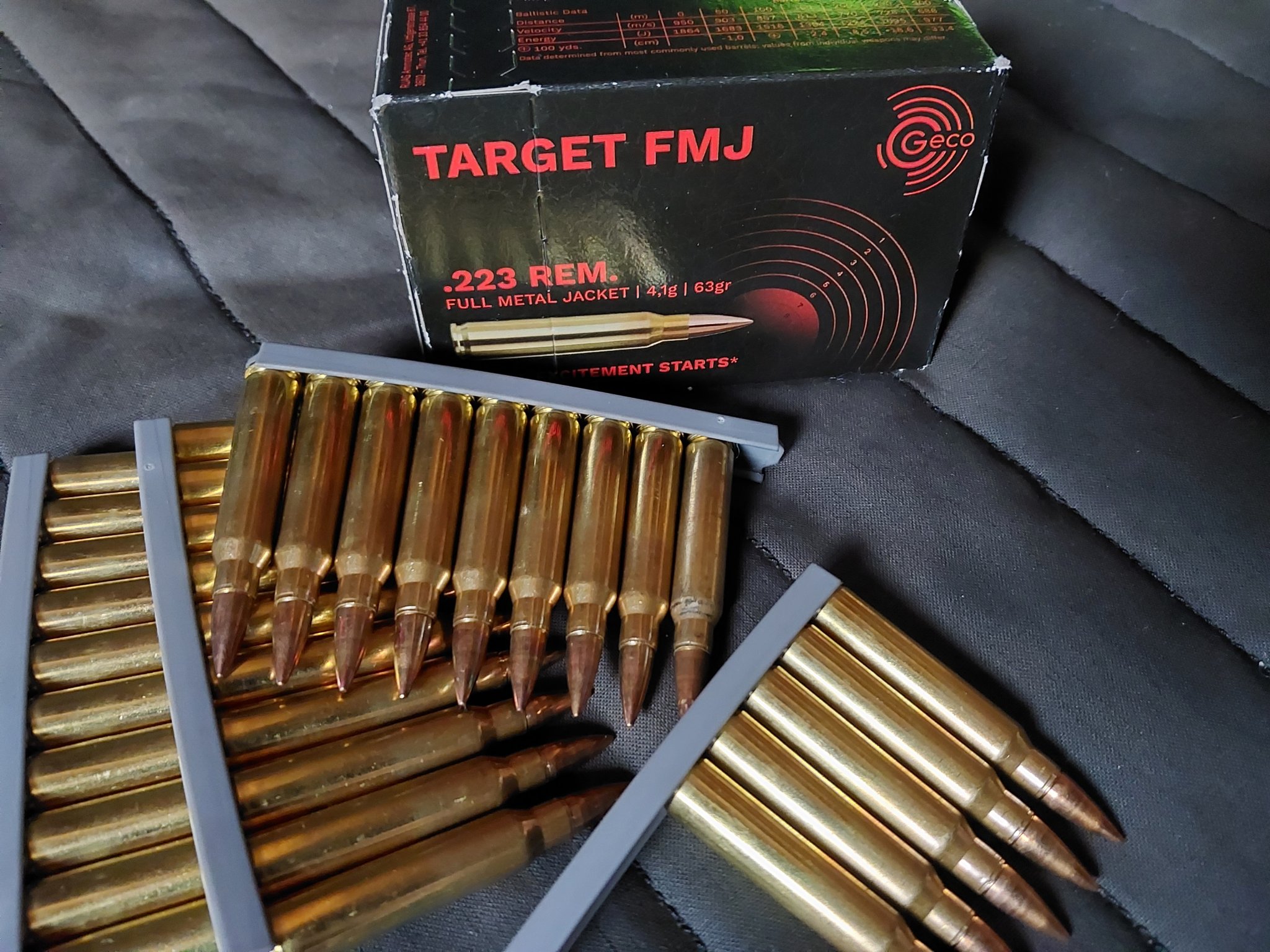

I have one ammo that's relatively cheap and gives really tight groups on paper... Geco 63gr FMJ "Target", comes on 10rnd plastic stripper clips. Now what worries me a bit is the fact it's steel core with a copper jacket. What's the hive mind's opinion on steel cored .223?
Rifle in question is a HK MR223 with chrome lined barrel. I don't want to destroy this by being "cheap" with my ammo. But it's the best ammo i found so far, so if there's nothing to worry about that would be sweet. But i lack the long term experience....
Any thoughts? Thank you!

Copper jacket is a totally different thing then copper washed jacket.
You'll be totally fine. Have you checked it with a magnet or cut a projectile apart?
Copper jacket, steel core, no problem.
Copper plating, steel jacket, reduced barrel life.
I haven't run the numbers for nearly a decade, but last time I did the savings in cheap steel jacketed stuff bought a new barrel 3x over by the time you wore the first one out. May be different with today's prices and an HK rifle.
FWIW , I don't think your mentioned 63gr ammo is steel core, or even steel tipped ( like the SS109 / M855 bullets. )

I investigated further - and i was wrong. It's indeed not steel cored. It's lead cored with a copper plated(?) soft steel jacket. My bad, i based my assumption on taking a file to the bullet. The copper plating seems pretty thick, but it's definitely a steel/iron jacket.
I'll stop shooting this stuff. The barrel still shoots nice and i'd like it to do so as long as possible.

Did you ever put a magnet to the bullet ? Just curious.
Seems pretty odd that GECO / RUAG still produces any .223 / 5.56 with steel in the bullet.

That wont wear out any faster then standard jacketed ammo

How much per round? Also you have a CL/CHF barrel, a thousand rounds of this ammo wont hurt. But if you don’t want it, I’ll pay for shipping!
Yes, it's an iron/steel jacket. From what i gathered by doing some google research, this Geco 63gr ammo is basically identical to swiss GP90 (or Gw Pat 90) which was the swiss variation of the 5.56 NATO. With a 63gr bullet.
Apparently this ammo was issued with a nickel plated iron jacket until '97. And from then on with a tombak plated iron jacket. The nickel plated ammo apparently is known to cause premature wear (and swiss Stgw90 barrels had a ""coating"" to make use of this nickel plated ammo) But it's always lead core. This also explains the stripper clips.
And i bet you that the Geco ammo is just rebranded swiss surplus GP90. Geco is part of RUAG Ammotec so this would make a lot of sense. But i don't know for sure, it's just an educated guess.
it's about 60 cent per round. That's euro cent. And i'd need an export permit to ship across the atlantic.

It wouldn't surprise me if it is very similar to the RUAG Swiss P 63gr load. Is your 63gr bullet a boattail ?

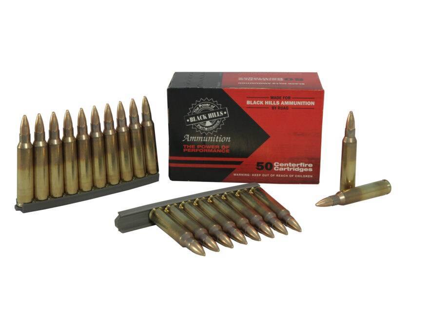

FWIW... GECO / RUAG even loaded some 55gr FMJ for Black Hills ammo, way back in an earlier ammo shortage.
Same packaging, same plastic stripper clips, GECO headstamp... but with a different powder charge weight and a different propellant in the Black Hills load.
I still have a 50cal can of it.
Note the "Made for Black Hills Ammunition By RUAG"
