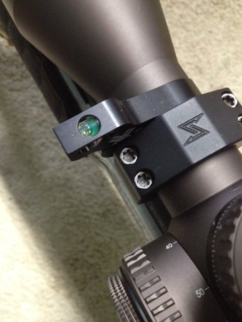

    I see a little difference in the Bubble level on the Spuhr...the ARC rings have none...but the MPA has one built in as far as that goes...and there's aftermarket options people like such as the flatline ops Halo-X...I'm thinking it's whichever one works best for not taking your eyes out of the sight picture...but I've not experienced any of this yet. Another consideration I caught in a thread was the set distance on the Spuhr was a little cramped to some between the front ring and the rear one...and possibly obstructing a clear view or the turret /shrug...again no experience to know if any of that really matters/happens or is it mainly nitpicking.

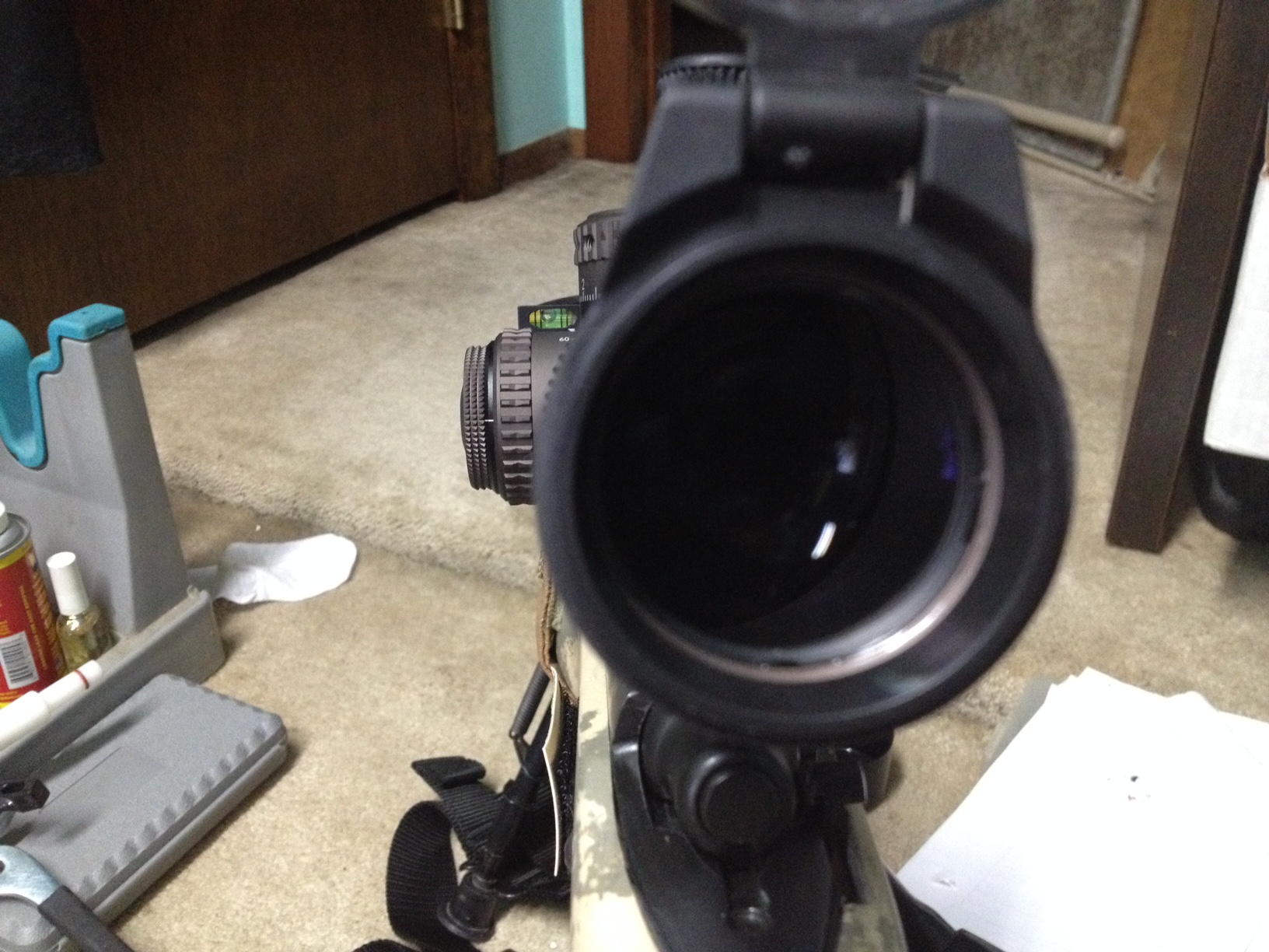

    I wouldn’t want a bubble level on rings anyways. Same for base. I like my level on the scope so I can make sure both are level and it’s easy to see right over the parallax knob. The Vortex LoPro level sits right there. Will look on my computer for a pic.
    Yeah please if you got one.

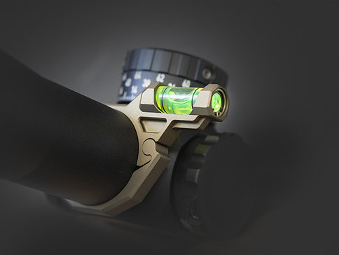

    Check out MK Machining for the level. great stuff and active here.
    Doh...might be a little late this time around...but I'll certainly look...I've got another rifle I want to get modernized and up to speed for some possible hunting...it's my dad 30-06 👍
    Yeah those are nice too...I like the way the fastener head appears to have been positioned where it lines up vertically with the bubble when level...pretty slick...I'm assuming that was intentional...gives the eyes an additional reference for being level that it naturally sees even small variations in...nice !!
    Look at the Vortex LoPro on my scope above too. Only $49 and work. Come in 1", 30mm and 34mm tubes.
    Yeah those are nice too...well I'd rather have choices than not have any...probably going to have to try different ones out along the way 👍
