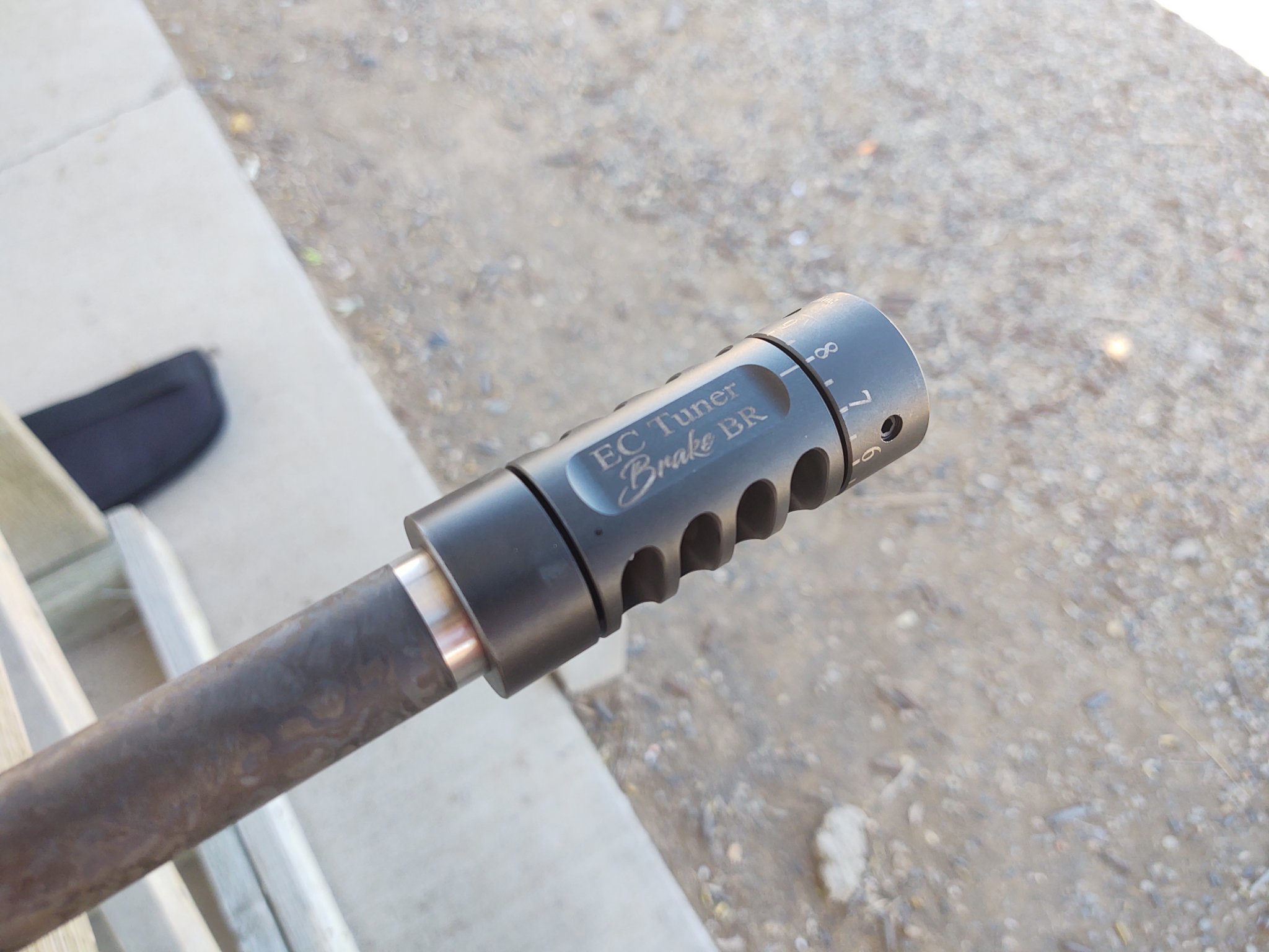

    Just a quick and dirty review of the Cortina Precision EC Tuner.
    I'm running a Custom Seekins Precision SP10 with a 24" Proof Research Carbon fiber Barrel and a American Precision Arms GEN3 Brake Average accuracy I'm seeing is around .70-.75 MOA with any of the Hornady Match box ammo.
    Decided to Give the EC Tuner a go and have been thoroughly impressed.
