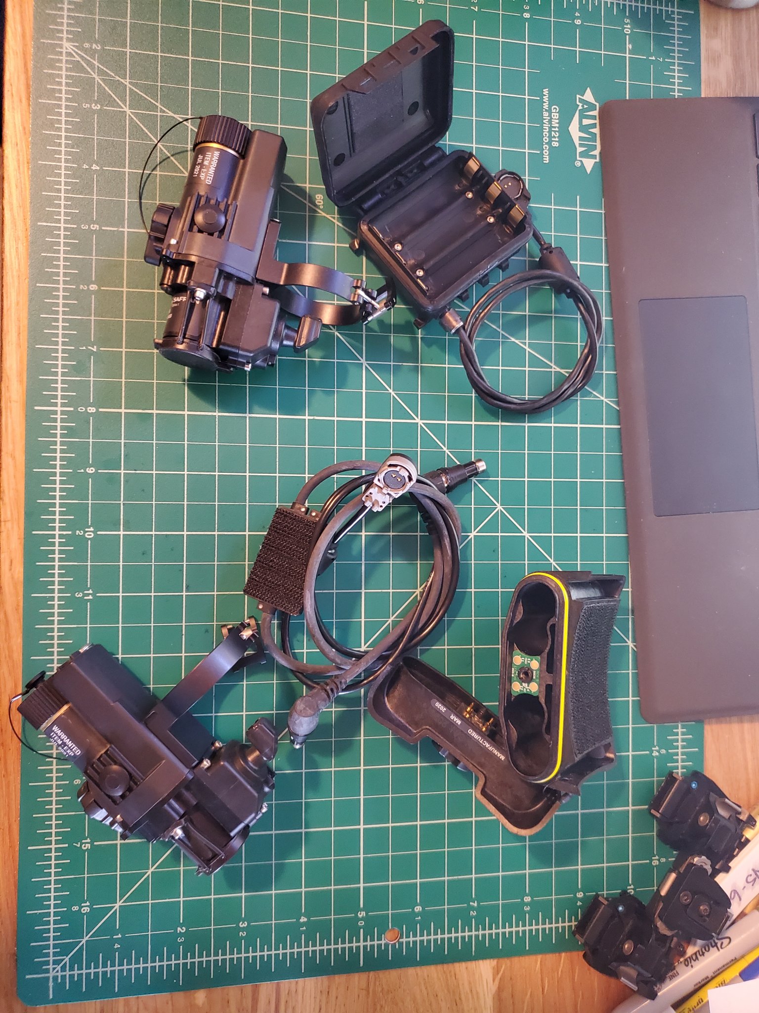

So I've been looking for a pas29 coti battery pack...
The old coti and the ecoti use a different connector, right?
I feel like this is one of those situations where a 3d printer could be really helpful.
Has anyone had any success making their own connectors, or sourcing connectors?
Or does anyone have a pack around they are willing to part with?
To be clear, I'm not looking for a y cable...I just want to power the coti
Oh... or if someone could make a coti to Fischer adapter... that might be cool

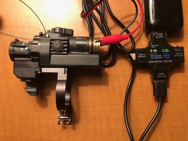

16650 comes off battery charger at 4.20 volts. Too much voltage for COTI. There is no way to step the 16650 battery down to 3.2 Volts.
3.2 Volts is where you need to be for COTI. Warning label on COTI says Max Voltage 3.5 V.
When you come off of the Anker battery it is at 5.18 V and you use a step down buck regulator to step it down to 3.2 Volts.

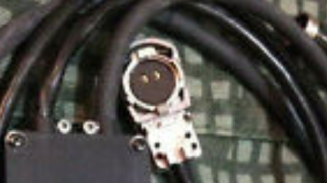

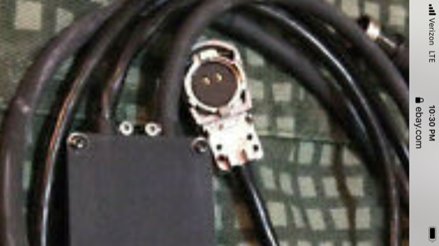

This is the latch type 2 pin connector that fits the Pas 29A COTI's.

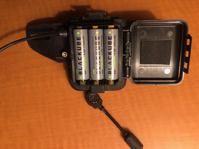

Is there an issue with using rechargeable AA batteries?
I tried to run some high quality AA rechargeable batteries in a OEM Battery Box and Cable and they will only register 0.80 volts coming out of the end of the cable.
The positive and negative prongs at the end of the cable are so small I am not able to attach the positive and negative of my voltmeter and at the same time have my 3rd hand take a photo. :LOL:

I just put energizer rechargeable batteries in my pack and they worked fine. I didn't even think it'd be an issue. Should I not have done that? I haven't had the time to use it for a length of time to test the run time.
Is that will the same exact OEM battery pack as above which has the snap on fitting or with a different set up that has the newer style latch fitting that attaches to the Pas 29A COTI.
I bought it off of Sierra Lima. It's the top battery pack in the picture.
Jong, yours is the same plug as the one wherenow&how in his pic.

Yes, Sierra Lima is correct. It is the same exact as what I showed in the picture. The Blackube rechargeables do not work in it but they do have the rechargeable micro port in them and I have seen them do funny things in other devices as well. Might need to try a different rechargeable AA in that OEM Battery pack.
The energizer rechargeables have worked fine so far, but as I said I haven't had the opportunity to use it that much. I will be using it a lot in June but the batteries will be provided by Uncle Sam so will just use those batteries.

I have been looking as well for that coti plug, I think NHPiper is our only hope on finding a source. Will let you know if I do, and i will let you know once I finally get around to that little project we discussed. Im way behind on doing one for NHPiper/Skyscraping but my work should be slowing down very soon and give me the time I need

Yes, that appears to be correct per my voltage testing of the regular Pas 29 COTI battery pack and cable that hooks onto the external port. Apparently it must have a step down voltage regulator attached to it.
I do not think that the internal battery bay is also attached to a step down voltage regulator. Not 100% on that as I have not had the balls to insert a 4.2 V RCR 123 to try it out and possibly fry a unit.
