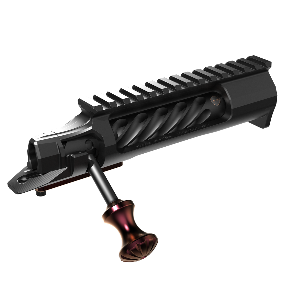

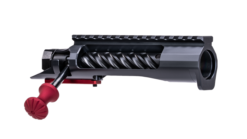

I am new so this will be my first Post worth anything well, Maybe just conversation..
I bought 3 of these. I naturally shoot left handed but being I just joined and had not planned on buying anything this was a last second purchase to ay the least but I feel good about it either way.
1- 223 cal
1- 308 cal
1- 308 Left Handed
I figured I need a nice bolt action rifle.. (actually have 4 safes in the garage full of them) I didnt have any Precision type guns per se.. For Fathers day I got a Ruger Precision in 308 as I figured it would be cheaper to learn on it vs a 6.5 Creedmoor .. My plan was to change the barrel out later and so on... I bought a Vortex Scope for it.. VORTEX Viper HS LR 6-24x50mm XLR Reticle 30mm.
I had neck surgery (this Aug will be 2 years) and I have not recovered yet C6 back in 2020 and C5 and C7 the last round. I am still having issues in my back and shoulders real bad so I havnt been shooting at all.. The Ruger looks a little dusty but still nice ;)
So While I wait for my body to heal I figured I might as well plan. Definitely going to build a left handed rifle with this Action.. but I want to build the 223 first then the right handed 308 and then the left handed one.. Maybe I can learn on the first ones and really bring it home on mine.
SO, what would you or are your plans to build? I am not familiar with any aspect of a bolt action but have been Reading (Gucci posts lol). Just kidding.
What Chassis?
Barrel?
Grip and so on... Lets do a couple options..
#1 No limit on money (how would you build it and why)?
#2 A medium budget build ( meaning it doesnt have to be the best of the best) just function.. I do not want to upgrade anything later if I dont have too so I would rather do this one time ( or 3 in my case).
So what would you do or for those that have bought one of these, what are your plans.. Again I have no real experience in bolt actions... but I have build a few Ar15.... SO this will be fun for me and I will pass these down at some time..
EDIT to add I like the Precision chassis so that is what I am looking at... XLR Envy looks nice... Or something close to it.
Thanks guys (and gals).

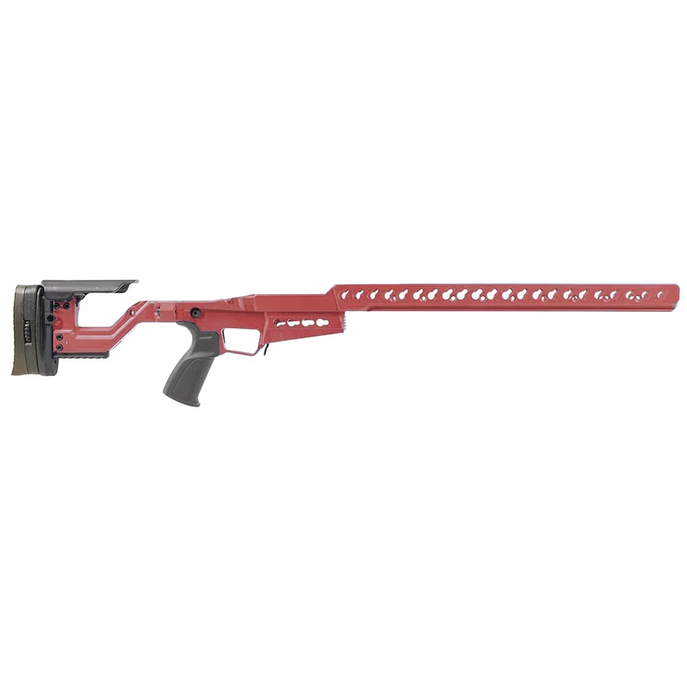

Looking at the
Accuracy International AT-X AICS Rem 700 Short​
I want a red color I think... any issues with trigger hanger or magazines on this chassis the with the ARC Grace?
I have it in the cart but wanted to ask before purchase..Also notice the bolt handle area is not cut out.. can this be made into a left handed? If so maybe I will get two of these

Looking at the
It does not look like it supports left handed actions unfortunately.
I bought 3 actions ..Lefty will be the last delivered me thinks. I put this in the cart and got busy and when I went to finish the purchase I somehow lost the website... So I will get back to it in a few days..
