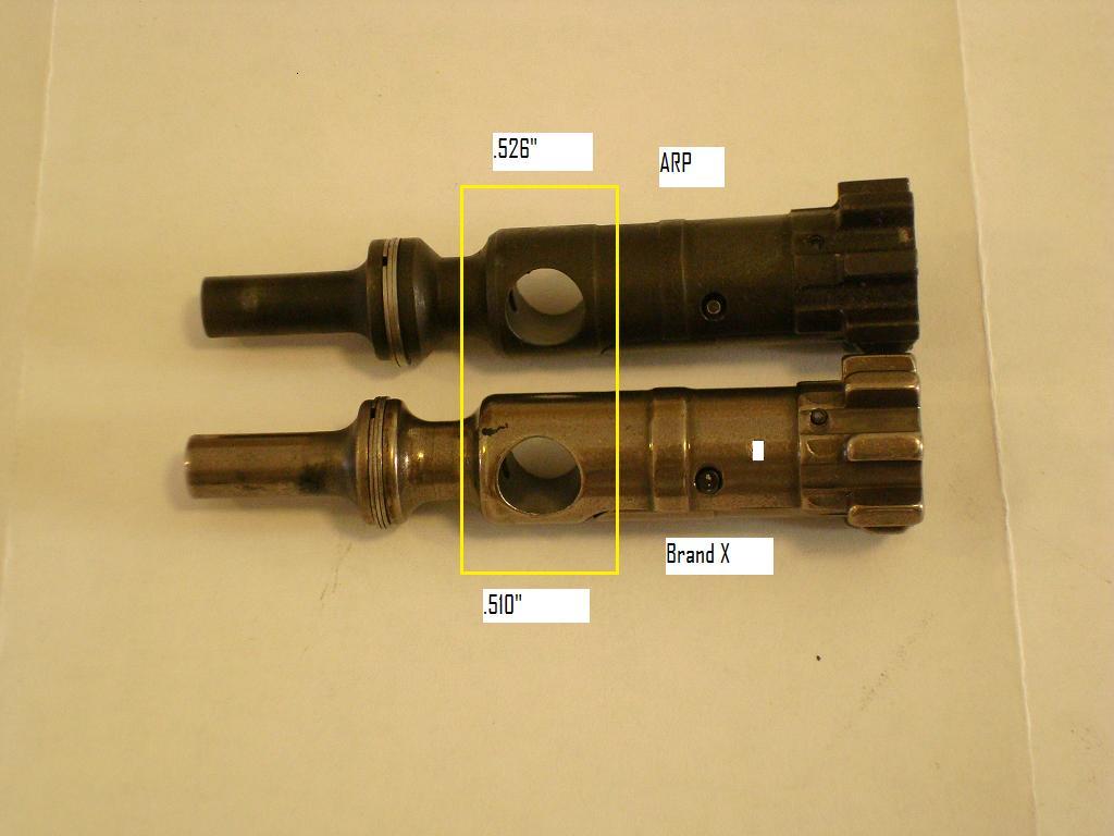

The 5.56 and 6.8 superbolts we sell made by AR15 Performance have that area beefed up to help with the issue seen here. They have a .526" band around the cam pin area that most don't. I have a new digi cam on the way and will get some better pics later...
I don't see any markings on the bolt indicating MP inspection (maybe they're present but not shown), and the surface finish of the body OD in the vicinity of the cam pin hole leaves much to be desired. I normally wouldn't get too wound up about tooling marks, but man, that's a terrible spot to be leaving a bunch of "crack starter kits".
