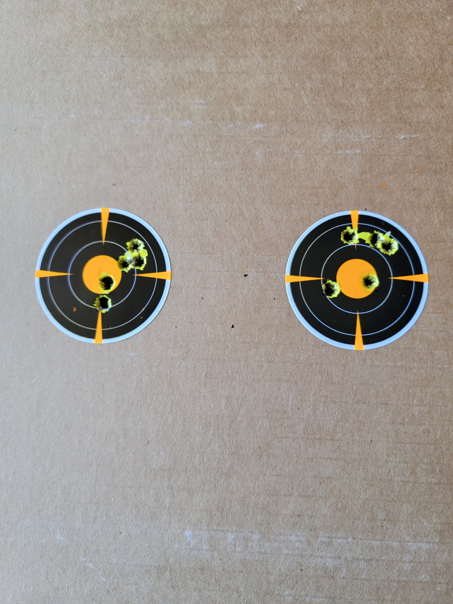

I have one in 22 arc, just started playing with 80 VLD's
I would try to shoot 80.5gr FB, 85.5gr hybrids. I have had a lot of issues trying to get VLDs to shoot well out of my 224 Valk and 6arc. Basically gave up and settled into 105gr BTHP, hybrids and those 80.5gr bullets.
I've got some 85.5's coming, but I've never had trouble with vld's, actually prefer them to hybrids. It'll get tighter, I just started with em today.

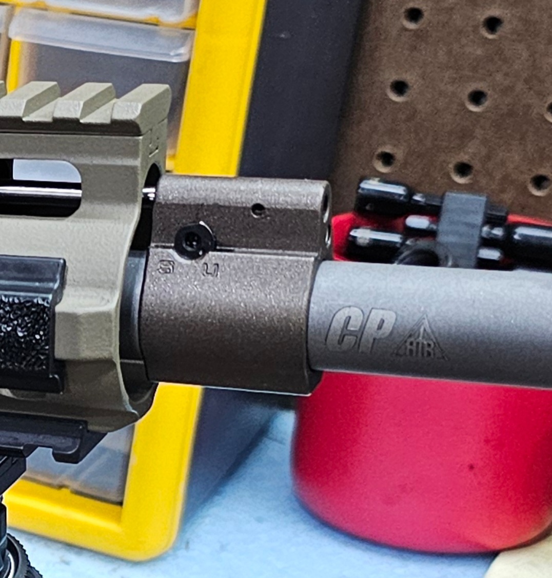

That Sir is a 14.7" Craddock Precision RTR 6mm ARC Barrel that has a Precision Armament Hypertap pin and welded on.
14.7" 5R Rock Creek Button cut Barrel/ intermediate Gas System / .750 Gas Block Journal/ 5/8x 24 threads.

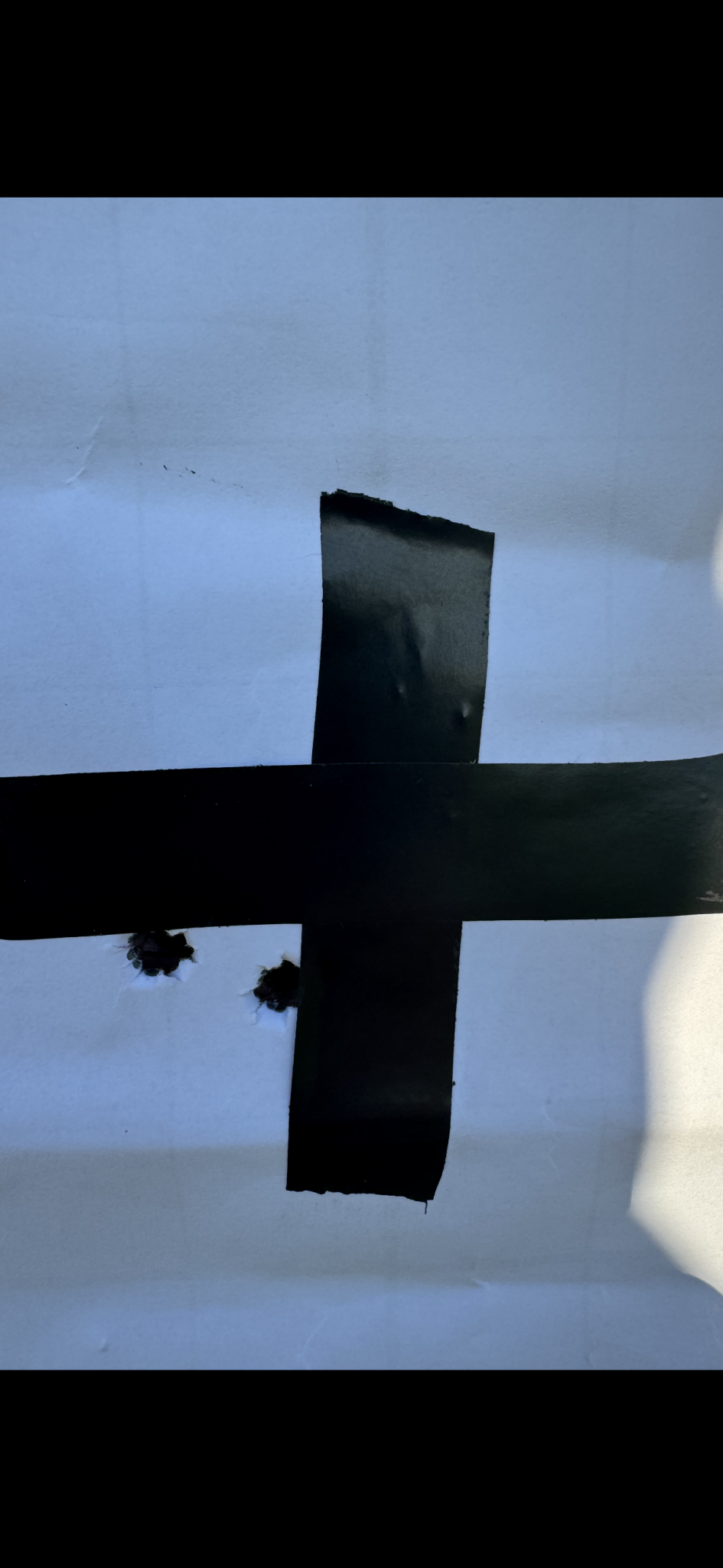

I took a 20 inch RTR 22ARC and a 22inch 6ARC RTR barrel for first rounds last night. Just sighting in my Thermal and to see how they shoot. Shooting factory 75 Eld in the 22 ARC and the 103 ELDX in the 6 ARC. Very happy with the accuracy and gas system. With only a few rounds through them they are very accurate. What a nice feeling. Great job by Craddock precision! Thanks Paul

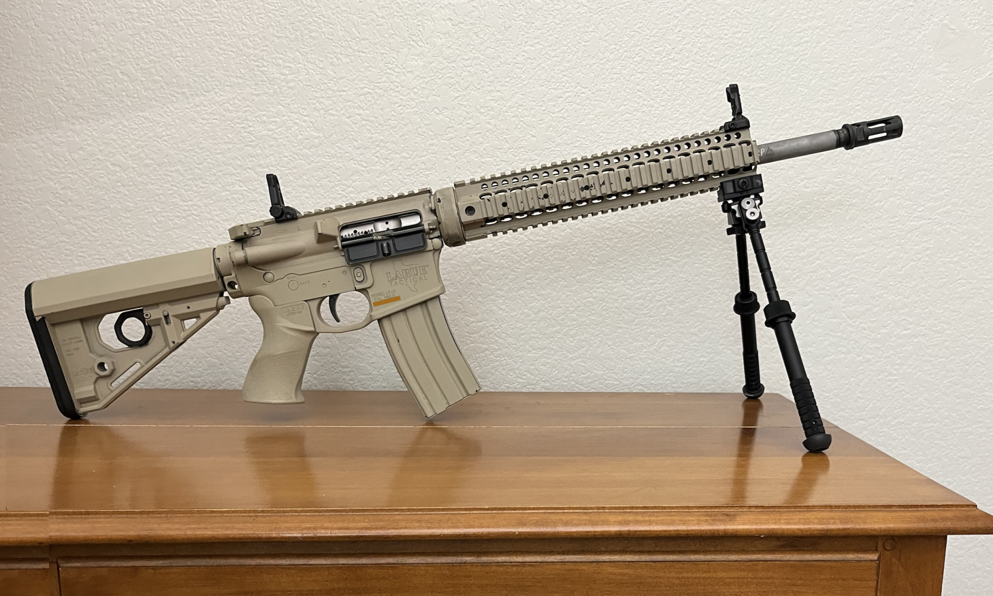

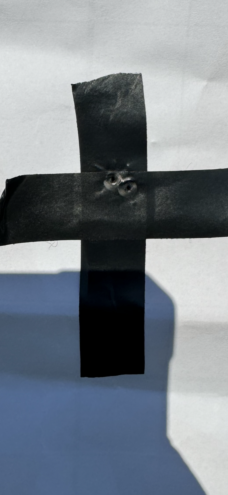

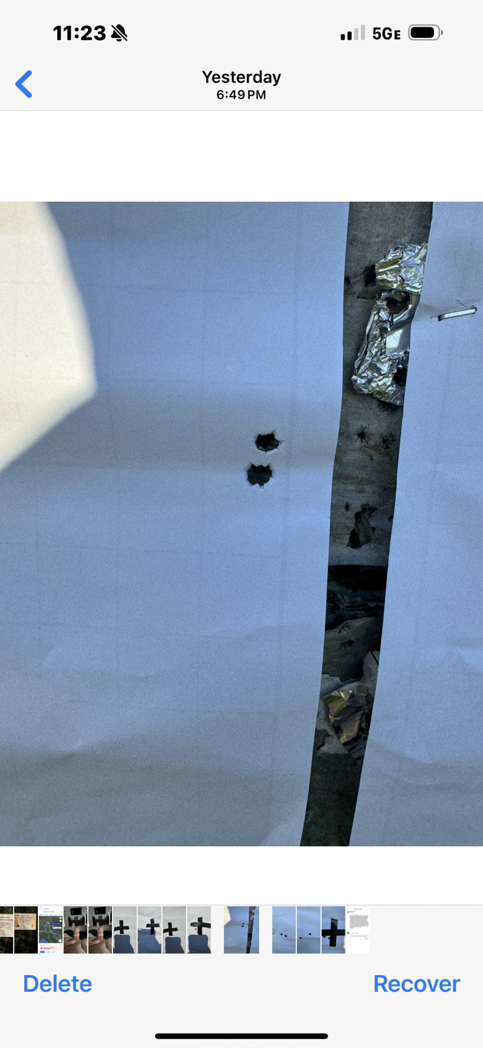

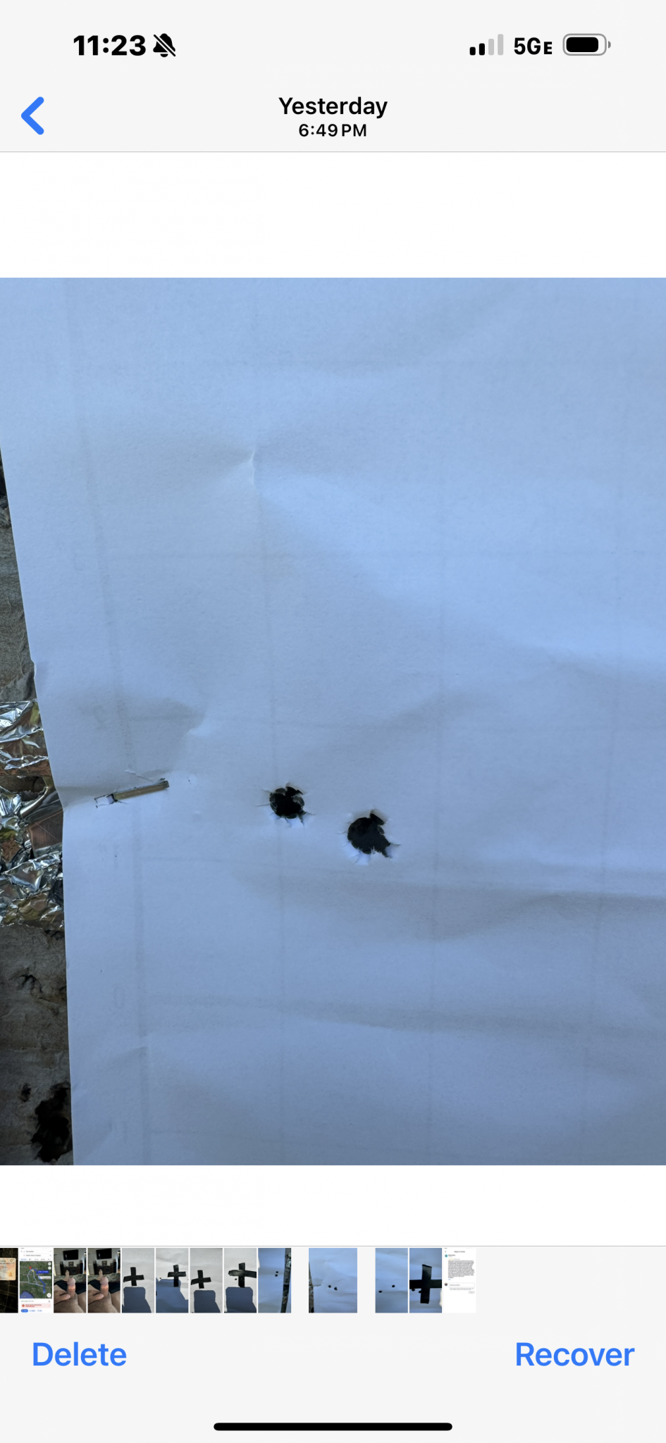

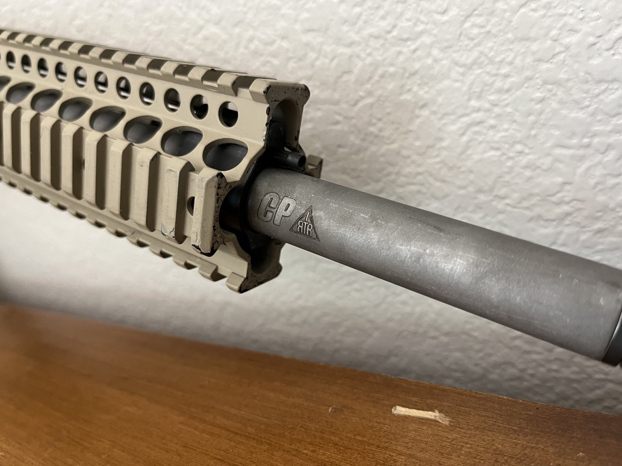

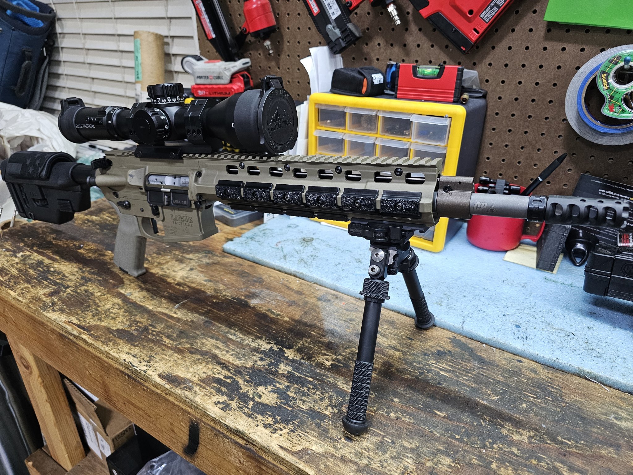

Got my 16” RTR barrel from Craddock (223 Wylde with the intermediate gas length) and just got it all put together. Eager to shoot it.
