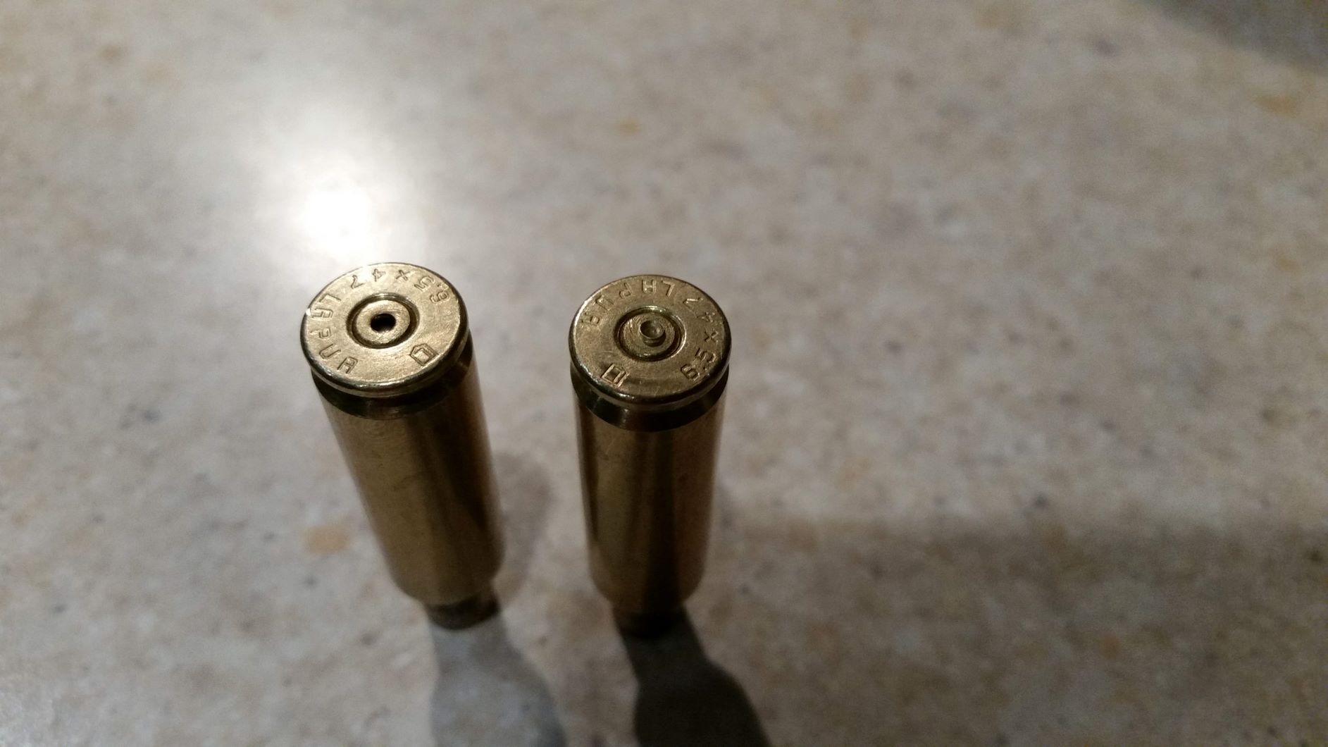

    Here's what I'm getting.
    That's on the more extreme end of the spectrum. Some are way less amd not at all.

    Can it be a worn firing pin or worn breechblock? Cratering is usually 1) Over pressure or 2) A loose fit between the firing pin and the opening in the breechface. If it's the second case then your factory rounds should show some cratering as well, if they don't then I would guess over pressure.
    Make sure you have adequate bullet release. If a bullet will drop into a fired case you are good.
    Make sure your chamber is dry and free solvents, oils and other contaminates also.
    If all checks out. CCI 450 or BR4. The brass shown doesn't appear overpressure. Primers still look round to me.
    I am inclined to think pressure, based on the sharp primer edges in evidence in the pictures.
    My suspicion is that there's some sort of a pressure ring built up in the throat/near end of the bore, contributing to a pressure spike.
    Perhaps a vigorous cleaning process in the chamber end of the bore? Verify that the bullet isn't jamming in the rifling, too.

    Another possibility is residual case lube on the cases in conjunction with a shoulder that has been pushed back a bit too far. This would allow the case to move forward under firing pin impact, and then slam back against the bolt face upon ignition. This happening would expose a firing pin being on the hairy edge of too long, and would pierce primers and cause cratering.
    Just a thought...
