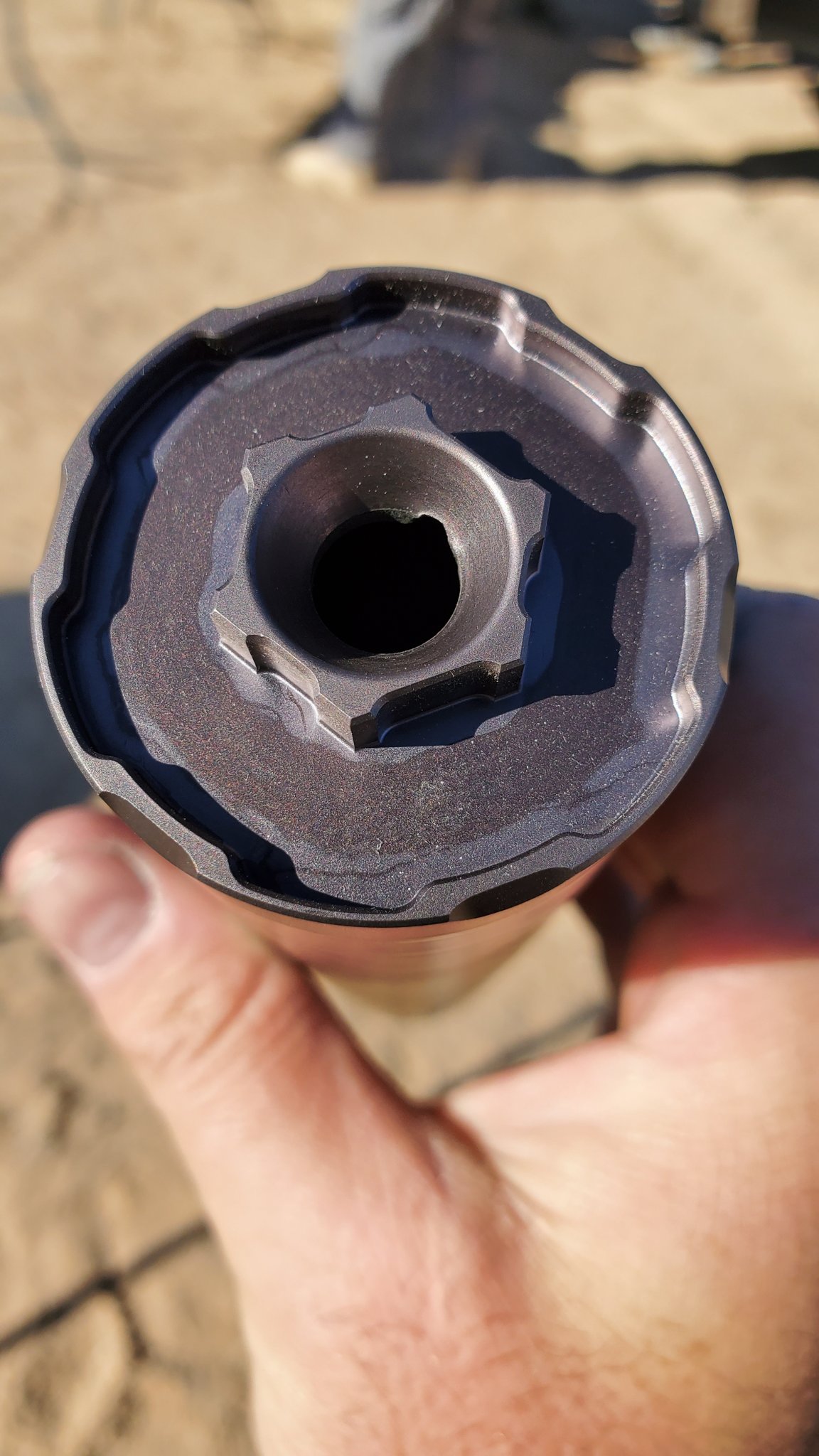

Would something like this effect the accuracy ? For some reason this first round out of a factory box sounded weird and once I started investigating I noticed the end of my can got nicked

Ummm........"Crazy factory round" ? What makes you certain enough to be able to conclusively say it was a factory round at fault ? I have a hard time embracing the idea that your end cap strike was due to the round itself. Further, I'm having a hard time with the idea that even if the bullet were loaded crooked into the case, that it wouldn't get straightened out when traveling down the barrel.
Try the simple things first. Was the can on securely ? Who threaded your muzzle/is it concentric with the bore ? Do you have a muzzle brake/flashider with a QD device ? Was it secure ? Have you fired subsequent rounds ? Any more strikes ? There's a lot of important supporting information that you haven't provided.
So yeah it has a muzzle device that holds it on, yes it was tight.... shot a 10 round string and no others hit the can, also it sounded and felt way different the every other bullet so that's why I figured it was something weird with that bullet... I'm no pro but the muzzle device is torqued and rock sett so no clue
Likely won't affect precision, but I'd investigate the cause further.
Make the weapon safe. Set a light shining down the breech end. Look down the muzzle end with the can on. Align your eye with the center of the barrel bore and visually check that the barrel bore center is in the center of the end cap. I have seen mounts installed crooked enough to cause end cap strikes and every time it was quite obvious using this test. No alignment rod or anything fancy needed.
If the alignment doesn't look perfect on the visual check you should investigate further by contacting the manufacturers involved. The mounting method should not use a crush washer. The barrel threads should be checked for concentricity. The mount could be bad. I have seen a mount that was the cause of an end cap strike.

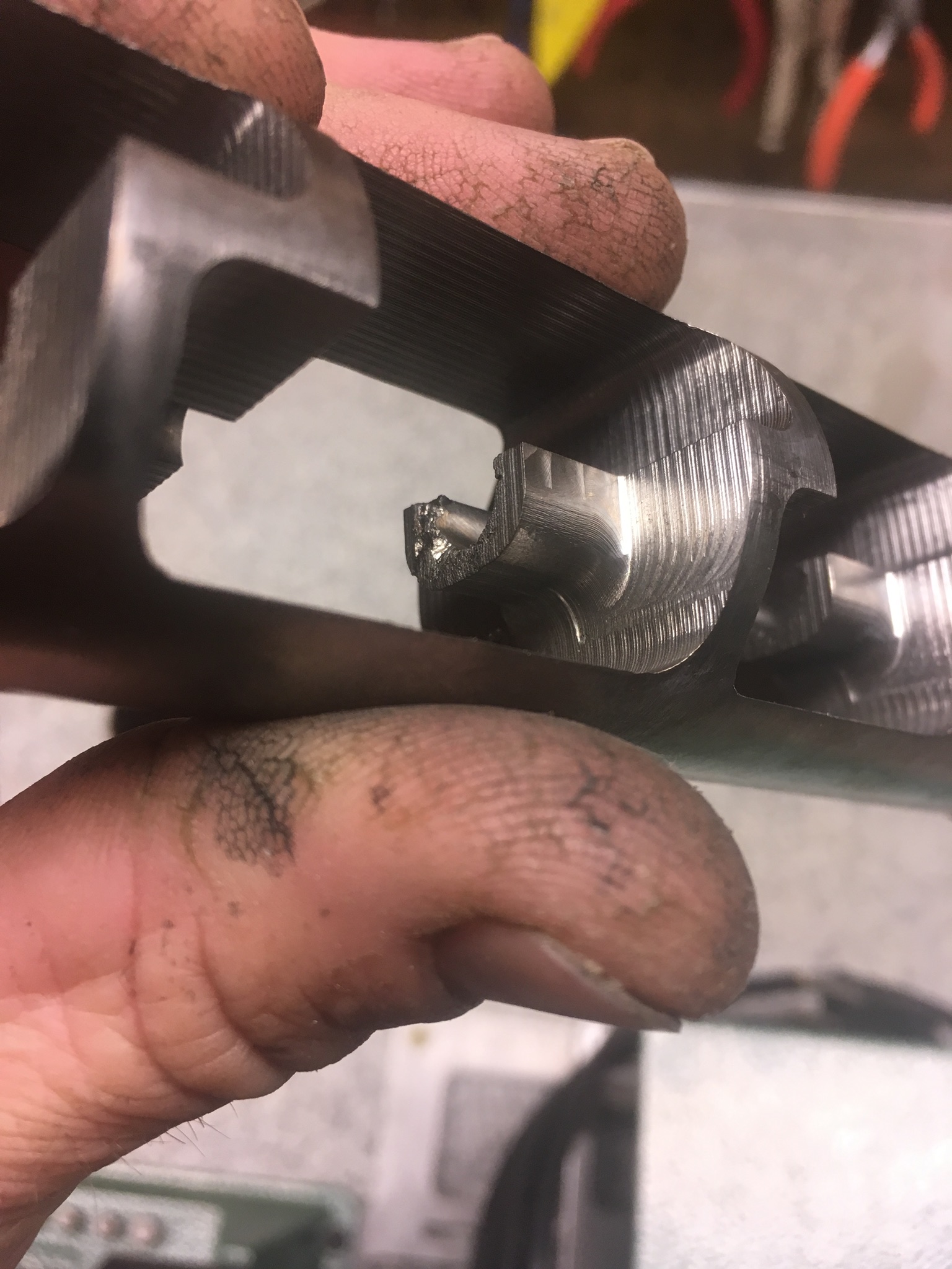

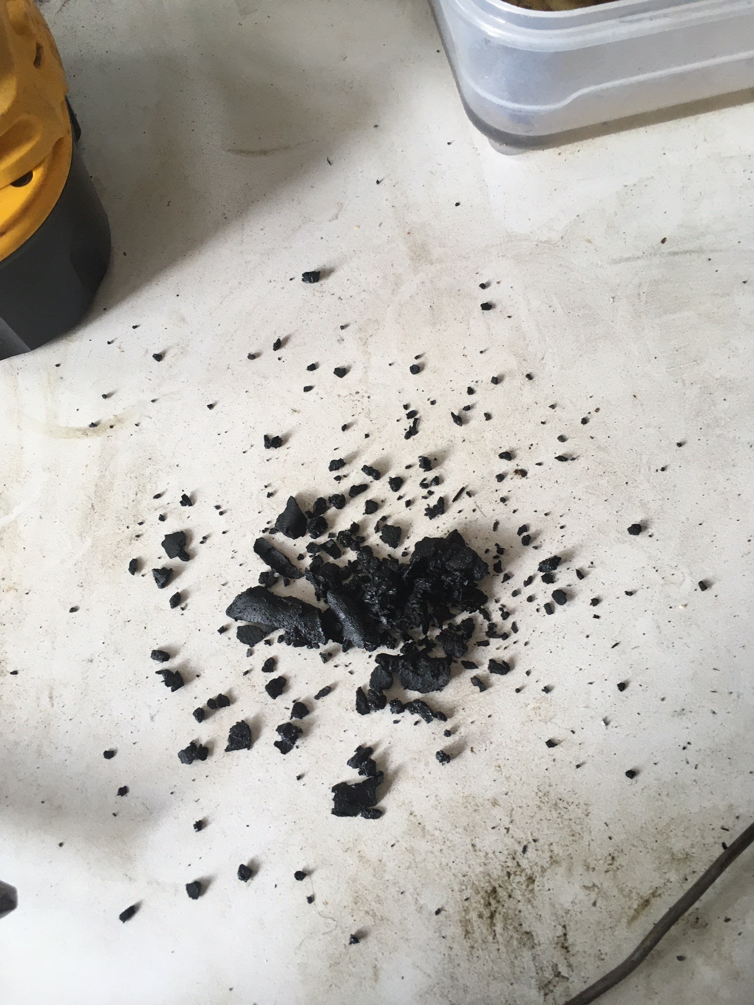

Your suppressor could have a lot of carbon build up and a chunk fell in the bullet path. I was using H4350 in a 22” 6mm creedmoor And it wasn’t burning clean at all in the shorter barrel. Worked fine in 26” but not 22”. It literally had huge chunks of carbon fell out when I took it apart and I noticed a couple nicks in baffles. It started to fall down my barrel and plug chamber when I was carrying it on a sling coyote hunting. Talk about piss you off on a stand and can’t close your bolt.
I thought that but .. it literally has 25 rounds through it .... got it 4 days earlier lol
