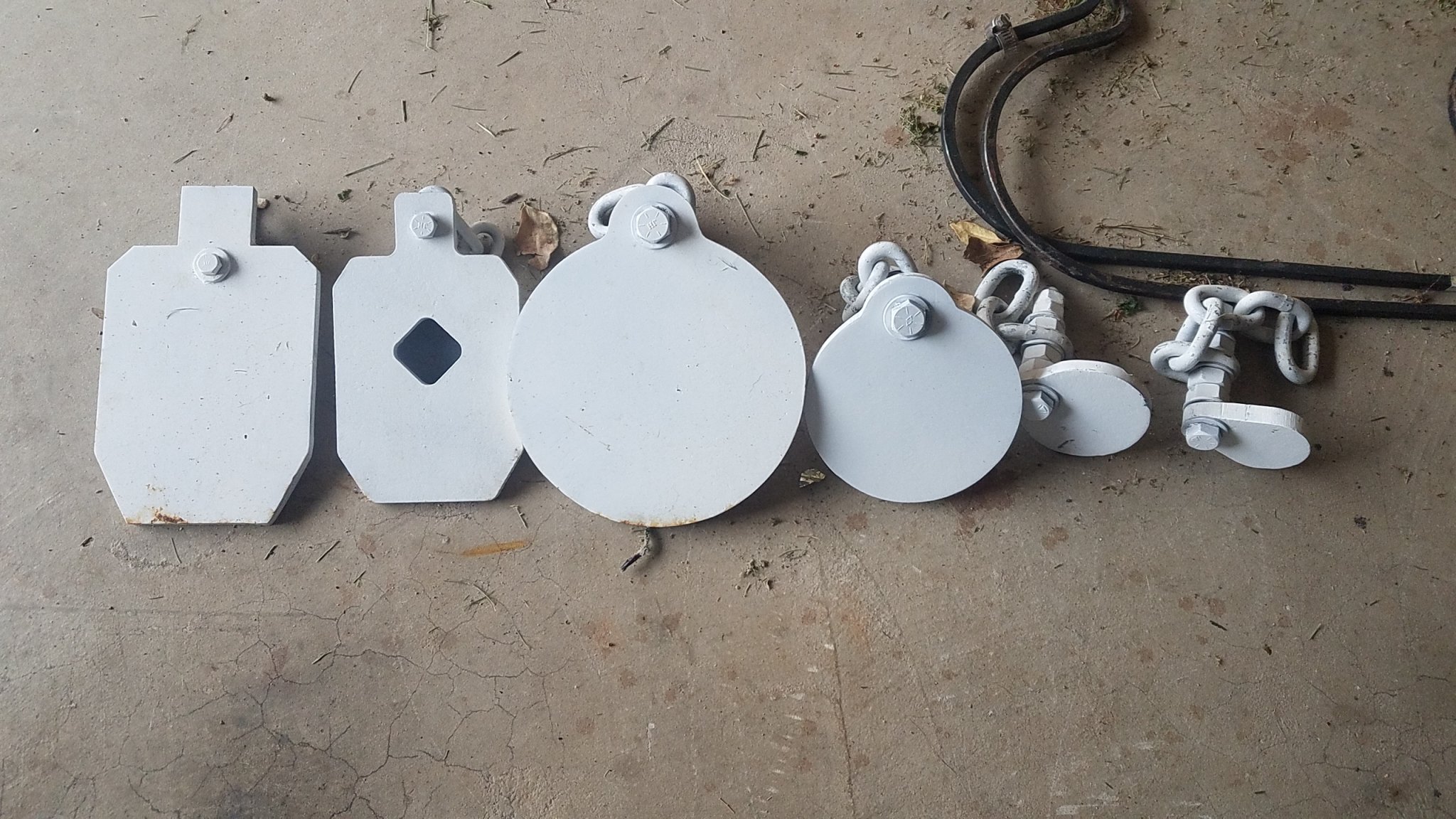

Cool I even have some of those Sheppards hooks sitting around I picked up at a garage sale years ago. Home Depot is 2 hours away so I will see where I can get some more. When hanging big steel at the NRL i helped set up it was easy to see how to angle and keep the steel facing the shooting line. With the tiny ones how do you angle it and keep it facing a particular direction? My 2" targets have 2 holes and the 1 and 3 inches are single holes.
Mine have a single hole, but the same concept should work for duals. Used grade 8 hardware from Tractor Supply (cheap yellow coated stuff, nothing high quality). Probably 3" or 4" bolt to offset the chain causing the downward angle, place the chain on the hook, adjust left-right angle as needed and pound hook into the ground. Takes less than 1 minute for the target to stop moving. Not the best pic but hopefully enough to give a better description

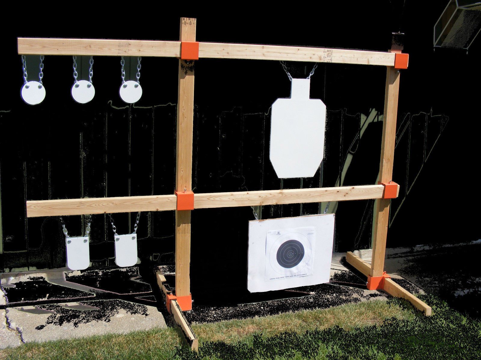

loved the look of these as well as the ease to change it up as needed it slides together pretty easily on site . good luck with what ever you decide to use send pics of what you come up with . Also shepard hooks seem to work real nice with single steel targets especially the off set ones .

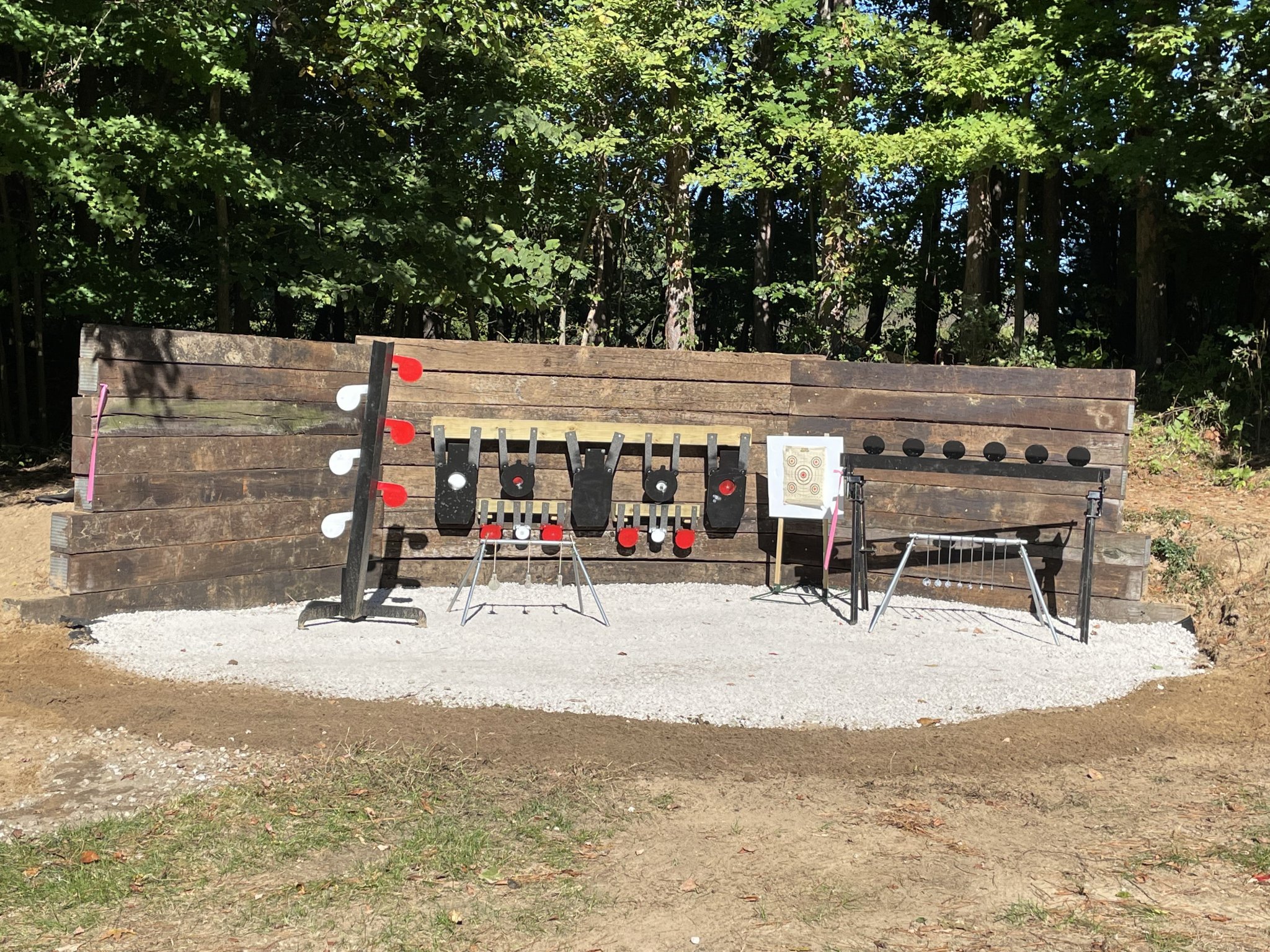

I have a couple KYL targets from Shootingtargets.com. They are awesome.
