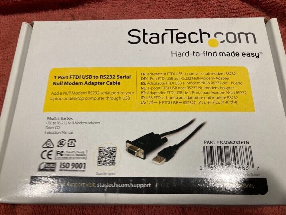

So like a lot of us, we can be a little impatient at times. I did some more online searching and it seems null modem cables seem to be the norm. So I was able to find one with a reasonable price and driver CD is included. The one I choose was from Startech - ICUSB232FTN. It also has integrated FTDI USB UART Chip.
Web site lists these at $45 but was able to find one on eBay for $18 all in. Once it arrives I'll give it a try and report back with results. If you have experience with this or similar product please let me know your results.
Update: So the cable came in today and there is only one problem. The problem is that the cable has a female connector and the back of the scale also has a female connector. :(
Back to shopping but this time for a cable with the right connector.

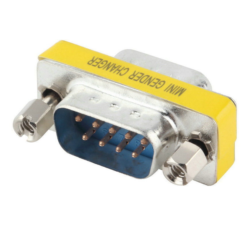

UPDATE: Found a male to male adapter for $4.00, inbound. :)
So first adapter arrived but was damaged in shipping. Simply placed in small padded envelope and routing or sorting machine crunched it. A replacement was sent but arrived in one piece even though it was shipped in the same envelope. Still couldn't get scale to transfer data to my spreadsheet after setting it to "Auto" and loading 232 Key on the laptop.

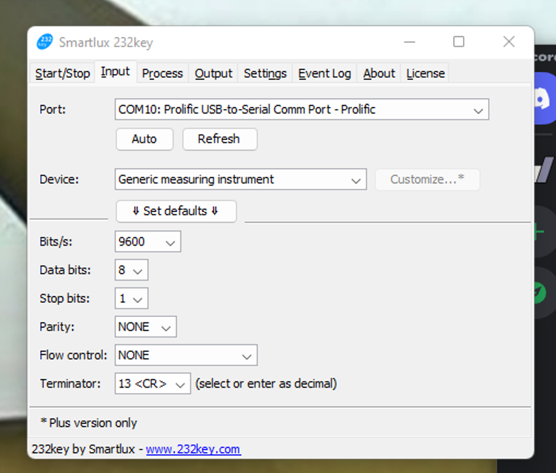

Once the update has been applied, reopen 232Key. Here are the settings I have used.

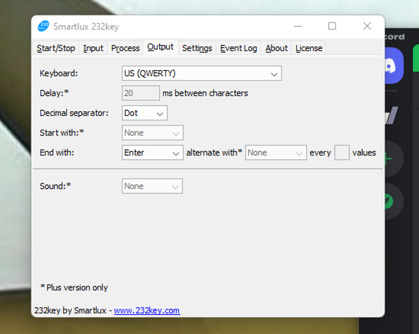

Then you will need to go to the Output settings and change the “End With:” to Enter
Otherwise the output will continually output to the same cell in Excel. As a default, the scale will automatically transmit data when the reading is stable.

So, cable arrived in the mail today. Instructions with the cable were simple and straight forward. Insert their disc, navigate to my OS, double click on setup and follow on-screen instructions. A couple minutes later it was ready. I went into my reloading room, plugged the cable into the scale, plugged in cable to laptop (red LED in printer connection lit up), launched 232Key and started my spreadsheet. The scale had already been set to "Auto" and I already configured 232Key to the setting outlined in the above e-mail. I grabbed a few 300 BO cases that were laying nearby and bingo!

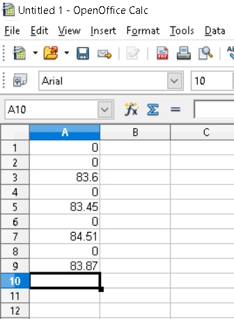

Here is the data log from 232Key:
What a difference having the right parts and proper instructions make. :) Just as a side note, I didn't buy the same length cable but instead ordered a 10 footer for more flexibility. The only downside to using the free version of 232Key is manually deleting the rows with "0". In the paid version I understand that you can set it to simply not populate those values.
