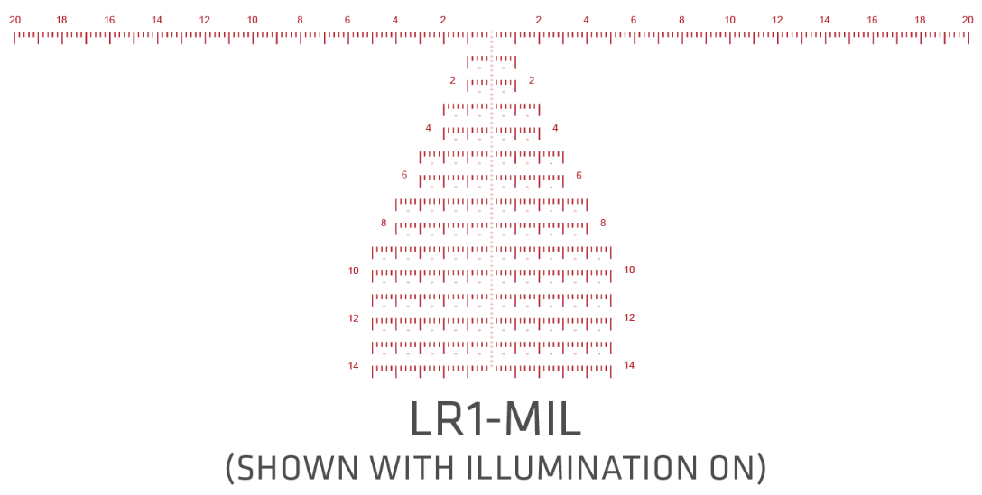

    A 3-24x56 and a 4-20x50 in the lineup, be still my heart! Looks like possibly another OEM with LOW??? Either way, Crimson is a good company. Low profile turrets, decent weight for the size, fairly short, 10y parallax, but that reticle... I am not sure I like that at all, looks very busy, almost Horus like, and where is the center dot/cross, it almost looks like the center is a small horizontal line??? but will have to wait and see how it looks through the scope. They have a 2-Series, 3-Series and 5-Series which appear to identify different levels of quality

    Reticle is too busy for me.... I actually looked at a Lucid just because the reticle was bare with a open center... I almost like it... almost. Not necessarily the scope just the reticle. I love my Kahles, vortex, Steiner etc. I just keep thinking about a uncluttered simple open center .

    that reticle is really strange and I cannot fathom why they wouldn't offer their more traditional MR1 reticle on what I"m assuming is their flagship 3-24 offering.

    Alright, this scope wasn't selling in the classifieds so I thought I'd mount it up and give it a run last weekend on the .223 trainer. I'll say that it's better than the Nikon FX1000 that I tested last year. Is it a $1800 scope, not for me, but I'd say it's more in the $1200 range. The reticle is a good size for the magnification and simple/effective. The turrets have a little play in them, but it tracks solid and the clicks positively engage. The 10yd focus makes this a really solid 22 scope in my opinion.

    Got an email from Midway today. They are selling the 5 series 3-24x56 for 899 and there is a $100 rebate until 4/30. Was thinking about getting one to replace the ATACR on my 22. Not sure I like the center aiming point or how cluttered the reticle is. Seems like a decent value at 799.
