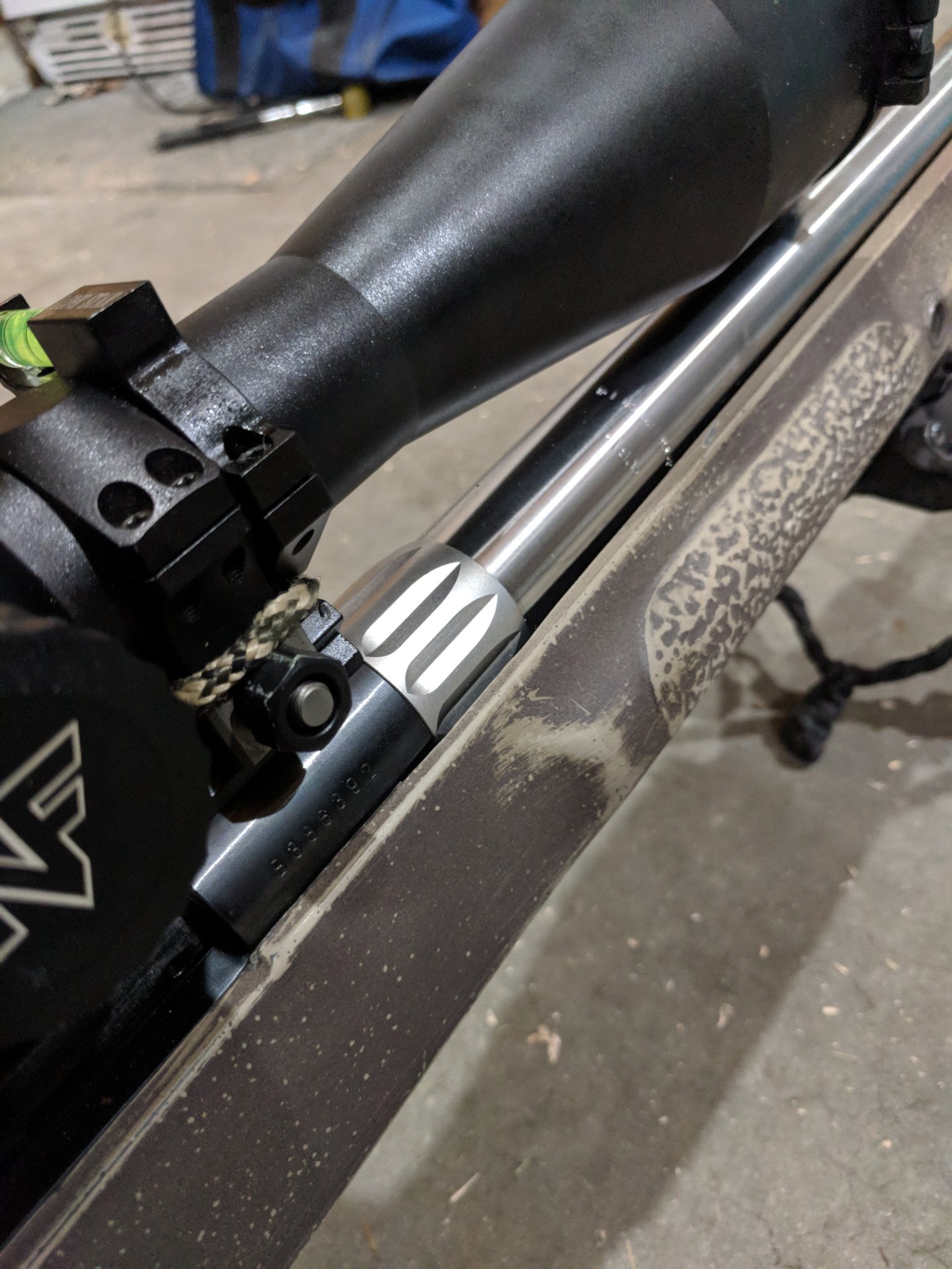

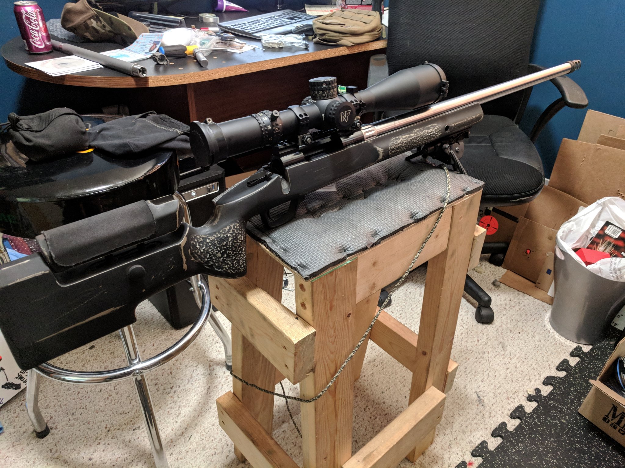

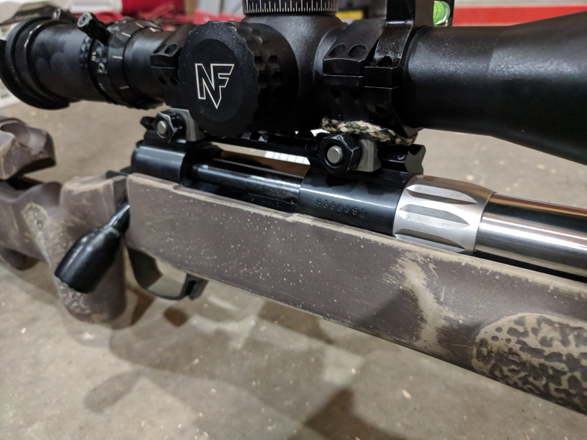

Thought I'd post some pics of the new Criterion Howa Prefit barrel with the Big Horn barrel nut for those that are interested. Went with a 26" 8T Straight taper .900 muzzle diameter. Did the swap last night and, other than breaking the factory tube off the action, install was super easy.
Chamber and barrel look great and are hand lapped lapped from factory. Barrel was $360 muzzle threading was $100 and barrel nut was $40. I'll post review after shooting a bit today and tomorrow. Great upgrade for a factory Howa rig. Nut will require a fair amount of of inletting (carefully) to ensure free float around the nut and some aluminum chassis systems may not have clearance without removal of metal just forward of action. Nut is 31mm in diameter (1.221") so an inlet of 1.250" should provide plenty of clearance. My stock barrel channel was inletted for factory #6 barrel ~.800 IIRC, so had to remove a fair amount of material to keep barrel free floated.
I also found the most difficult part of my installation of the same barrel to be removing the original. I think you’ll like how it shoots.

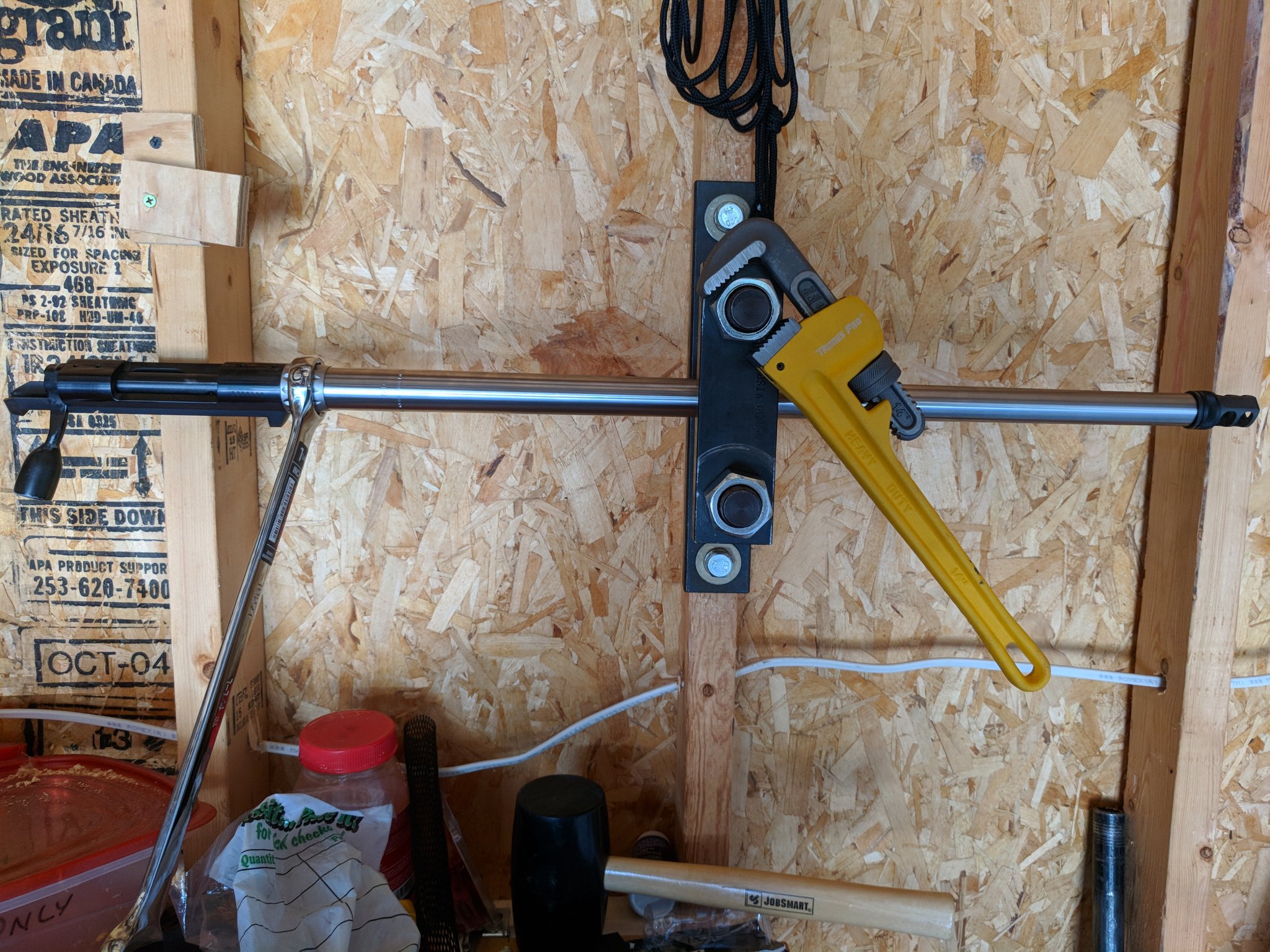

Yep... Couldn't get barrel vice tight enough so I used the barrel vice flat bottom as an action wrench instead and mounted flat to flat in vice with bushing on top of action for support. ...then I used a pipe wrench on the factory barrel..?. Felt like I was putting down an old dog... Almost sad.
Putting new barrel on was easy though...

I just had to remove a Tikka CTR barrel, and like you, said "f*ck the heartache" and chucked it up in a lathe and cut the thing off (actually, I made a relief cut just ahead of the receiver). Felt bad cutting up a perfectly good .260 barrel...
As to the action wrench, I too, also have varying lengths of bolts specifically because of this (like using a V notched Mauser wrench with the one end flipped around to give me a two sided, parallel, action wrench for Tikkas, old Martini's and Lever guns). Fortune favors the prepared...

Damn. Now I get it... I ordered a Mauser style wrench (v notch top with flat bottom) but if I had gone with a standard R700, I could have flipped the top half 180 to use it as the flat. The pictures of the wrench didnt make that as apparent as it is now with one in hand.
And as for the bolts being too short, I'm surprised any action would fit in that wrench the supplied bolts. They are reealllllyyy short and seems like it would be difficult to get any good thread engagement on a normal sized action (~1.2-1.3" OD).

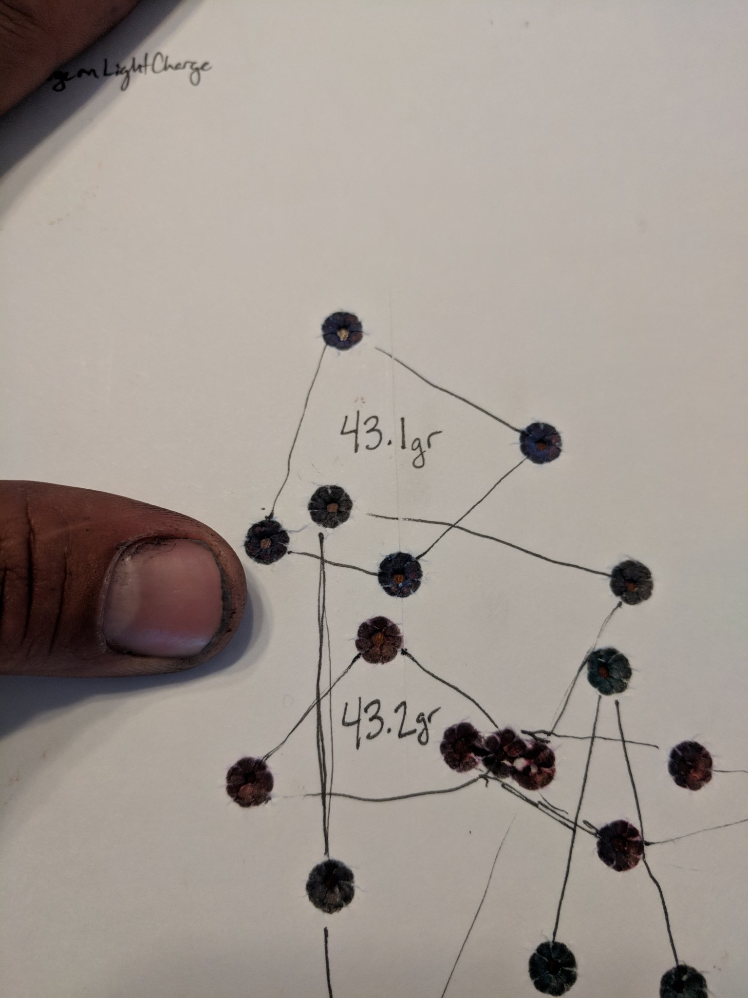

Quick update on load development. Have only tested Berger 140 VLD Hunt so far (have a lot and like them lying around and shot very well in last barrel). Shot an OCW at 300 yds from 42-43gr and found nodes at 42 and 43 ( same nodes in last barrel):
Tested 42, 42.1, 43, 43.1 and 43.2. results below from ladder test at 388yds. 43.1-43.2 has great node staying sub 1/2 MOA at nearly 400 from field position and same avg velocity for both charges of 2825 avg with 10 SD. Will be testing a few other bullets to see how it shoots with non-VLD, tangent ogives ( like ELDM and Scenar).

Concerning assembly, I found it it is possible to misalign a barrel during installation. My original inlet was perfect. Then I disassembled and check headspace but when reinstalling, had the barrel hanging in space (unsupported except by action) and the nut torqued into place leaving the barrel well left of center. Long story short, thought I'd bent barrel or action but after another teardown, it came right back to center.

Here are some groups from development.
These are groups from the 388yd line.

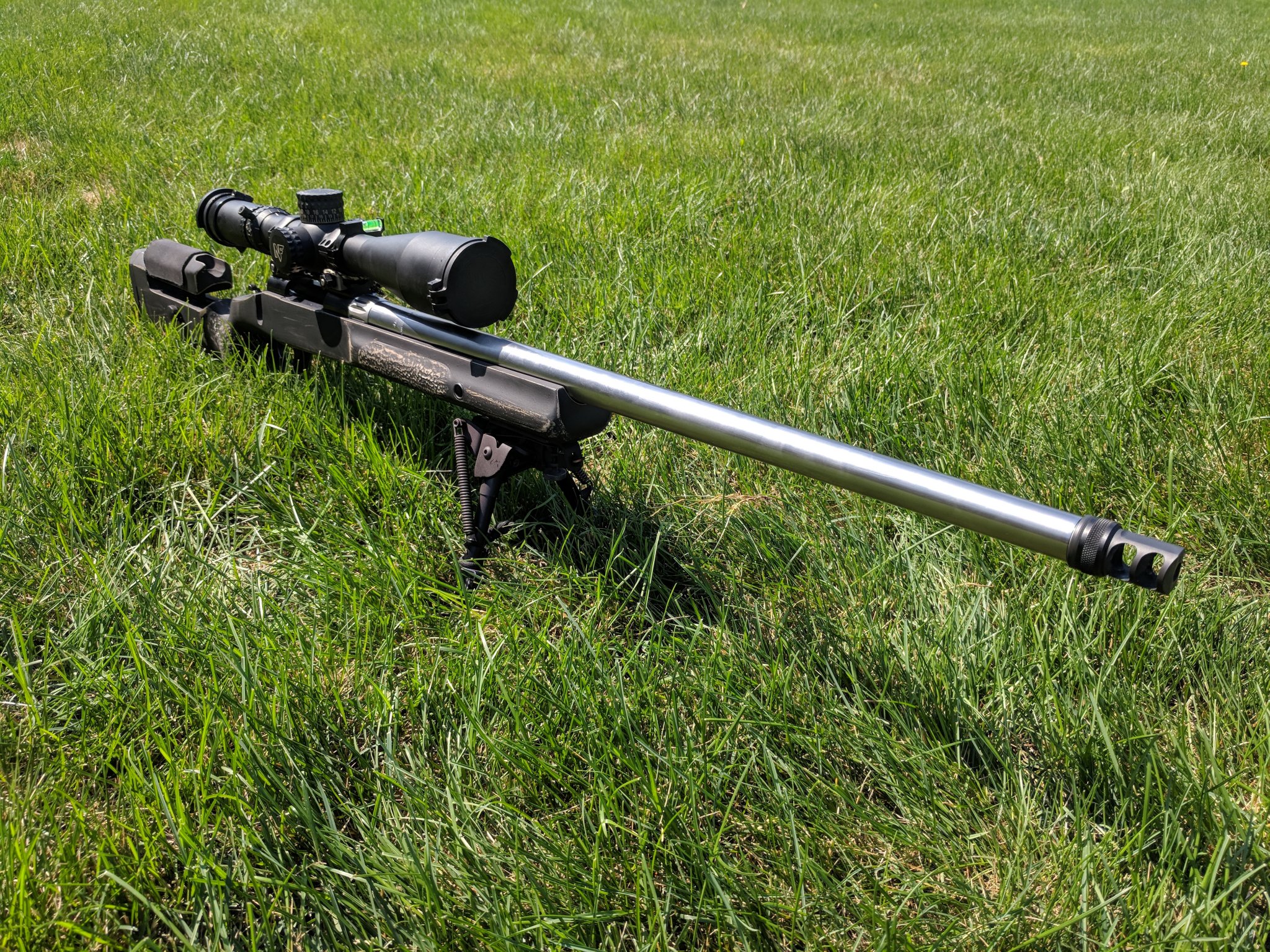

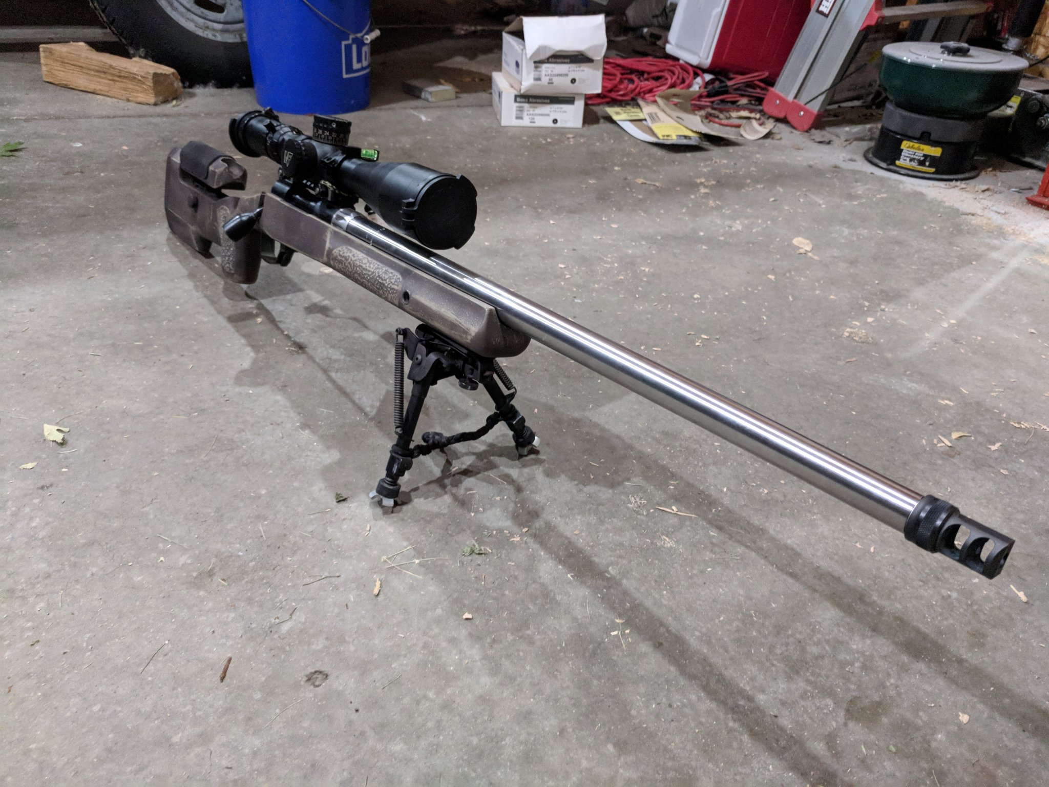

Good review, good-looking rifle! I like the finish on the stock... Krylon? Whatever it is, it’s sexy
Thanks. It's a Manners T4A which has the original Coyote/FDE paint/duracoat. Then I put Krylon (black) over top and lightly scuffed areas to give it the worn look. It's easy to remove so if I ever get tired of color, simply remove with acetone or brake cleaner.
Wasn't sure what color I wanted barrel/action/stock cerakoted so I thought I'd start bare and see how it shoots then layout color as needed.
Yeah she’s pretty, I’ve done the same thing to different stocks... i think it looks better than molded in camo from the factory, if it’s done right..
