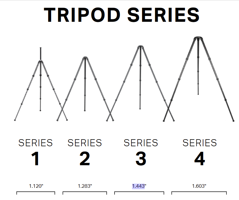

    @lowlight - Frank, thanks for the reply 👍 And my 2Vets is indeed 36mm and 3 sections. Be interesting to line it up against a real RRS SOAR and see any differences in stability.
    And, after posting I actually found where RRS SOAR has a pdf of their printed catalog (well, dunno if they actually print it) online and it had the below graphic.
    The leg dimensions correspond to:
    Series 1 at 1.120" = 28.4mm
    Series 2 at 1.283" = 32.6mm
    Series 3 at 1.443 = 36.6
    Series 4 at 1.603 = 40.7mm
    @Baron23
    The brands really have more to do with weight when you consider the same series. money too
    But what you get with more money is less weight overall, the Two Vets is great, it's just heavier to carry than an RRS, same with the knock offs
    You have all the information, it's up to you to decide, but when you start, look at the weight difference as well as the money
