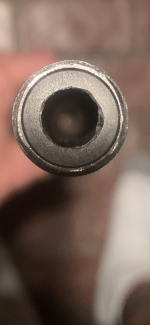

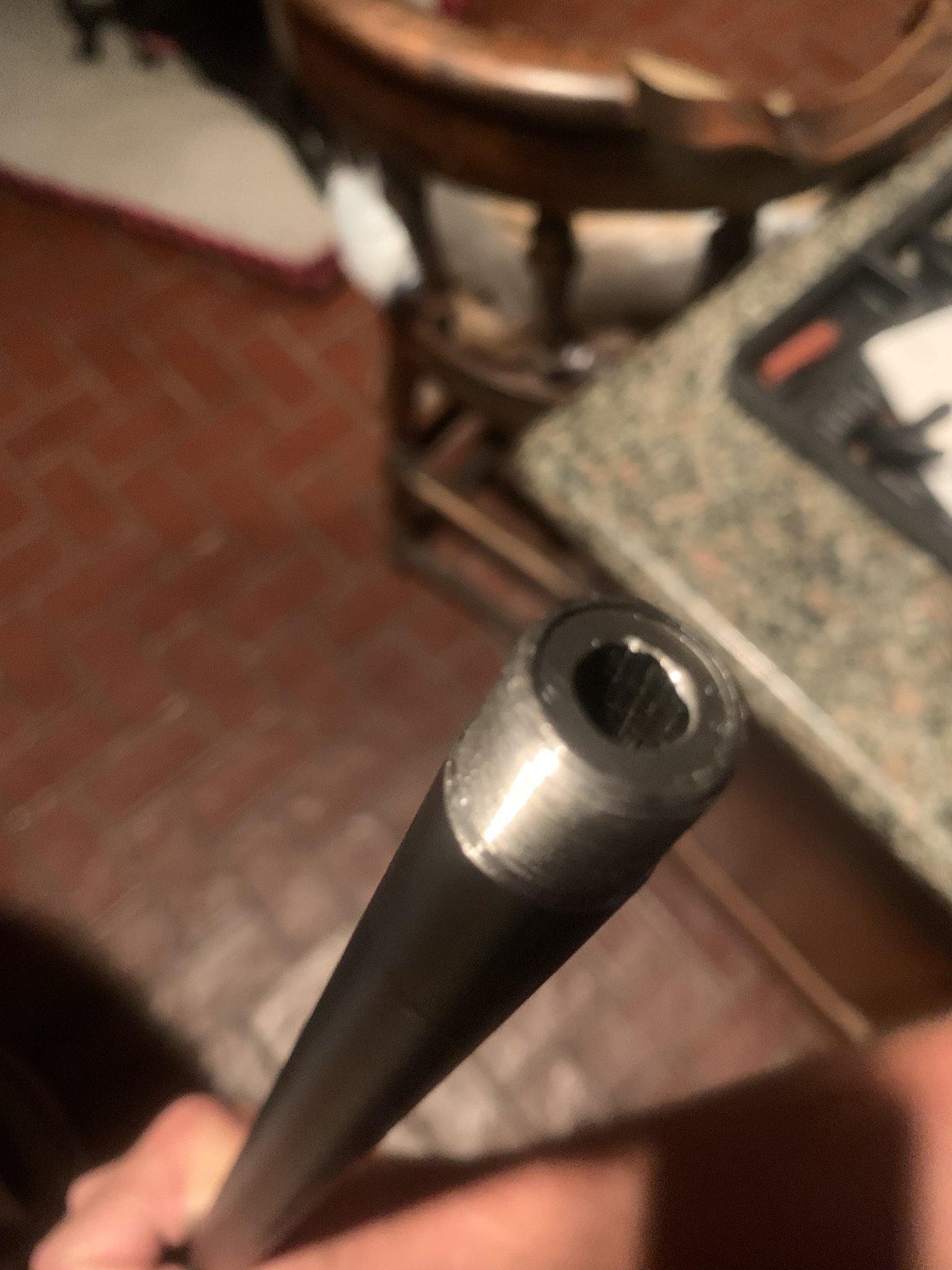

Hey y'all this is my first post unfortunately. I was about to mount a Razor Gen II 3-18 I just bought off of @xxflyingturtlexx (great condition and nice packaging btw no issue there), on a bergara b14 hunter .300wm that I had the barrel threaded by someone in MS who seems to be a wannabe gunsmith. I am attaching pics to show the damage caused to my crown. I ran a qtip inside the barrel and the burred edges were so sharp it cut the qtip in half! Glad I didn't start shooting...
Unfortunately the man would not back up his work so I am going to take it to someone who is competent. Let this be a warning to those are considering taking their property to an unknown smith. I learned my lesson the hard way..

Crowning a barrel takes a 15 seconds if you've already indicated everything and have just threaded the muzzle. It makes no sense why that wouldn't have been done.
When I first started crowning I ran a 45 degree pilot reamer in the muzzle to chamfer. I quit doing that since it was just another operation. It shot no different than a perfectly flat crown. When I first saw the pics I thought that's what was done but, nope, that wasn't it.

Definitely would have rather had your 45 degree chamfer. I bet it was symmetrical and concentric anyway

Pics are blurry for me. Is that threaded? End cap on there?
Doesn't look like enough shoulder for a suppressor either.

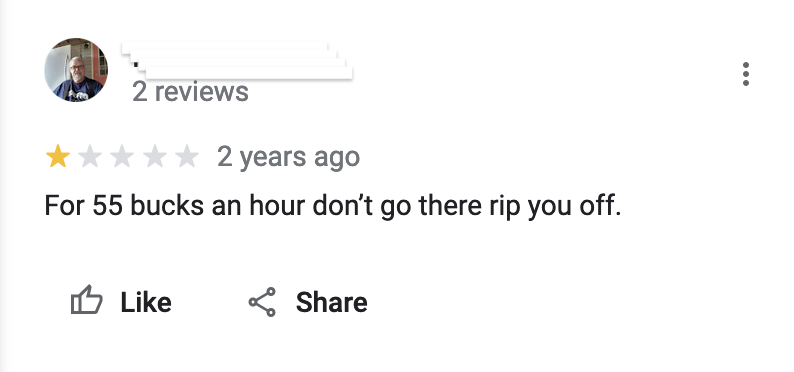

If he really did that & is telling you to pound sand, I'd add that picture to his Google Maps page.
I have no idea what MS rates are for gunsmiths... but the shop rates of the people I'm using are more than 2x this guy. Sometimes, you get what you pay for.

$55 an hour to look like you stuck the muzzle in a pencil sharpener
Yeah the counter argument is this is such an easy thing to do, even someone charging $55/hr should be able to get this right
edit
well, looks like $55/hr isn't atypical. Guess I'm overpaying :ROFLMAO:

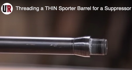

This is one solution for threading a thin barrel. When I'm ready to thread that thin barrel of mine I'll be trying to find someone who can do this.
