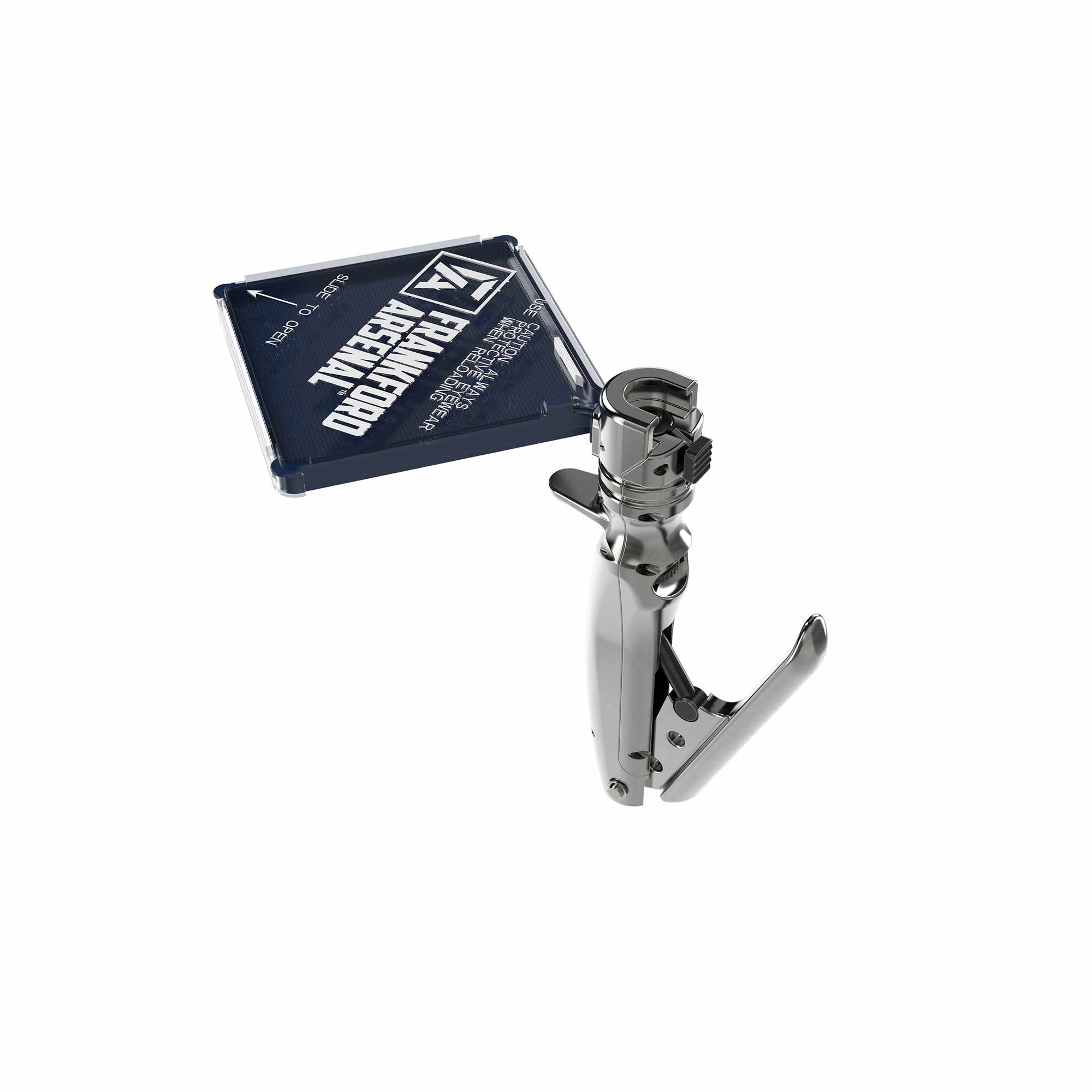

I've tried a good amount of them and find something I hate about all of them. I did kinda like the Frankford arsenal one but the ergonomics were off for my style so it was a bit slow for me. I'm currently using the Lyman one but constantly have to repair and modify it. I do high volumes though so I need something that I can keep moving fast. I have 3 total of the Lyman ones and the last one I bought wouldn't set the primer deep enough so that one got cannibalized.

I had the K&M hand primer with the depth gauge, it was super slow and finicky to use. Got the Frankford Arsenal one and it's way better. And it's cheaper.
