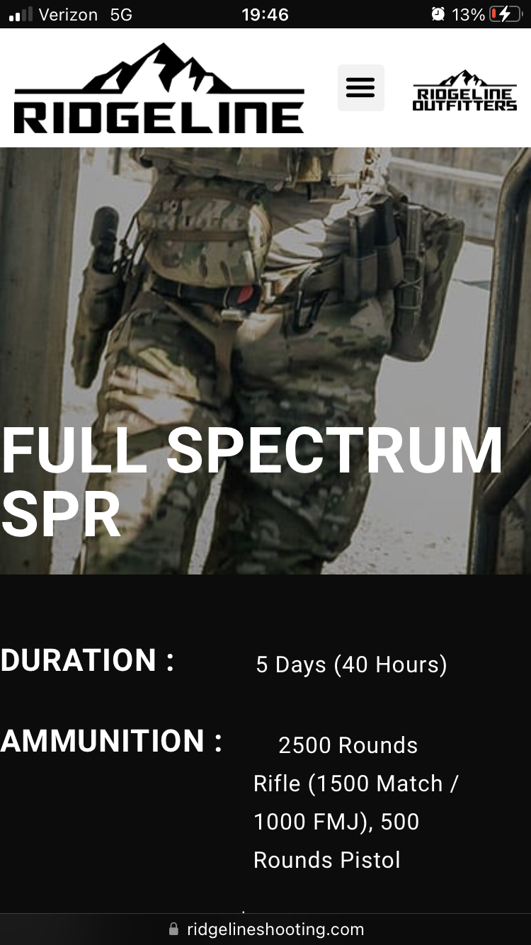

    What kind of precision rifle class is blowing through 1-1.5K rounds in a week. That is absolutley nuts. Most precision rifle rounds like the ARC, 6mm BR class ect should be cleaned about every 3-400, depending on powder. A gas gun is going to need it even more frequently. So if guys are going 400+ without cleaning, they are fucking retarded, and whoever is instructing them, is failing them. If you are using TAC or other dirty ass powder, even sooner.
    Wrong.
    A gas gun should be able to run at least 300 or 400 rounds without choking it’s self to death.
    Welcome to the future, we’re run gas guns hard and fast and far, this is the next generation of the American rifleman. 😉
    Wrong.
    Bullshit. Do the same with a 6.5creed or .308 gasser running dirty ass ammo with no maintenance and you will see the same issues, especially with dirty ass powder like alot of the 6mm factory ammo is using. Add a can on there and its even worse. Running essentially a large for frame caliber like the 6 arc or 6.5G is going to stress it that much more. Its just the nature of physics. You are running alot more heat and gas volume through the same gas port, block, tube and carrier key than a 5.56 full pressure round. We dont have 50 years of perfecting every aspect of every component to run 5.56 optimally for a long time without cleaning (but lubed) with the newer rounds. The platform was not designed for them.
    5.56 is a different animal. You also aren't retaining the kind of accuracy needed to hit moa targets at long range with a dirty ass gun that has';t been cleaned in forever, especially with the quality cut rifle barrels we run.
    500 rounds of precision rifle shooting per day, plus pistol without cleaning, is absolutely fucking retardation. Most of the guys reading this who actually shoot precision rifle, including gas guns in the military, LE and in comps, are thinking the same thing. I have taken classes from the top Tier 1 instructors in the USA(Vickers, Rogers, Mac, Pantone, Hackthorn), and we barely shot that in carbine/cqb classes/pistol per day. With a precision rifle its even less shooting and more learning/dry firing.
    Lets see $1200 for the course. Assuming you are shooting 6 ARC, another $3,000+ in ammo. Add in travel and Logging and M&IE you are around $5K for a week long course. A course assuming there is zero classroom time, instruction time, has you shooting over a round a minute for 40 hours. Oh and that doesn't include pistol instruction/shooting. Or lunch. Or piss/shit breaks. Or snacks.
    I get it, You are an SF sniper and have taken some courses and been around the block. 19th or 20th group I would assume based on location.
    I am really really really trying hard not to laugh. Then again maybe it is a new generation and I have no idea what I'm talking about.

    500 rounds of precision rifle shooting per day, plus pistol without cleaning, is absolutely fucking retardation. Most of the guys reading this who actually shoot precision rifle, including gas guns in the military, LE and in comps, are thinking the same thing. I have taken classes from the top Tier 1 instructors in the USA(Vickers, Rogers, Mac, Pantone, Hackthorn), and we barey shot that in carbine/cqb classes/pistol per day. With a precision rifle its even less shooting and more learning/dry firing. Then again any swinging dingus with a little bit of money can start up training school and teach other dumb shits the wrong way to do things.
    Lets see $1200 for the course. Asuming you are shooting 6 ARC, another $3,000+ in ammo. Add in travel and Logging and M&IE you are around $5K for a week long course. A course assuming there is zero classroom time, instruction time, has you shooting over a round a minute for 40 hours. Oh and that doesn't include pistol instruction/shooting. Or lunch. Or piss/shit breaks. Or snacks.
    Ok so first off you are literally are highlighting the problem of 6ARC that I described. 🤣
    6ACR is a compromise of reliability with less than optimal feed, geometries and dirty ass power, in exchange for gains in external ballistics. I see it as something a niche cartridge but it’s got great potential.
    Also I am not sure why you think dirty guns can’t shoot (.223/5.56 in particular) I clean actions when time permits, as it’s important to inspect periodically but I’ve seen M110s run 200-300 rounds a day suppressed with rarely and issue so long they’re lubricated appropriately to start. And I haven’t cleaned a bore since 2012 other than with a bore snake. Hell the gun I won International with had 5k down the pipe, never saw a rod and jag in its life and still sub 1/2 MOA.
    Regarding round counts of the SPR course you are simply ignorant. Those round count are typically within 10-15% or so of actual expenditure.
    I mean that in the truest sense of the word not to insult you but in that you are uninformed about the particular subject of training and development of curriculum, current TTPs and employment of precision semi auto rifles in the context of martial applications.
    We’ve trained with every single one of the instructors you mentioned at some point, I spend the weekend with Pat and his wife while teaching in Florida with Jarod a while back. Point being is that I know what they’re about, I know their curriculum, they are all awesome but I’ll be directing in saying they can’t hold a candle to our course.
    It’s not because they suck, they have an an incredible amount of individual experience but they’re mostly just one man shows, teaching on someone else’s range. Now imagine if you were pulling some of the current top shooters and teachers retiring from the last 20 years of SF, Rangers, SEALs, Force …and even the Coast Guard 🙃 Imagine you gave them a couple million dollars and 700 acres of remote wilderness and said “build a training facility to support the current requirements to actually push Mil/LE. organization to their full potential without any of the bullshit…and also open it to the American man because yes that’s a dollar but more importantly that’s a rifle behind every blade of grass.”
    That’s Ridgeline, it’s not a personality it’s a collective…or maybe just a bunch of “swinging Dingus”.
    Your price point is spot on and yet we filled every precision rifle course of 2023 to 100% capacity. $5k isn’t any to sneeze at but in the larger scheme of actual personal development courses like the full spectrum SPR are priceless.

    I'd have no hesitation running one of my Custom .308 or 6.5CM in a 400 Rds a day course.
    My last competition I went through 200 rounds without needing to lubricate or do any maintenance at all and the only stoppage I had was my fault, staying up late the night before reloading ammo and I skipped a case and didn't drop any powder in it. With some quick remedial action I probably lost maybe ten seconds from those precious 2 minutes.
    After the match ended and every one got done walking the prize table giving my rifle plenty of time to cool and get good and crusty, I had a few Shooters who were either competing in gas gun, or contemplating it that wanted to test drive my rifle so that probably put at least another 40 rounds down it after the match and I still had no malfunctions.
    But to my point you don’t get it .
    Just so we’re clear, I started as a Marine in early GWOT, got tired of crayons and hop scotched my way to SF. Did some trips, I killed a bunch of dudes, won a comp or something, taught SFSC, DM, HTI, did some more trips, got burnt out, did peyote in the jungle. 21 years in I now reside at 19th, starting my second military career with a warrant packet while simultaneously plotting all the million dollar hood rat shit ideas me and the boys can conjure up.
    Now multiple that with some variation authorized by every instructor at Ridgeline a you get 100+ years of experience. We know a thing or two because we’ve seen a thing or two. (Key emphasis is on the ”We”)
